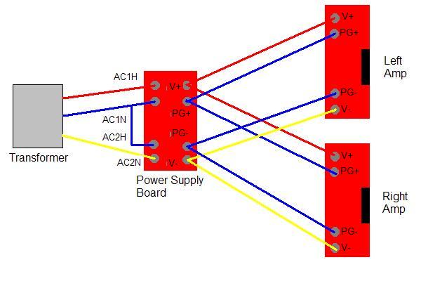

i bought a 225VA 18-0-18 toroidal transformer from a local dealer. actually i asked dual secondaries but they hasn't one and seller pointed out that center wire is actually two wires which are twisted together. he said you can easily seperate them and then you have got dual secondaries. is there any risk if i do this? i'll use it for building a gc.

well, is this the only way for wiring a center-tapped transformer?
if so, i'm a bit confused. where to go PG+ and PG- holes on the amplifier board? should i connect both PG+/- holes to the PG? or may i wire them like this? thanks.

NO! I have built several GC power supplies using center tapped transformers. Let's call the three secondary leads from the transformer AC1, CT and AC2. Let's call the four connections on the dual bridge power supply AC1H, AC1N, AC2H and AC2N.
I wire AC1 to the AC1H connection in the PS. Then wire the CT to both AC1N and AC2H. Wire the AC2 tap from the transformer to AC2N.
Doing it that way you can use a CT transformer in a dual bridge power supply. The image shows an example with the BrianGT boards.
You can wire it like that, but you are wasting half of each bridge and gain none of the advantages of using separate bridges.

Sherman, thanks to schematic, i'll do it that way but i have a question;
AC1 and AC2 (from the transformer) are our hot wires, aren't they? why we don't wire AC1 to AC1H, AC2 to AC2H and then CT to both AC1N and AC2N?
If you use two bridges and have twin secondaries, you load the transformer better so can get a little more current out of it for the same temperature.
Also, it's better from a grounding perspective as when the top half circulates current it does not travel in the same ground loop as the bottom half, and the star ground really is only at the centre point of the smoothing caps. With a single bridge or centre tapped transformer, the star point is shared between the caps and the tap, so the length of this connection is important/influential.
