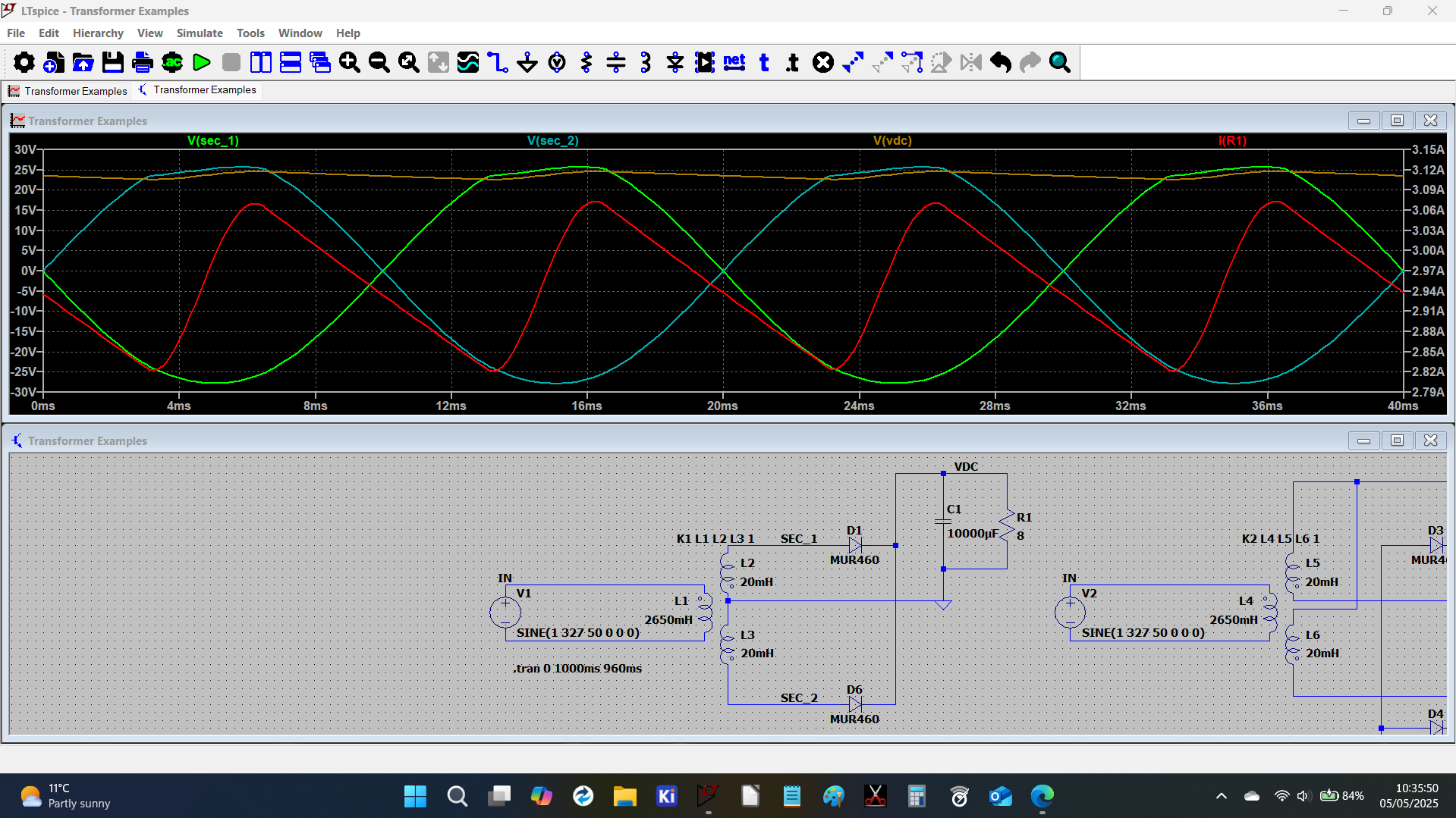

I think this was meant to be an 18-0-18 I was playing around with.
L1 = 6 ohm
L2 and L3 0.2 ohm
