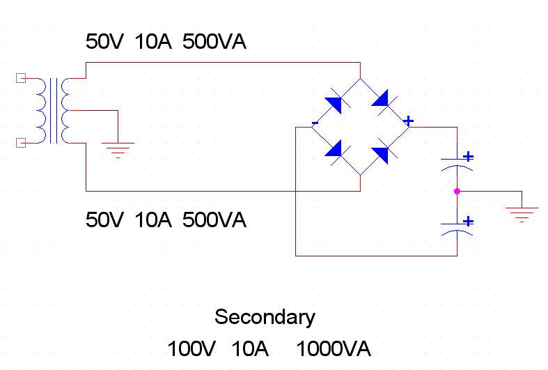

Thanks for the replies, here is a
picture to help me figure out the
mystery.
1KVA secondary, 100v@10A.
Above the center tap, the output
is 50v@10A, below the center tap,
the output is also 50v@10A.
Positive and negative rail voltage,
+50v and -50v.
If I don't use the 'negative' rail
at all, is it possible to get
50v@20A from the positive rail
assuming ideal conditions.
50v@20A = 1KVA since the bottom
1/2 of the transformer is not used,
is this theoretically possible ?

"Lets vote "
You counting wrong answers?
The best I would figure on long term would be an increase in current of 1.414, IOW about 70% of what you could get if you ran the trafo the way it was designed.

No, you just would have one 50V@10A transformer. Just think of the transformer of being made of two such transformers connected together with the primary side being capable of delivering 1KVA.
Current is limited by the diameter of the wiring, respectively the generated heat...
If you could cut the center tapping, you could connect the two transformers in parallel. Then you will have one 50V@20A...
Good point, but the two individual transformers would be
designed as such to only allow 500VA each.
The 1KVA example is designed to allow 1KVA, so what
happens to the magnetic flux generated by the primary side ?
Will the top 1/2 of the secondary utilize it if the bottom
1/2 of the transformer is idle ?
janneman - good post, but I'm assuming constant draw
not real world - just to know what is the maximum capability.

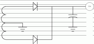

With an ideal transformer yes. In reality no. However if you only need a single output voltage and want to be able to get a supply voltage like you had a single 50V, 20 A winding then use a center tap grounded, full wave rectifier circuit like this.
Please excuse the schematic, I drew it in Viseo and it didn't transfer well.
Phil
Phil gets the prize for best way to get 50 v from 100v ct transformer, but you still only get about 95% of the 1kva. His setup still is only using one leg of the transformer (at a time). The smaller wire (compaired to a 50v 20a) causes more resistive heating. One leg of thr transformer could likely produce 40 v 40 a with a short duty cycle. The limit is the temp rise which is dictated by the total average resistive heating. Wire size isn't a signifcant limit to the output current. Put an ohm meter on a 1kva secondary and you'll see around .1 ohms. That's 2v, or 40w (peak) resistive loss.

If you choose to use only 50% of the winding you may go to a higher current but not twice the rated current 141% is probably an honest figure, a current of this value will double the heat production in the part of the winding in use and the unused part will not heat at all.
http://www.atc-frost.com/products/design/va.htm
Of couse you will have 50V@20A. The power of transformer is the same, 1000W, and is limited by the core section surface and material. If your transformer have a wire large enough (4-5 mm diameter), the loss is negligible. Is like you will rewind the secondary with 1/2.
"Of couse you will have 50V@20A. The power of transformer is the same, 1000W, and is limited by the core section surface and material. If your transformer have a wire large enough (4-5 mm diameter), the loss is negligible. Is like you will rewind the secondary with 1/2."
BAD ANSWER !
Loss in secondary of transformer:
top half at 100% of rating I^2R=1
bottom half at 100% of rating I^2R=1
sum of top and bottom 1+1=2
Double current in top half only I^2R=4
bottom half not driven.
sum of top and bottom 4+0=4
(flaming hot!)
1.414 of nominal current in top I^2R=2
sum of top and bottom 2+0=2
While the total heat in the secondary with one half driven at 1.414 times nominal is the same as both halves driven at nominal, hot spots may exist.
The only saving grace here is that the primary current will only be .707 times nominal so there will be some reduction in total temperaure rise.
BAD ANSWER !
(flaming hot!)
Ok...here's the real deal...just connect the 2 secondaries together and u get 20A...what's all the fuss about?? If you cannot get seperate secondaries...then open up the trafo and cut it up...it should be quite easy...been there done that...
- Transformer question
