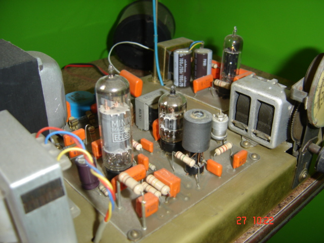

why are most supply chokes open frame?
Because magnetic harnesses short circuit (magnetically) the gap in the core and make inductance difficult to calculate and predict. It also happens with all cores with DC superimposed, as in audio output transformers single ended. Look, for example, my regen output trafo made from tube vertical TV deflection core and harness. There is a cut near the gap site to prevent core saturation and gap short circuit (Bottom left of the pic).
