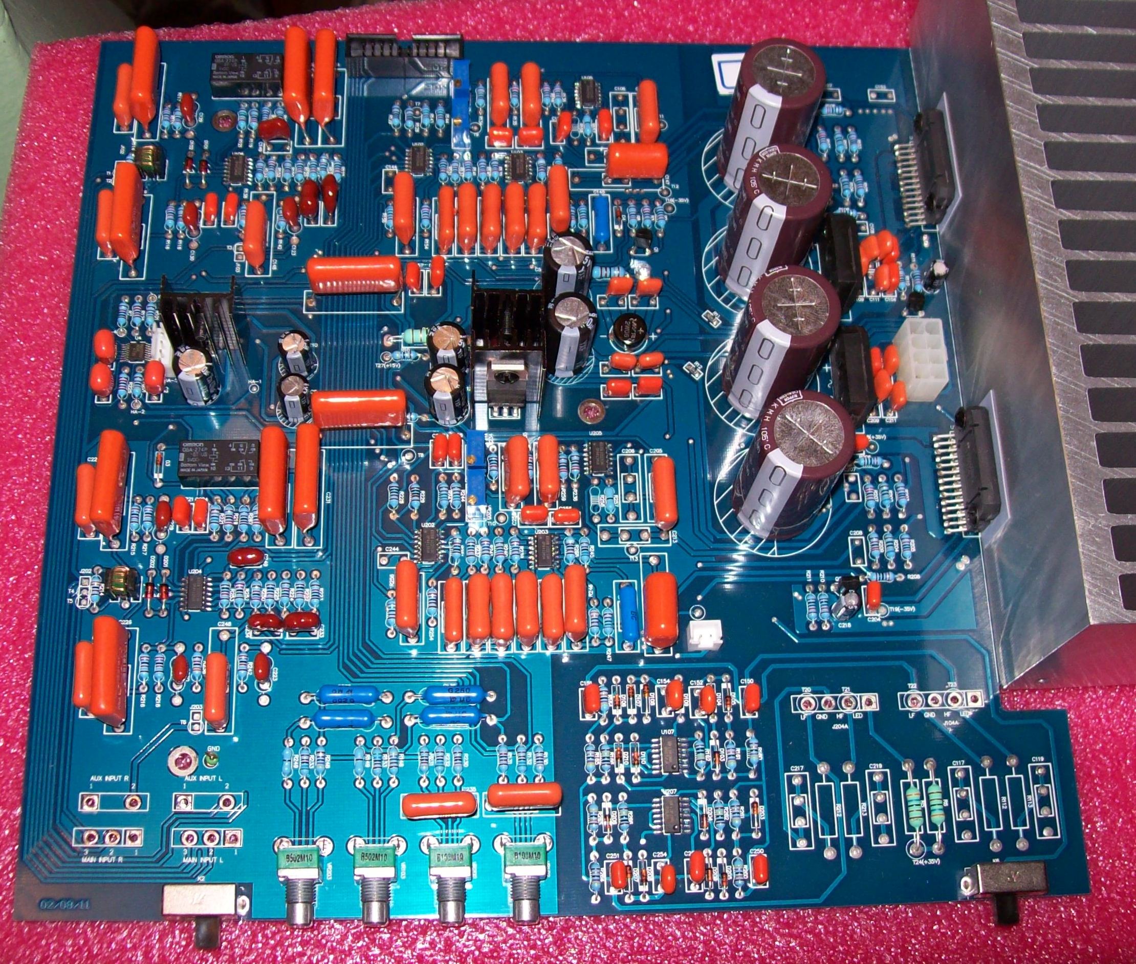

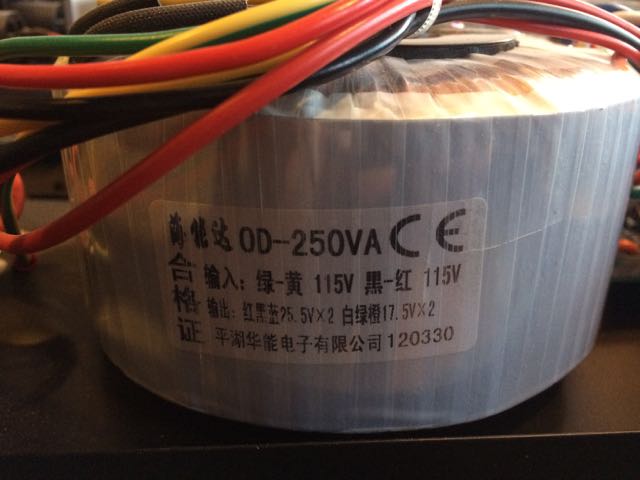

There is this amp main-board (sE Munro Egg 150). It accommodates a dual linear psu, preamp, 2x2 channel power amp, headphone amp and an active crossover network. I need help in finding out what transformer is needed for it.
I have find the photos on the internet of the factory psu rated 25,5v*2 and 17,5v*2
However the board has measuring points showing +35, -35, +15, -15 and +5 volts. 25,5 regulated works out for 35, but 17,5 will be lot more than 15.

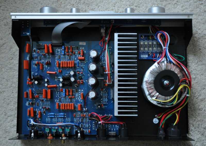

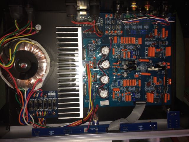

Here is another photo but the transformer here is a center tapped one. The regulator caps look a bit different too, but as far as I know there were no different revisions of the amp.
Any ideas? thanks

....factory psu rated 25,5v*2 and 17,5v*2 ... However the board has measuring points showing +35, -35, +15, -15 and +5 volts. 25,5 regulated works out for 35, but 17,5 will be lot more than 15. ...
2*25V AC (or 50VAC CT) will make +/-35V DC, around 60 Watts in 8 Ohms.
2*17VAC (or 34VAC CT) will make +/-24VDC raw which is probably regulated to +/-15V DC clean.
You want a core around that big, 200+VA. The 2*17VAC winding maybe only needs to be 1/4 Amp.

Another question. Is there any specific reason for the fuses being on the secondary winding? Shouldn't be a single enough on the primary?
If the low-powered secondary is shorted, it still may not pull enough power to blow the large primary fuses.
This may be especially pointful in DIY, where mistakes happen.
But fusing is often arbitrary designer's preference.

I would normally not recommend secondary fusing. If the secondary gets abused the close rated mains fuse will blow.
But PRR has hit the nail on the head.
Where a small VA winding is ALSO on the same transformer, then to prevent damage to that small VA winding it would be better to have a secondary fuse on each low VA winding. This could be normal, or F, or T rated depending on the start up surge in the low VA circuits.
The main secondary winding will feed a rectifier and smoothing capacitors before the load.
If any of the rectifier diodes or a smoothing cap goes faulty/shorted then the secondary fuse needs to be located before these components to be of any use.
The current demand at start up is enormous and to survive repeated cold starts the secondary fuse/s needs to be big and probably T rated.
A big fuse like this provides almost no protection to the main secondary winding for a long term overload. A correctly sized close rated mains fuse will blow before a big secondary fuse. This is what saves the transformer.

Since I haven't purchased the transformer yet, shall i go for two trafos instead? One toroid for the big secondary rail and one R core for the small. Like that i would use one fuse each?
Two separate transformers will be much simpler to buy.
Each would have it's own close rated mains/primary fuse.
Then in my blinkered opinion you would not need any secondary fusing.
To get reliable starting on the high VA transformer you will need to use a soft start circuit.
The high resistance of the primary of the low VA transformer acts as it's own current limiter.
You will find that <50VA 230Vac toroid will start reliably on an F500mA mains fuse.

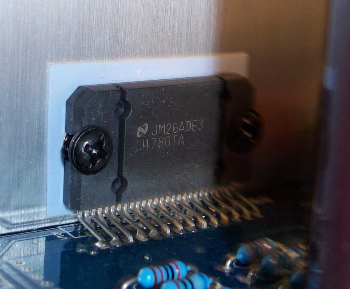

BTW the amp supposed to deliver 4x50w pc @ 8Ohms, this is the amp chip,but cannot find any info about it.
The 4780 is a dual chip 3886 in one package.
It is now obsolete. Maybe Ti took down all references to it.
I have the datasheet in my computer files. Do you want a copy?
I have tested the 3886 chip on a UK power and I find it gives ~50W from a 25Vac transformer.
The EU runs on a slightly lower voltage and that WILL reduce the maximum power available from the amplifier.
if you assume 4 channels all at maximum power of 50W, then a 200VA to 400VA transformer will work for a domestic system.
