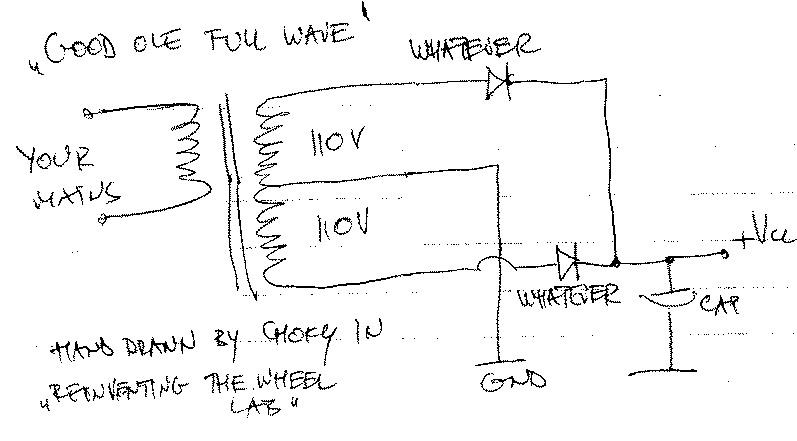

mebbe is better solution to use both halves ?
CT to ground,and wo diodes (one per half) to + output-just like good ole vacuum rectifier?
in that case your tranny will run colder

choky said:mebbe is better solution to use both halves ?
I agree with this
better not to leave floating windings 😉
Yes, you should use a full wave rectifier, then you only need 2 diodes! Less sand in your system! 😀

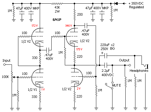

Ok, here is the schematic. I know that there are better ways to do this but Im trying to stay as close to "cloning" the amp as possible. I plan to use 4 FREDS for the fullwave rectifier, each is rated to 12A and 1200V so even if I parallel the winding I won't be heating up the FREDS. Is there a problem with supplying twice the amperage to the amp, or will it only draw what it needs anyway?

oops, here it is.
Milo
Milo
That looks alot like a headphone amp I've seen on Headwize.
Runeight, was that yours?
An anode follower DC coupled into a WCF, nice.
It's very easy to add a bigger cap on the output and a jack so you'll be driving your cans with it as well.
Here's something similar I toyed with a while ago:
Cheers,😉

Yeah, its alot like the Morgan Jones on headwize but it differs in a few ways. It is the HAP-03 made by RADII out of China. Its a real POS but if you can get it to work it sounds really nice with Senn HD-600's. Ill be using mostly High ohm cans so I think that I can keep the Output Cap low, if not however Ill just add it to the headphone jack.

CHOKY
Im interested in that solution but im still to new at this. could you draw me a picture. Ill post it on my refridgerator 🙂
Milo

oooo fancy!

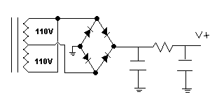

Efficient in the sense that it would put out a higher voltage, since you said in your opening post that you only need 110V I assume
there's little point in turning excess voltage into heat.
You'll already see close to 125 VDC max on the filter caps.
Using a FW bridge and NOT grounding the CT would give you twice as much volts in theory.
If that's what you want then that's fine by me. 😉

I dont know if the powersupply section calls for delivery of 110V or if that is just the winding of the transformer that they used (the schematic is a little unclear because they never give voltages at test points). If I were to construct a powersupply as below, wouldnt I have basically 110V (not taking into account RMS due to the rectifier or the caps) and just twice the amperage that each side of the winding could produce? Again sorry if I'm totally missing something.
Thanks,
Milo
