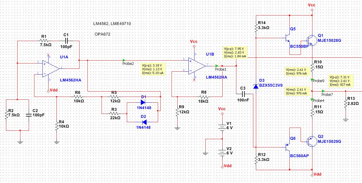

I am making a device which is not related to audio and not related to PSUs.
I am making this device for my own personal use.
I am not 100% certain about the device description yet, but I have a rough idea. I will need to experiment to get more information.
I have worked "backwards" and I decided I needed to use a transformer. Obviously this may not be the right thing to do - but it is a start.
A general description is this:
The device must produce an output of 200KHz sinusoidal at a peak of 50 Volts. The output of the device will be applied onto a unit which may have a resistance of about 400-800 ohms (this is not verified yet). The unit measures approximately 15 cm - 20 cm and an electric field of 1V-2V / cm must be created. The electrodes of the device will be attached to the unit via two pads which will also present their own resistance, may be 100Ohms on each pad (this is not verified yet as the pad material has not been chosen yet).
So far I have created one module: a 200KHz sinusoidal generator producing 4.2V peak into a load of 5 Ohms. The explanation is:
The generator is a Wein bridge using an dual audio op-amp LM-4562 where the first op-amp generates the 200KHz and the second op-amp amplifies/buffers it to get a final 4.2V peak (2.97V RMS). There is also a transistor push-pull stage to allow us to drive 2-5 Ohms.
Now all that remains is to transform the 4.2V peak into 50V peak. For that I would need a transformer with turns ratio of approx 12. That means that the load on the secondary, a worst case hypothetical 400 ohms (not verified yet) will be reflected back to the primary as 400 / 12^2 = 2.82 Ohm.
So my first stage has to be able to drive a 2.82Ohm load at 200KHz and at 4.2 V peak.
Now comes the selection of the transformer.
The transformer is needed because the device is powered by 2 6V batteries - therefore creating a +/- 6 V supply.
So far I know that the transformer needs to have a turns ratio of 12, work at 200KHz sinusoidal and drive a load of 400 Ohms at the secondary.
I am not sure about the power of this transformer, but I tell you I tried my device on a 5 Ohm resistor (to simulate driving the transformer) and both the resistor and the output transistors get very hot (must use bigger heatsinks).
If you can tell me what transformer I need and so on you'd save me a lot of reading 🙂

Thanks for that.
Yesterday I found a few RM10 cores and bobbins in my drawer , I wound 10-11 turns enamel for the primary and 100+ turns for the secondary (got bored and stopped counting after a while). I then put the whole thing together and held the two halves with electrician's tape.
By testing Vp and Vs on no load, it seems I have wound a ratio of 1:10 rather than the 1:12 as I should have (next time I will count).
I have also checked and the transformer is not getting hot (or even warm) but I have ordered digital thermometers to make sure.

Hi. I have been reading but still have tons of questions.
I have used an RM10 with AL = 4500nH, me=1650, gap=0, length = 44.6 mm and area = 96.6 mm^2.
I have wound 10 turns of 18 AWG wire on the primary and 100 turns of 30 AWG (or even thinner) on the secondary.
I have used it under these conditions and it seems "OK".
F = 200KHz pure sinusoidal
primary : 2.5 V RMS
secondary : 25 V RMS @ 50 mA RMS
However given what I have read so far, I *think* I should have started by doing core power calculations and then the number of primary turns and so on.
So what I need is a tool to input the requirements and get the necessary info on cores to use ( effective area and length, permeability, flux (the AL value whatever that is), the wires to use and the number of turns
