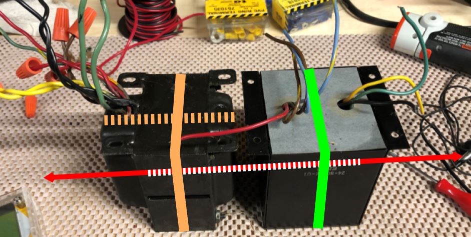

Hello:
I have read quite a few internet articles and threads on the subject of transformer arrangement for minimizing hum. I am finalizing my layout for a current monoblock tube amplifier build.
It seems that the most common advice is to 'arrange the OPT and PT at 90 degrees to one another'. However, it has never been clear to me which exact axes of the OPT and PT are supposed to be orthogonal to one another in this recommendation.
(Bad link removed, see below in reply no. 7 where I inserted the pics)
In any event, I did the 'headphone test' with this transformer pair. Referring to the photo I have posted here, the quietest arrangement I found is the position almost shown in the attached photo. The qualifier 'almost' is applied here as they are shown turned upside down about the axis sketched in red, so in the photo we are viewing them from the bottom. Note that in this (quiet) arrangement, the orientation of the plate stacks in both transformers (solid orange and green lines), are parallel to one another. This surprises me as it seems to run contrary to the common advice to arrange 'OPT and PT at 90 degrees to one another'.
If I rotate the PT 90 degrees so it's plate stack becomes parallel to the dashed orange line, the noise level jumps significantly higher. Rotating the OPT 90 degrees relative to the orientation indicated by the green line has little or no effect. It might be slightly noisier in that position than the orientation indicated. If so, the difference is imperceptible - to my ear anyway. My DVM set on AC volts cannot measure any difference between these two OPT orientations.
Does this make any sense? I prefer the orientation shown as it is significantly better from a chassis construction standpoint, but considering the overwhelming prevalence of statements recommending 90 degrees of relative rotation I am uneasy with this choice. Does anyone have any insight or advice to give?
As usual, any advice is much appreciated.

1. Your photo did not post.
2. Not only is the orientation of the power transformer, B+ choke, interstage transformer, and output transformer important . . .
Do not use a Magnetic Steel Chassis.
Magnetic steel conducts magnetic fields really well; just as well as copper wires, silver wires, and gold wires conduct electricity.
3. Spacing of interstage transformers, and output transformers to the power transformer and to the choke is important.
Using an Aluminum chassis, the magnetic coupling of interference tends to go to the square of the distance.
4 inch spacing versus 2 inch spacing will reduce the interference by 4X.

You should read a quick article on "The Right Hand Rule", then pop covers off any iron you have if you're uncertain about how the coils are wound.

You want the coils of the output transformers to be at right angles (90 degrees) to the coils of power transformers and chokes.
A magnetic steel chassis will mess all this up, and the best angle may be something other than 90 degrees, but it can not be very good (don't ask me how I know).
Generally, Interstage transformers and single ended output transformers are the most sensitive to magnetic pickup.
Push pull output transformers have the Es and Is interleaved, so they are less sensitive to magnetic pickup.

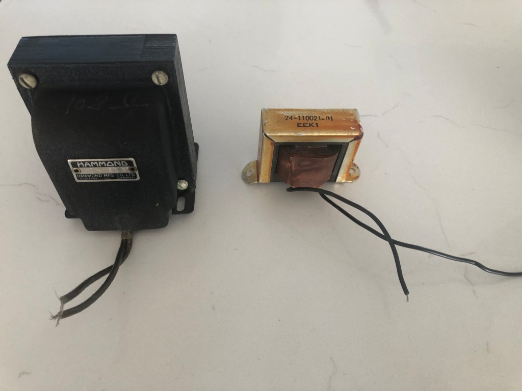

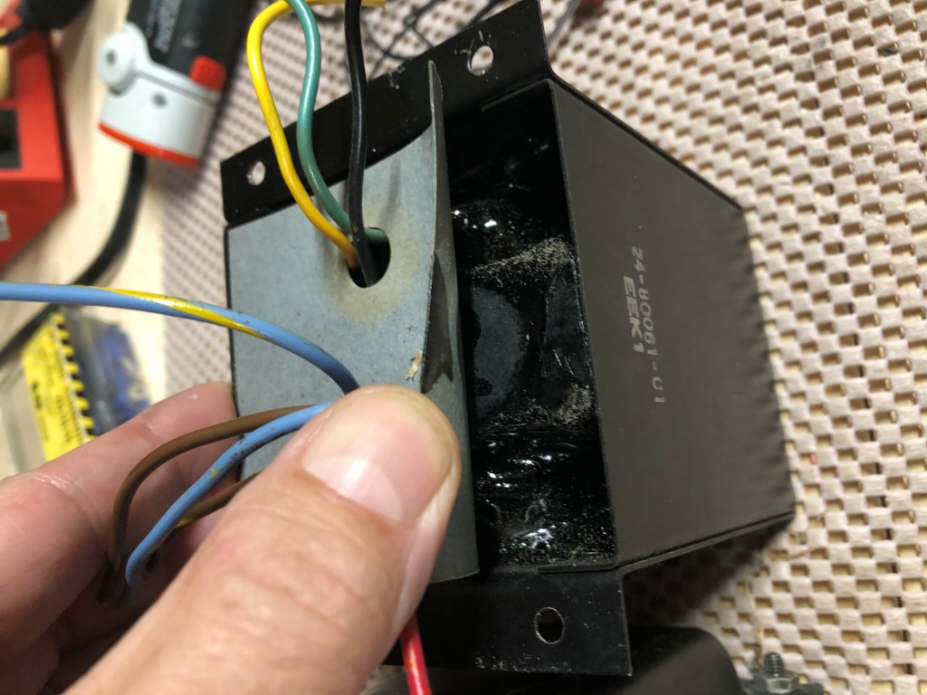

Thank you for the responses. Sorry about the bad link.
I added a 2nd picture where I lift the bottom cover. Not very clear but you can see the plate stack in the center.

This will be a choke input filter. The massive choke on the left (10 H) is almost as big as the PT. The plan is to locate that pretty far from the PT, plates at 90 degrees to PT plates. That location is even farther from the OPT.
Not worried about the 2.5 H choke so much because it will be down below inside the chassis, which will be in wood BTW, with an aluminum top plate.
Don't worry about coupling from the power transformer to choke (unless it's a second choke feeding low level stages). But power supply choke (especially choke input) can couple to audio transformers.
