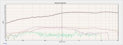

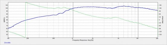

That's good to know. Next question for anybody out there. Anyone measure or have a link of testing; especially impulse/transient response? I'm thinking the MgO is probably better damped so I'm hoping for minimal overshoot, ringing, etc. as some other metal tweeters tend to do with very fast rise time signals.
I see that other's test results are similar to mine. The frequency response in the advertised data is substantially different (>4dB) than the actual measured response. That's of course assuming the use a calibrated mic and an IEC baffle.
I'm not sure what the point of matching to +\1dB within a pair if the FR is quite different than what is being advertised. If one of the tweeters is damaged, one would need to buy another pair because it won't be possible to buy a matching tweeter.

Well, that doesn't necessarily speak to batch consistency issues- but yes, the published response should match the measured.
