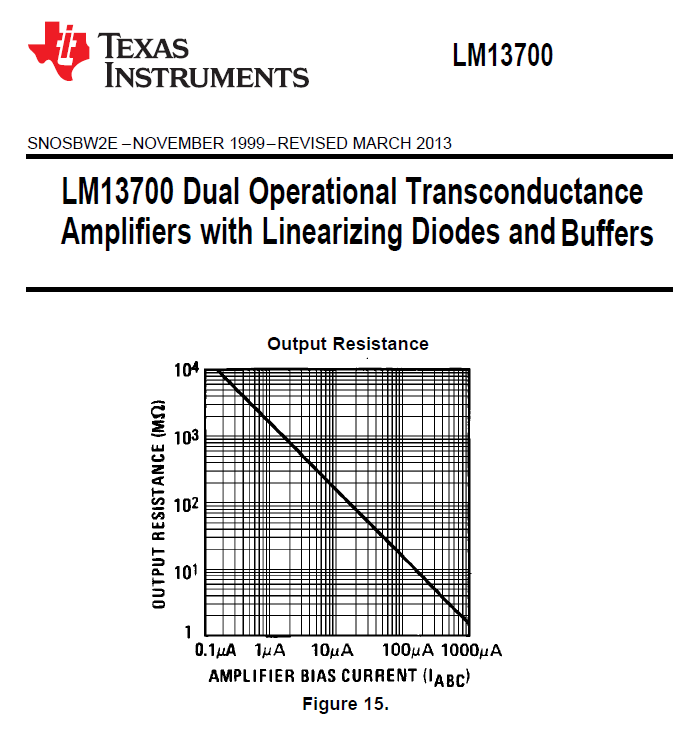

Pragmatically speaking you can use open loop output impedance as an indicator. If output impedance Zout exceeds (10 * Vsupply / Isupply_max) then the amplifier being studied is probably a transconductance amplifier.
Let's work an example. The Texas Instruments LM13700 IC is, unambiguously and indisputably, a transconductance amplifier. See below. According to the datasheet its Vsupply is 36V and its Isupply_max is 20mA. Thus our pragmatic indicator would say "yes it is a transconductance amplifier" if and only if
Other members may have their own preferred value of the coefficient in the inequality; they may wish to replace "10" by a different number.
- Zout > (10 * 36 / 0.02) ... ... ... numerically, Zout > 18 kohms
