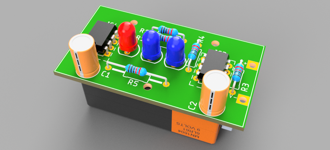

traffic lights - school project for my little girl
something that I plan for school project for my little one.
NE555. something I found on net
dont mind the led color on model😉

Cool! For scale/size/realism it maybe would be better to have the LEDs on a separate thin PCB which can be glued to a traffic light pole.

Is it just me, but I think two Blues and a Red needs some work to resemble traffic lights?
Not sayin' it can't be done with an NE555, but a significant challenge. 😀
The 3D cad model I have, used default models for led , assured that they will be red yellow green in that order as per schematic. post#1 says this.

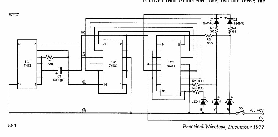

The very first thing I built was a traffic light display. It was this one and the circuit was designed to get the (in the UK anyway) sequence correct of red, red and amber and then green and then back through just amber and to red.
Thank you. Here the sequence is green -orange-red-green....
I will sim the circuit to see if it indeed gives the correct sequence, that should serve the purpose.
I don't think the second 555 IC will enjoy having its reset input tied to +9V when its VCC pin is driven low by the other 555 IC.
A better way to control the 555 is to use its reset pin.
This seems like a good learning opportunity to learn about state machines. 🙂
