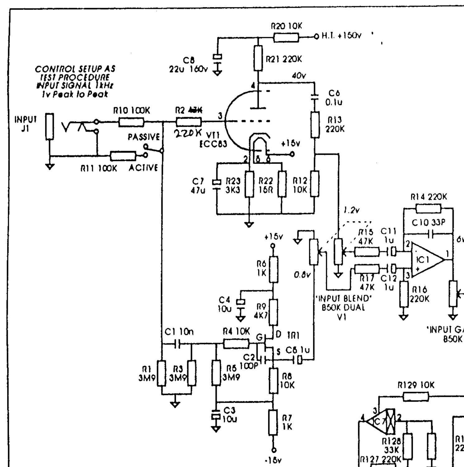

I found the repair manual online so I have the full schematic which is cool. I've got a multimeter and some basic tools and I'm willing to learn (if it's not too dangerous of course).

Please note that the pin numbers are wrong in this schematics! An ECC83's/12AX7's plate is either at #1 or #6, the cathodes are at #3 and #8.

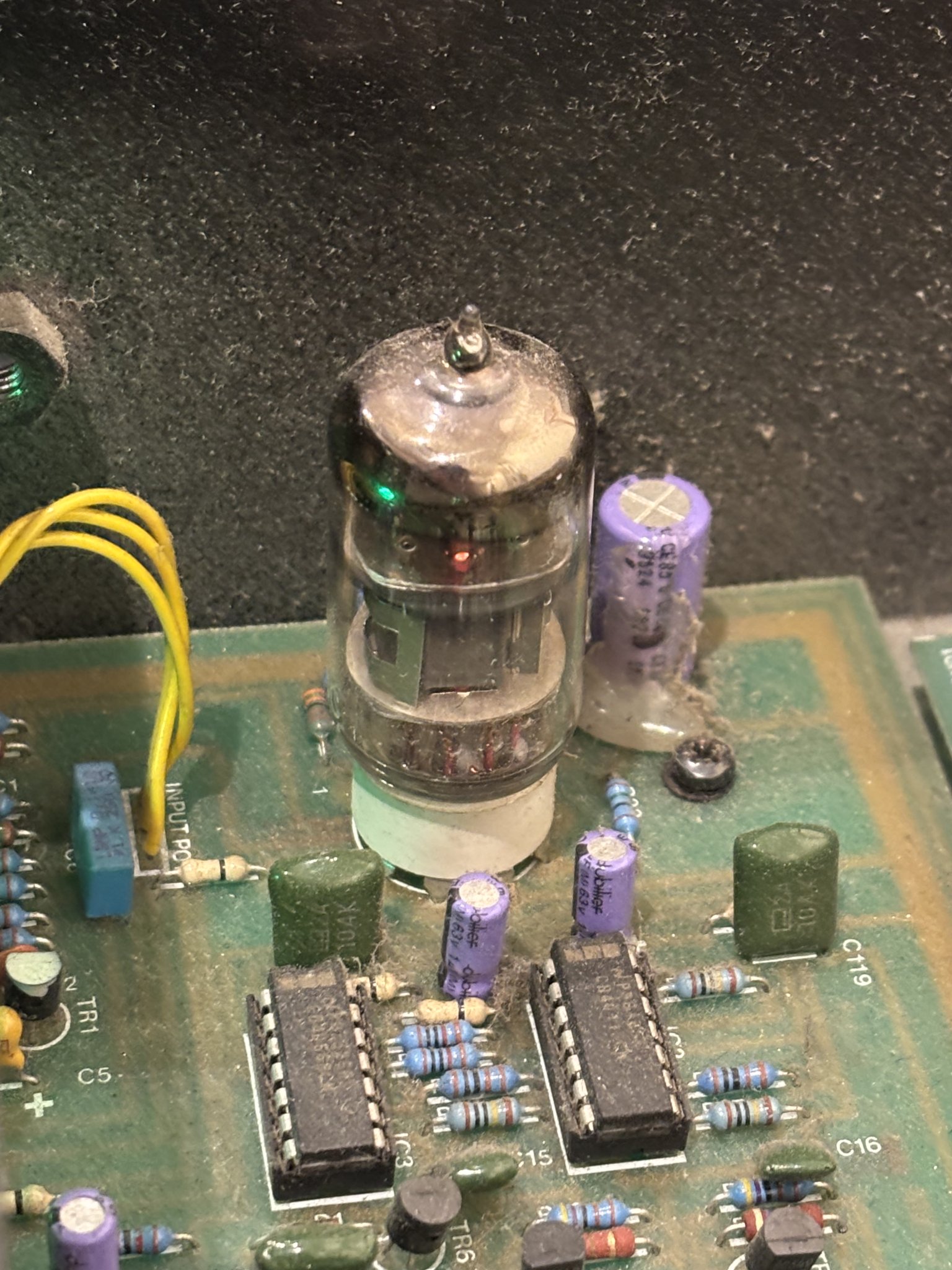

I get continuity between pin 9 and 4 and between pin 9 and 5 on the tube itself which seems to indicate it's ok. The tube does light up but the glow is faint. Pic attached.

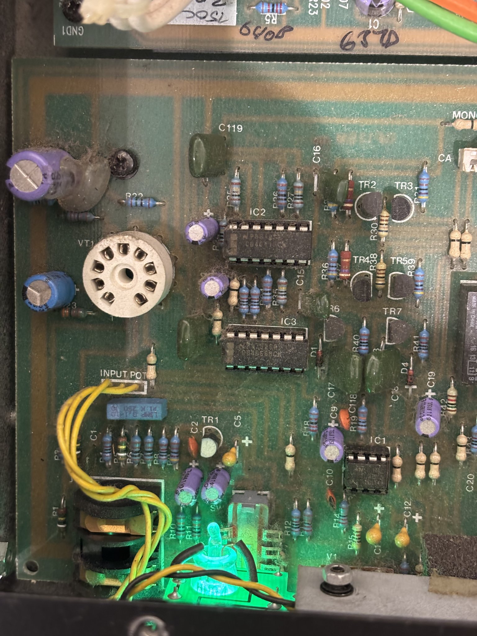

On the amp, with the multimeter set to 20V DC, I get 14.8 on pin 5 and -0.2 on pin 4 (which is odd... the value started around -0.5 and increased to -0.2 slowly). I've put a picture of the insides as well in case there's something obviously fried that I'm not seeing (it's a bit dusty, sorry!).

As I said: The pin numbers are wrong in the schematics! 14.8 V @ pin 5 is ok, but I'd expect 1,2 V @ pin 4 after tube warmup.
Anyway, what's the voltage at pins 3 and 6, respectively? Does the amp hum when the tube bleeder control is set fully to tube and you touch pins 3 or 6 with the probe?

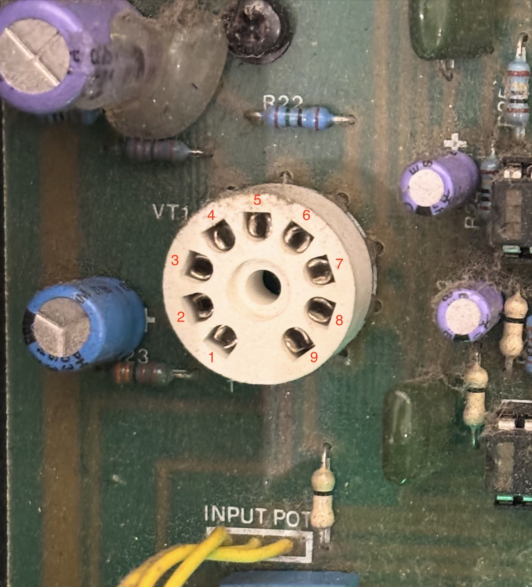

All the way to valve, the only pin that gives a hum is Pin 4, everything else is quiet. For the sake of clarity, I'm counting the pins from left to right, which may be incorrect! I've attached a picture to be clear (just in case what I'm counting as Pin 4 is in fact Pin 6!).

The official tube pin numbering is just the other way round! Putthe tube in place again, flip the PCB, power the amp, and measure again!

Sorry about that... I did read about the numbering afterwards since it didn't make sense!
New measurements with the numbering from right to left:

In contrary, very helpful! Replace shorted electrolytic capacitor C8, 22 µF 160 Vdc.
