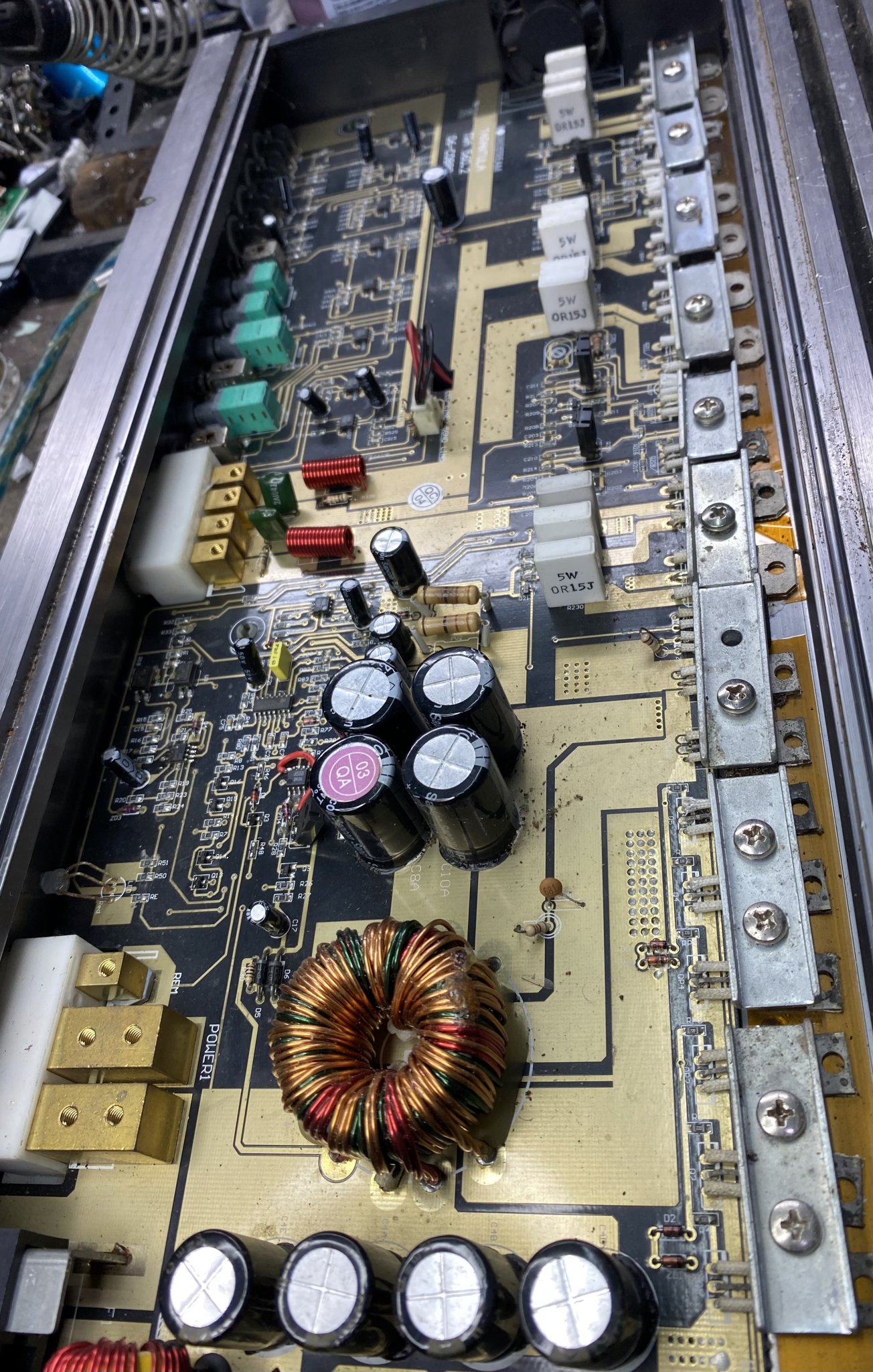

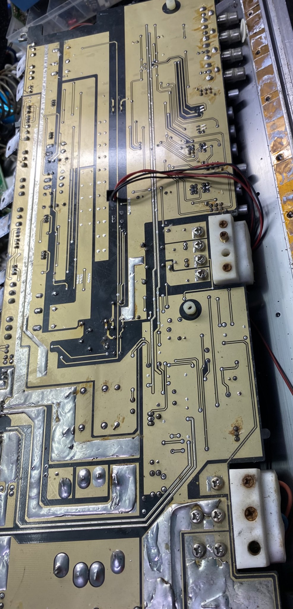

Did it get wet?
If so, did you pull it out of the sink to see how bad the bottom of the board was corroded?

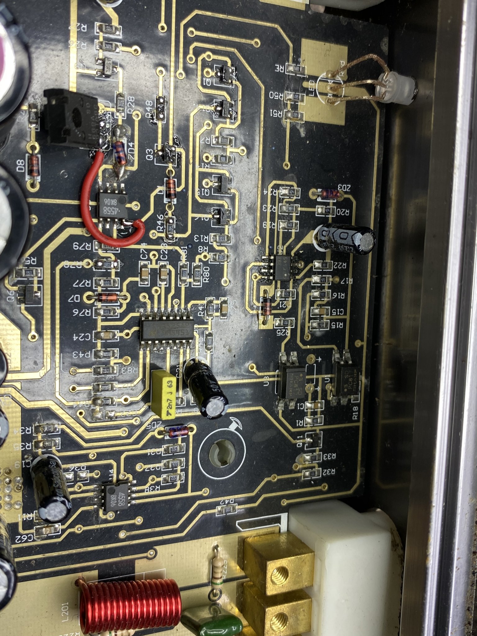

Is the red jumper that you added?
I need a high quality photo (in focus, good lighting.. ) of that area of the board.

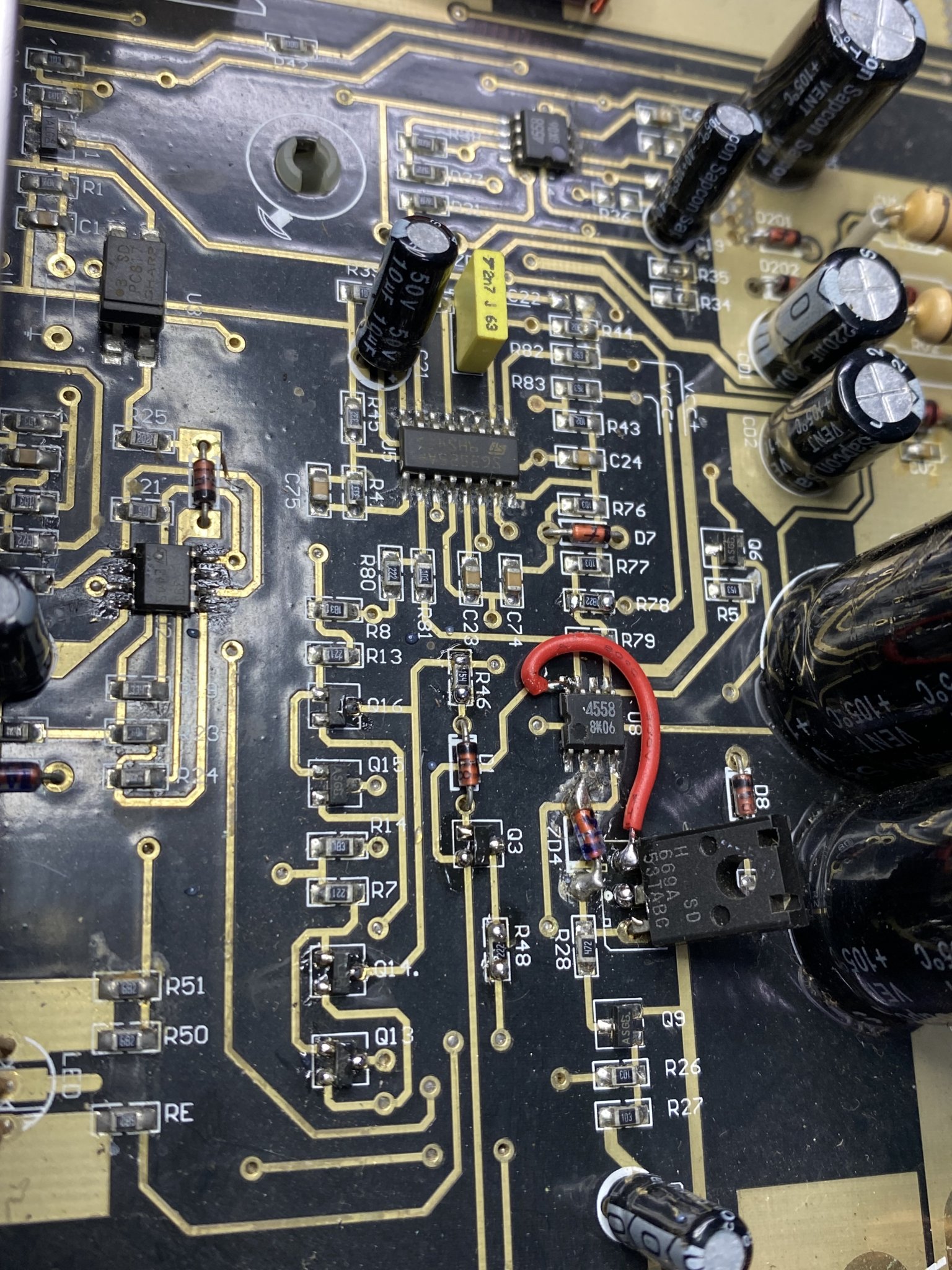

That jumper is from the previous tech I think .Without that jumper the amp does not power up so I guess it is there it force it to power up.Also ZD 4 looks like it has been replace not sure if they put the right value zener in there.
Could it be that they installed an op-amp in place of a comparator and that's causing part (all) of the problem?
Is the circuit for that IC in your amp the same as the circuit for the 393 in the diagram?
The 393 was installed backwards.I install it the right way and removed the jumper that was on the op-amp.Vcc voltage is not reaching the 3525. pin 1 an 7 of the 393 has 12v.I see no voltage on the base of Q24 in the schematic
The IC with the jumper was a 4558. Was it the same location that's the LM393 in the diagram?
If so, did you replace the 4558 with a 393?
Both was in the right location but the 393 was installed in the opposite direction.
I now install a new 393 and it power up and has good audio.
