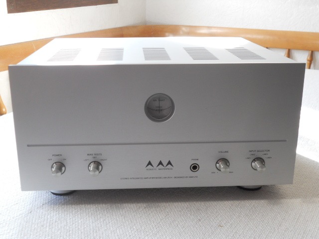

Hello Dave,
budget??? I don' t want to sell a kidney for it! Taste - the driver should be versatile. Room - 25qm. Support kit - AM 201 H/Opera Audio Cyber 10
Kind regards Stefan

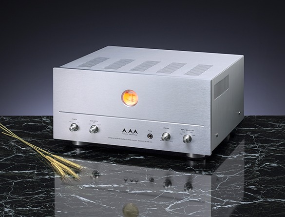

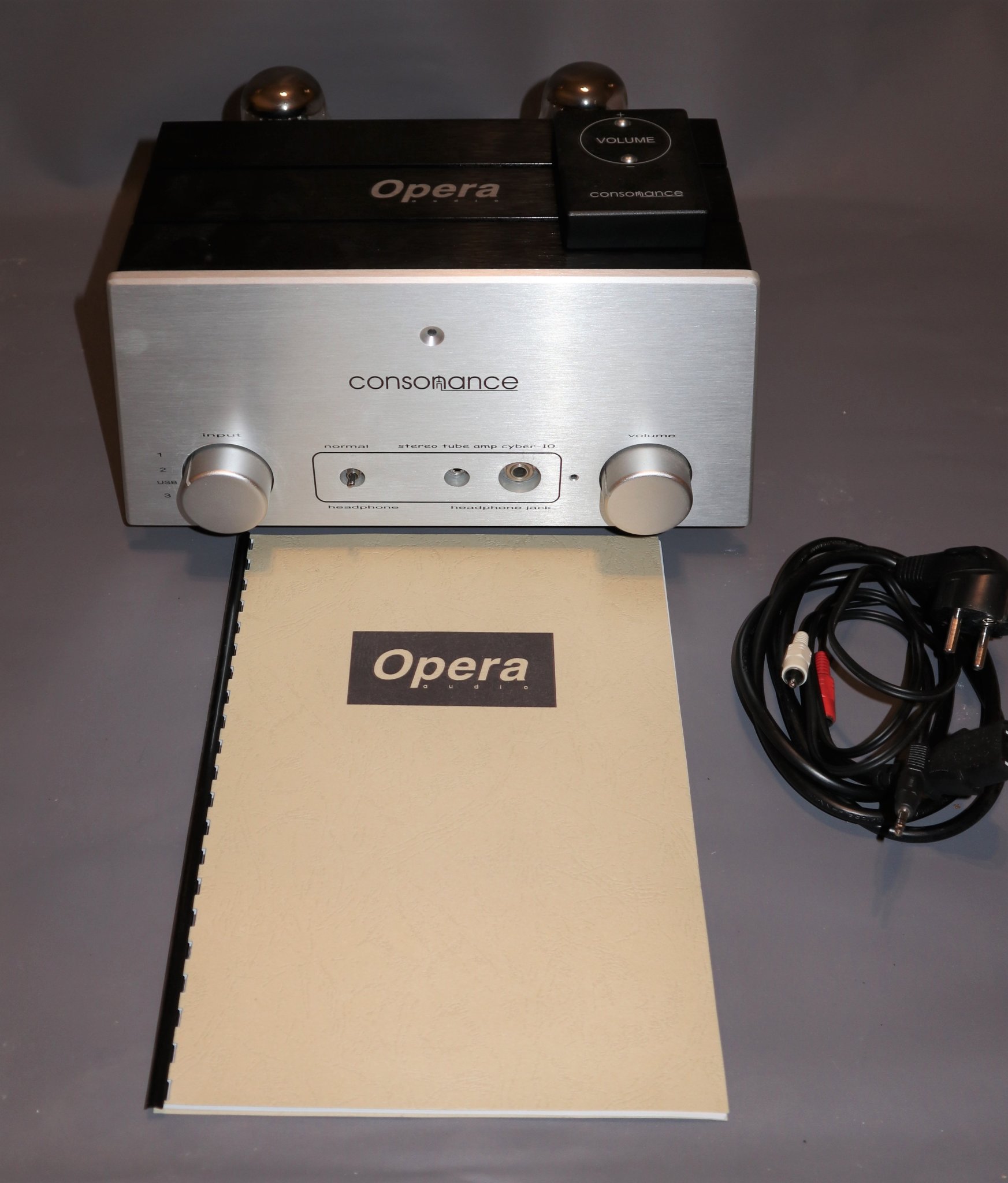

Hey, hey hey - what's going on????
Yes, the Am 201 H is that right - the Opera Consonance cyber 10 has a single terminal pentode KT 88 (9 WPC) per channel, which can be switched to Triode (6 WPC). And even on my ATC SCM 19 these 6 WPC are working fine!!!!!!!
Kind regards stefan

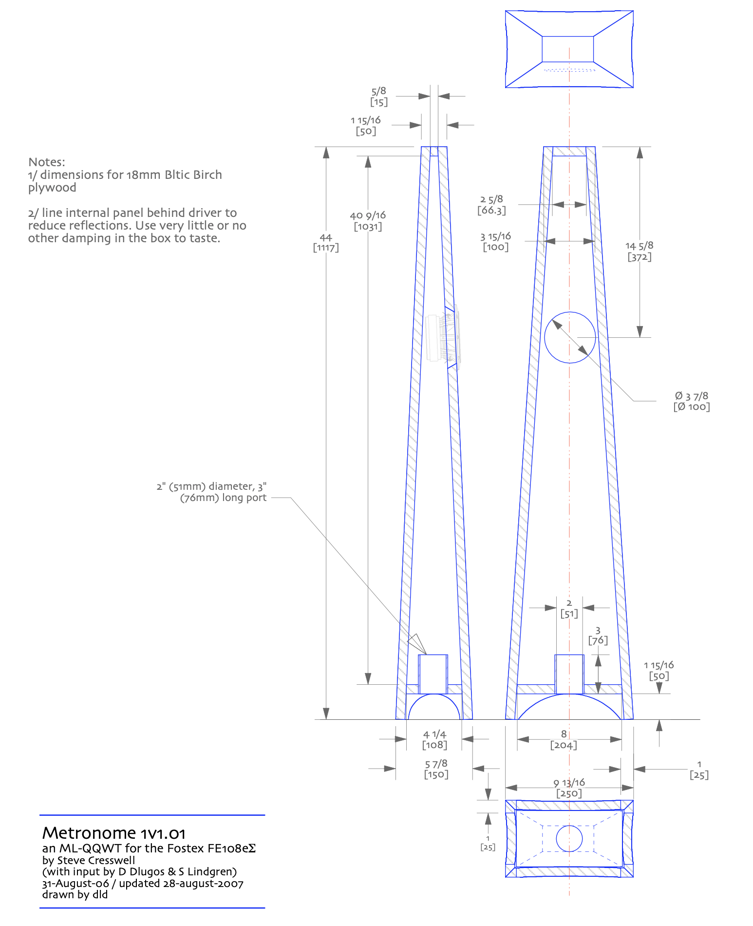

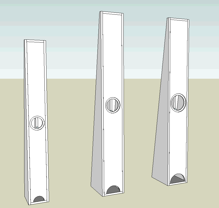

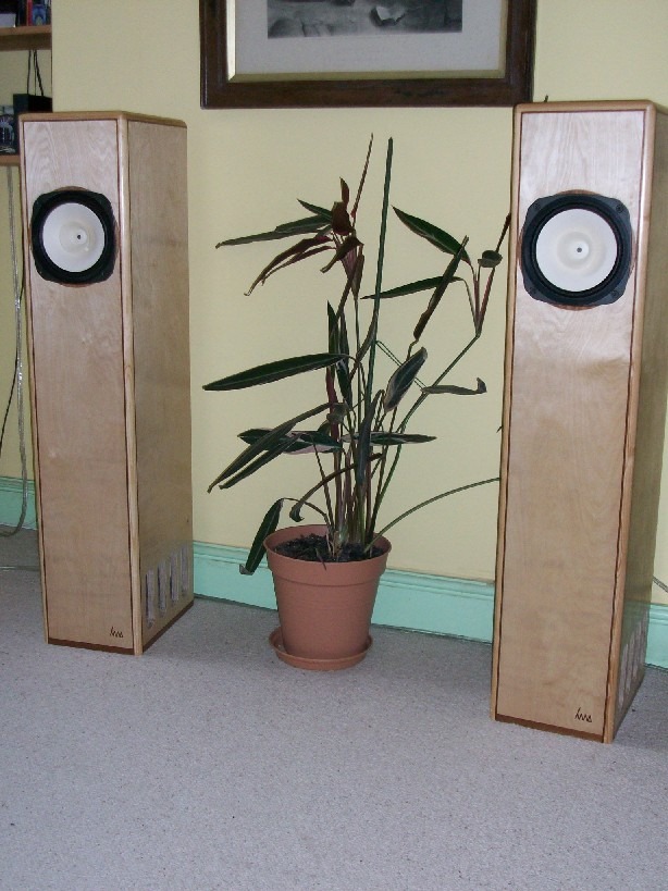

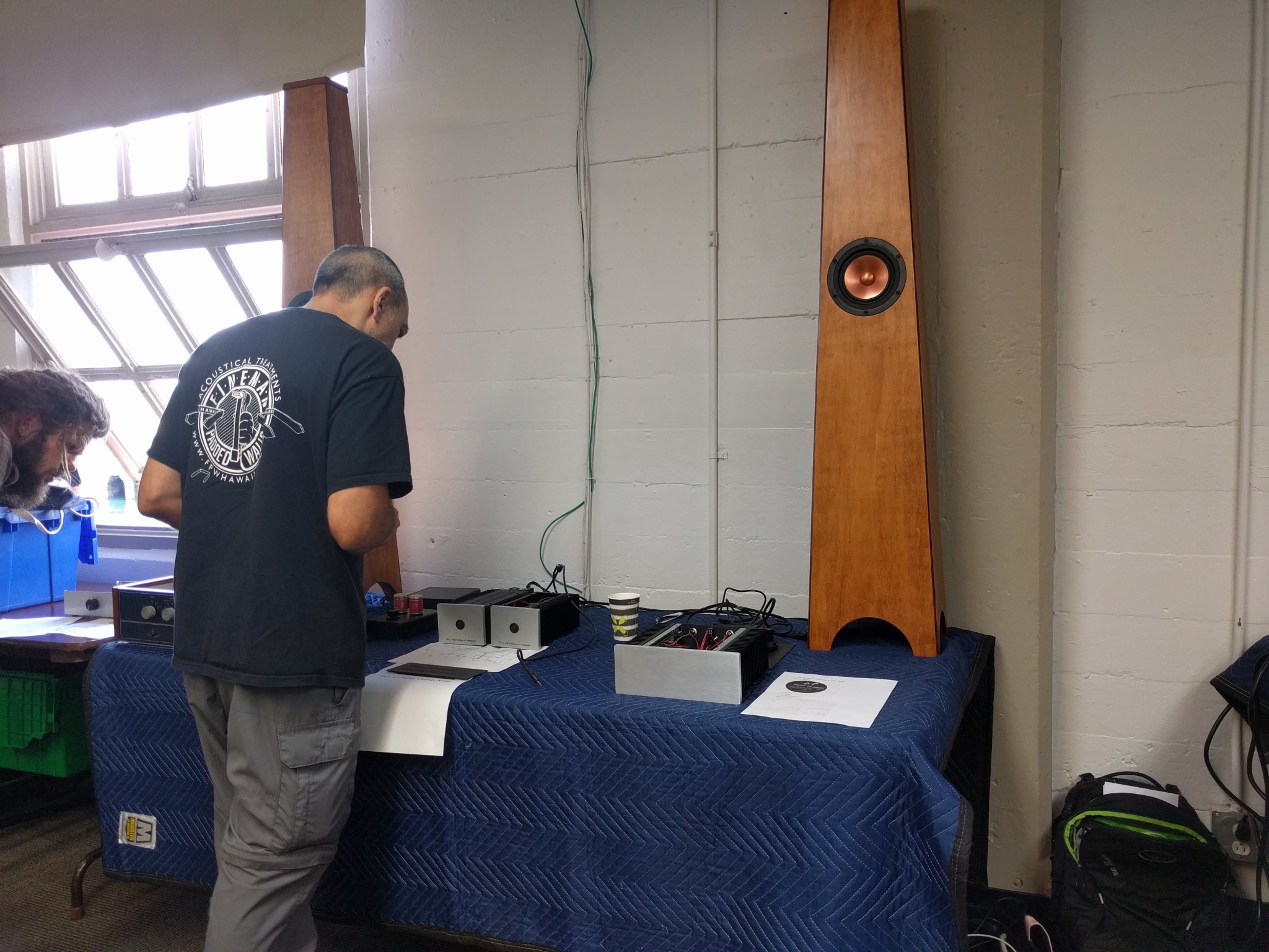

This is a visualization of Lancet for FE108e∑, Nandape’s ue the same fold.
And thee are Festivals
And these are Metronome

a bit long in the tooth now, but was very popular back in the day.
These were run and demo'd many times with a 2a3 and performed well. The ports can be adjusted for load to suit and the wave guide can be ignored if so desired. I tried many variations with and without the wave guide. I preferred with but clio found no difference in response.
Which is a good indication.with and without the wave guide. I preferred with but clio found no difference in response.

Metronome
Here is a table of Metronome dimensions for a mess of drivers, not up-to-date but will give you an idea of the range: https://frugal-horn.com/metronome-table.html
