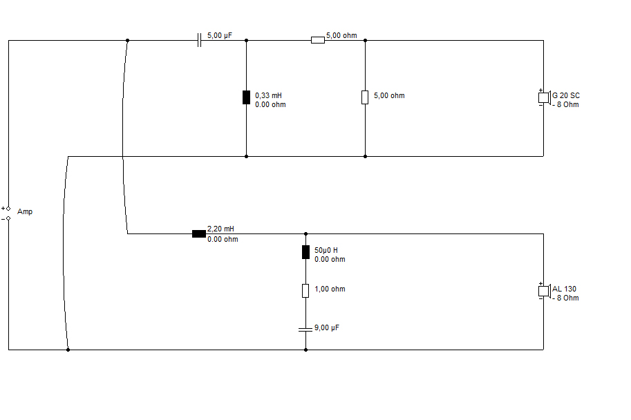

The crossover is essentially identical to the Vib130tl:
http://www.visaton.com/bilder/weichen/gross/vib130tl_w.gif
and mine, never uploaded. just realised.
Anyway, I began by adding a 45uH coil in the shunt circuit of the woofer, and used 5.5uF, the 2.2mH stayed the same. After a bit of a re-design, and from re-simming to re-obtain screenshots, of the ACTUAL size of cabinet.....

A good project, mondo. That metal AL130 woofer is quite a difficult driver to align on phase isn't it? Didn't really enjoy tangling with it in Boxsim, TBH.
You've done a very nice job on the cone breakup with that RCL woofer filter. That was a new one to me.
I noticed that 4.7uF on the soft dome tweeter was a bit kinder to it on suppressing the 1.7kHz Fs resonance than 6uF and improved phase matching from 2-5kHz with a tiny dip in frequency response. You are after all, taking it lower at crossover point than it would normally like. I wonder what effect a tweeter Zobel would have too? Say 6.8R and 0.68uF? Always like them. Smooth. 🙂
FWIW, I also suspect you could have rounded and optimised a lot of those values to preferred values and saved yourself some piggybacking of components. Enjoyed reading about it very much. Thank you for sharing. 😎
spot on, the 6uF aligns phase better, 5uF isnt bad FWIW. I have 6x1uF piggybacked anyway, so a simple operation to change for listening tests.
However 6uF appears to protect the tweeter well enough, at the moment.i dont consider a zobel necessary since the G20SC has a rather good impedance plot anyway.
The fountek tweeter version, i have simmed a zobel of 20 ohm and 18 uf works well, neither tweeter has much of a resonant impedance peak though, so its an after thought, which could be added to the front end, perhaps on the reverse of the terminal plate.
If i should find it necessary lol.
or was it the other way round? 5uF gives a small improvement in phase, and slightly better tweeter protection, the 6uF flatter response and better phase slightly lower down the plot. If i recall correctly. I pondered this along while ago and decided i could just snip one of the caps out, if need be. So i may end up settling for 5uF. The tweeter impedance is rather flat though, so if anything i may add a zobel to the woofer circuit, the g20sc doesnt need one, unless im sorely mistaken.
After a heavy and varied listening session, I have reached the conclusion that 5uF is the final value. I could easily live with the 6uF, but id rather safeguard the tweeter a little more.
I have plenty 0.5uF here so i couldve met in the middle, at 5.5uF, but dont really see the need at this point.

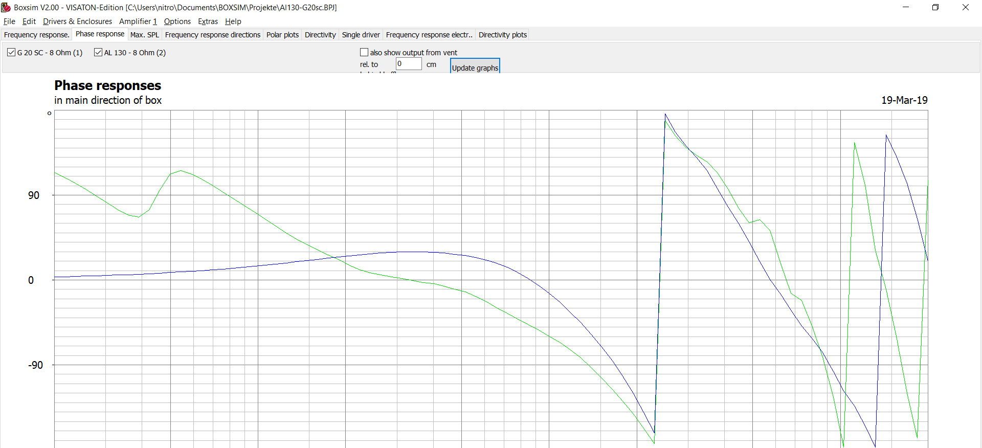

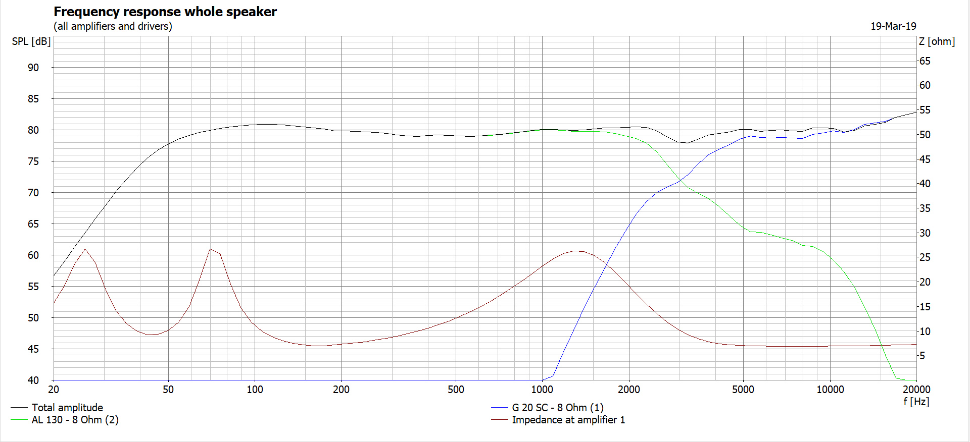

Also the Boxsim program had an update recently (Dec 2018) with new driver files and in my experience it does simulate the frequency range a little differently.

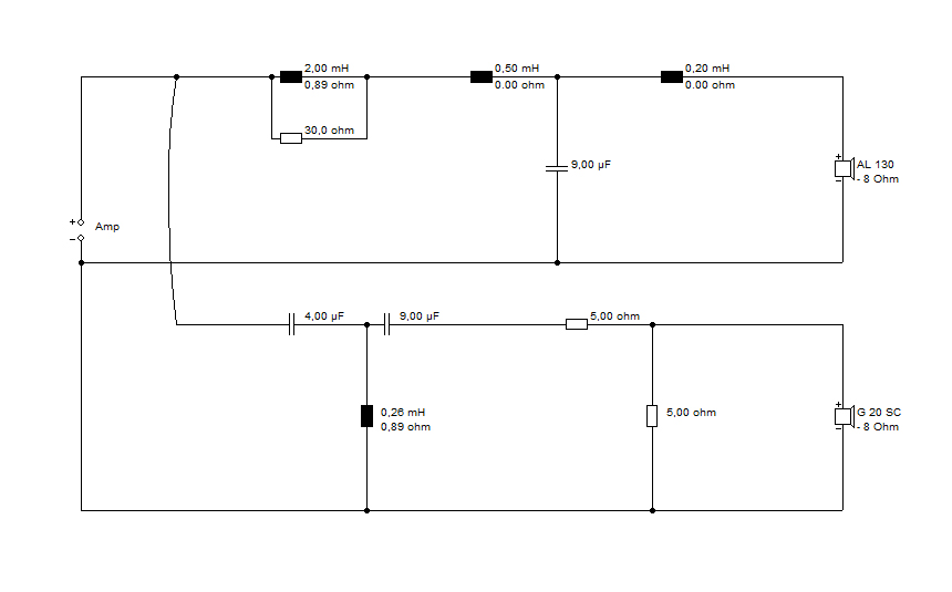

I made my crossover for the drivers and I am asking an opinion from more experienced DIYers than myself.
Crossover point is 3000hz which I think is better for this tweeter than 2000hz because of its resonant frequency of 1900hz. Phase seems to align well enough and the woofer's diffraction point of around 5000hz is at -15db. I have learned that aluminum woofers are more prone to their diffraction being audible and that may be quite nasty sound. So is -15db enough? Simulated cabinet is vented 10 litres with tuning frequency of 45hz.
Thanks for anyone who shares their thoughts on this!

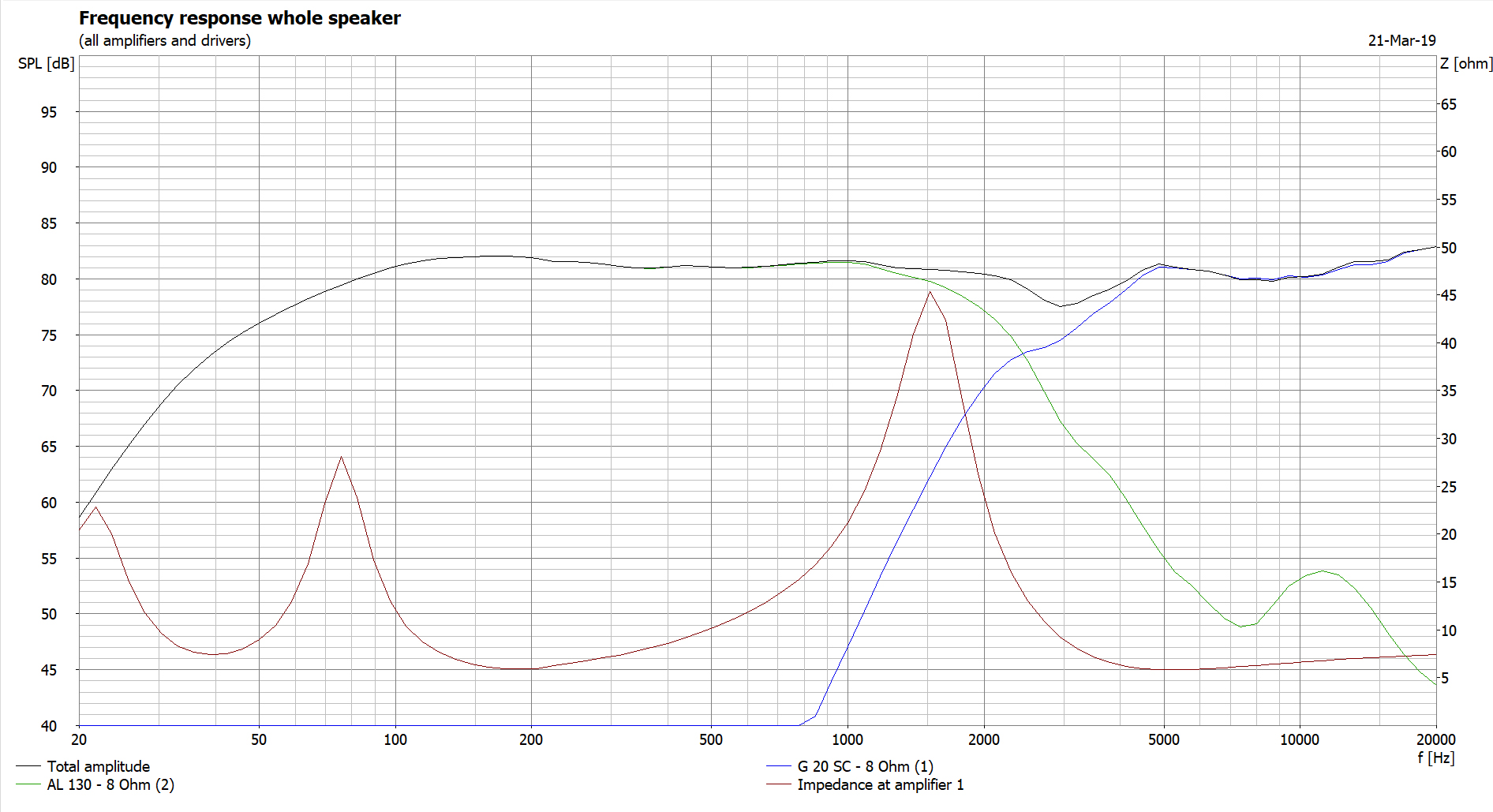

If memory serves the XO point on the design was somewhat higher than 2k... without a dip (though that may not be an issue anyway) and achieved 8-10dB attenuation at the tweeter Fs (1900 Hz)
Is it enough attenuation?
Probably not.
A variation of the forth order design in post #1 would be better to attenuate the output of the tweeter at Fs.
The woofer breakup is very audible without some notching elements.
The parallel LC on the woofer XO was critical in killing the breakup zing. I made my own 50uH inductor.
A decade or more later, and I have the same speakers, still need final finish coat of varnish.
Critically, now I run them via analogue 4th order filters, which null out the unwanted frequencies a lot better.
If you're stuck on a passive crossover implementation, I'd aim for a steeper order.
Btw what on earth is the 30 Ohm resistor for?
Oh, let me explain the 30ohm resistor.
It seems that Boxsim is somewhat inconsistent with its simulation at times. When I entered your original crossover, the frequency range had a huge bump in the midrange from about 500hz to 2300hz. Didn't seem right. So I added the 2mH inductor and that resistor to get a flat response in the midrange.
But as of now I've created a new project with the same drivers and the result is okay.
It's the same issue with my other Boxsim projects. If I've been tweaking the crossover for quite some time then the program starts acting weird. For one case I removed a notch filter but the slope stayed the same or I'd remove a Zobel and the impedance remains as low as it was. Its suspicious.
Creating a new project and adding the same crossover helps - kind of resets the whole thing.

Well I have experienced no such inconsistency, but I have only used v1.2, and not the recent update (so I can't speak for that vrraion)
In effect once L1 impedance is greater than 30 Ohms the resistor begins to bypass the inductor, and L2 takes over.

I found that running Boxsim at maximum data points for graphing helped reveal a lot (standard setup is rather smoothes due to low number of graphing points)
The rise 300-2k (+2dB) is present in my SIM also, I just nailed the response above that point so it was flat +/-2dB (at least in v1.2)
A lot depends on baffle dimensions - moving from a 30cm high 20l box to 1m high TL retaining baffle width constant makes for noticeable ripple, and change to the baffle step response. Shifting the tweeter 1cm from the centre line of the baffle also makes a huge difference. Some of these things just aren't clear unless the program is run with max resolution, when suddenly they appear.
