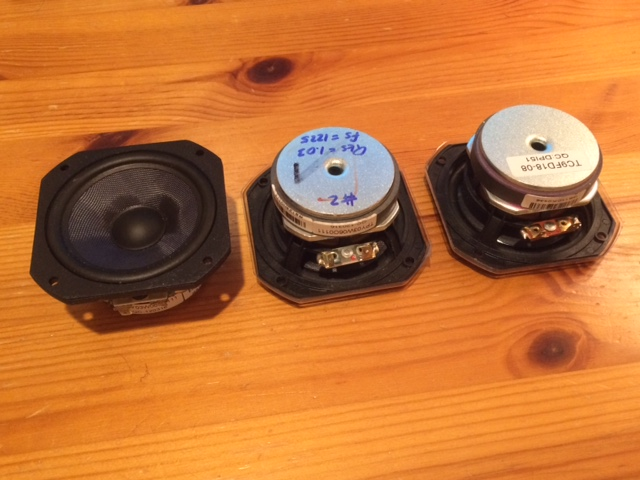

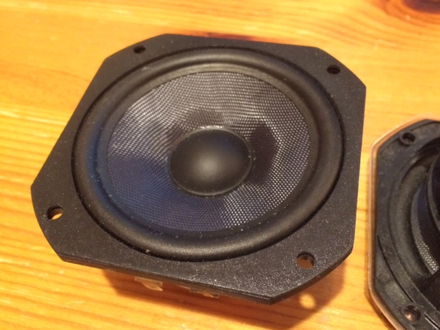

Here is a closeup photo - note the smooth rubbery finish on the bezel. It is a very nice smooth skinned foam rubber gasket that is a lot more attractive than the flimsy gaskets on the TC9FD. Plus it is airtight/watertight if you were to rear mount it to a frame:
Here is the front and back and a TC9FD on far right for comparison:

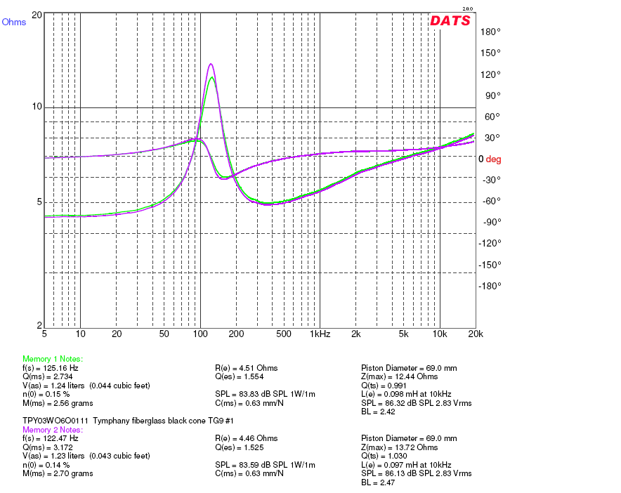

The TS parameters as measured by DATS v2 look reasonable and typical for a TC or TG9 with Qts about 1 and fs about 120Hz and Vas about 1.2 liters, and sensitivity of about 86db at 2.83v. the DC impedance is about 4.5ohms which implies it is more of a 6ohm driver rather than an 8ohm driver.

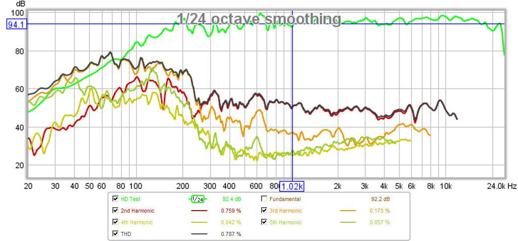

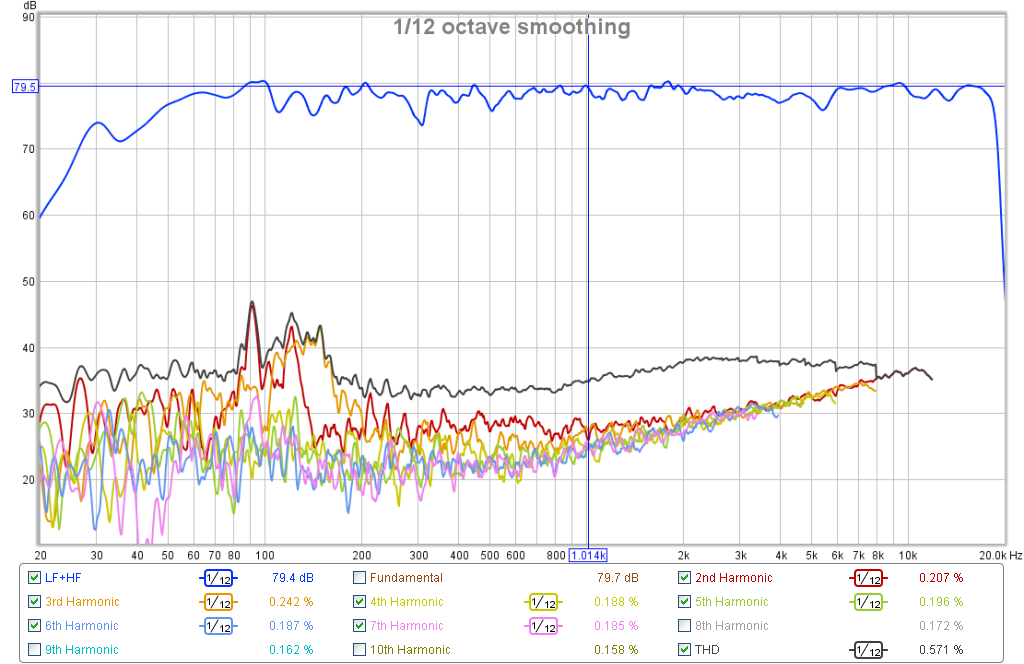

Here is the harmonic distortion stress test where I adjusted drive level to reach 96dB at 0.5m or equivalent 90dB at 1m:

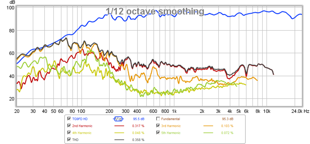

For comparison, here is HD of TG9FD at same drive level:

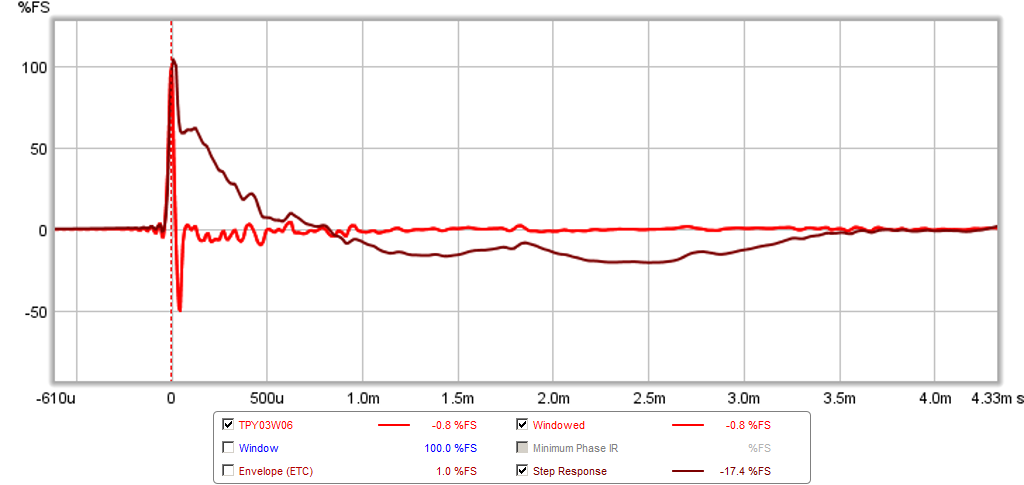

Here is the impulse and step response - quite clean and no ringing:

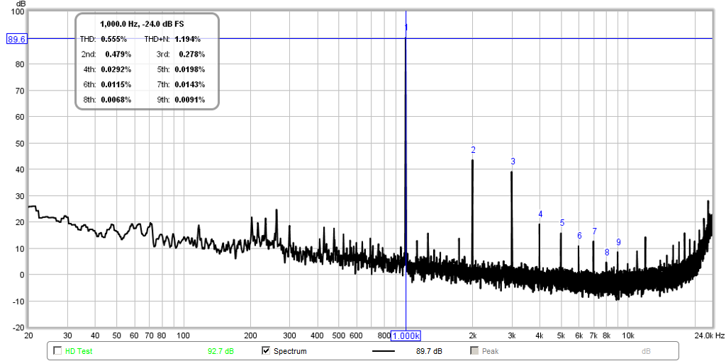

Here is the HD as measured with a 1kHz excitation in RTA mode at same drive level as above:
It sounds quite nice - in fact, almost identical to the TG9FD but with a little more harmonic distortion below 300Hz. If you use in a FAST with a >300Hz XO, you probably won't know the difference. Overall, a great sounding driver in my opinion. And I think these can be bought for $5 in India. If you happen to live there, you are in luck. It's a great driver, and a great deal.

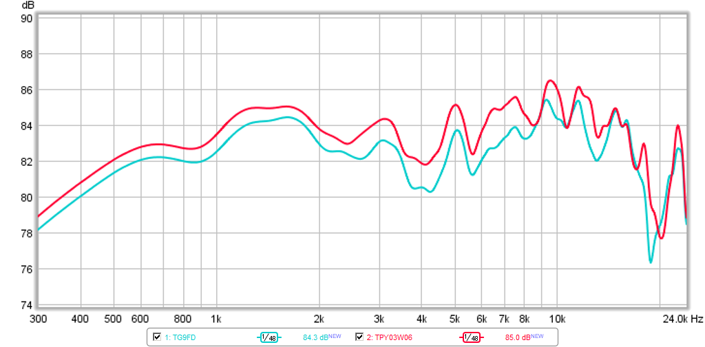

Here is the comparison with the TG9FD gated 0.5ms before and 5ms after and presented at 1/48th octave averaging, and 2dB/div vertical scale. Remarkably similar. The increased sensitivity is due to the 6ohm rating but about the same if normalized to 1 watt.
I opened up the upper end of the measurement to 24khz and we can see there is an ultrasonic breakup at 22kHz.

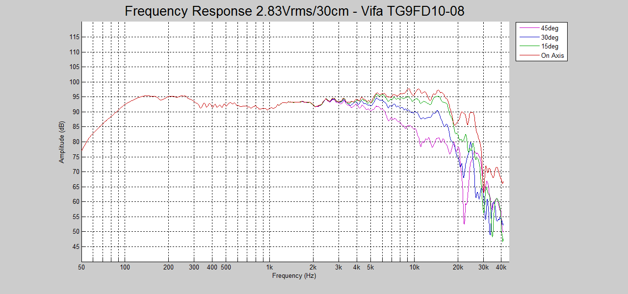

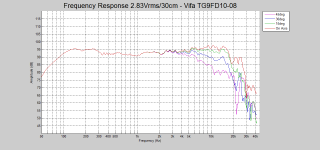

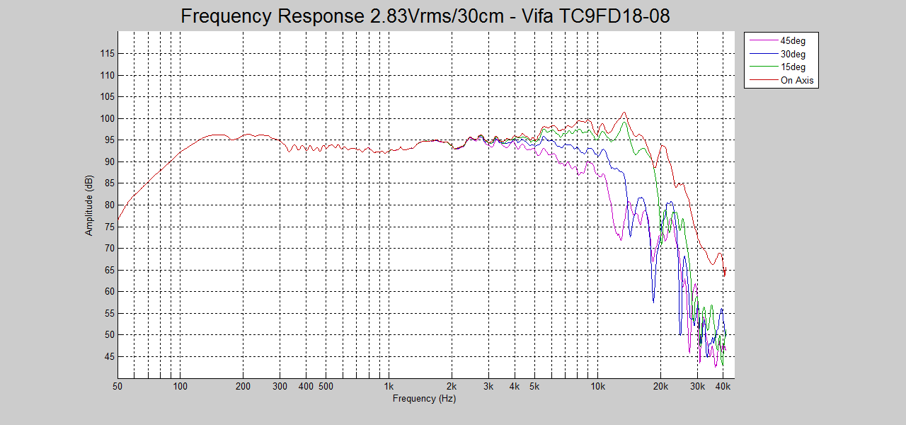

TC9 off axis measurements:
TG9 off axis measurements:
I'd say both these drivers follow the on axis response when measured at 15 degree very closely. I see no problem to apply EQ off axis within a 15 degree window. Nor did I measure a problem after applying EQ and measuring at different spots in the room. If the TG was that much better I would have ordered those in 2011 😉. I was very close to doing just that. But I'll admit I have a thing for paper cones. It wasn't the price difference that steered me that way.
The TG9 will have a bit more HF at 30 degree off axis after EQ. I expect the TYP03 will act very similar to the TG.

Actually I was referring to the 30 degrees off-axis response comparison between the TC9 and TG9. This is some difference indeed. Thanks for the graphs.
If the Kevlar coned BGS is a predictor of the behaviour than the TYP03 would mimic the TC9 more than the TG9 in the upper ranges at 30 degree off axis. Would be interesting to see if that difference is there between TG and Typ03.
But when would one be equalising the 30 degree off axis response? That happens only when there is no toe-in of the arrays. My toe in is between 15 and 20 degree, making the spot at the mic between 10-15 degree off axis. Outer drivers are more off axis to the microphone and thus more attenuated at higher frequencies (above 10K). At least that's how I looked at it. Pretty ideal if you ask me. That's why 15 degree was more important to me than 30, so it would have sort of natural shading for the outer drivers the higher in frequency one goes.
30 degrees is important from power response point of view or when playing for a large audience. Otherwise, almost everyone toes in; I listen to my arrays right on axis. A rising on-axis or 15deg response is actually good for an array given the HF attenuation.
The TYP03 has very good 30 degrees response as per my measurements. But then I can't compare it to some graphs of TC9 or TG9 from the internet given the difference in test methods. I can get the TC9 just for measurements sake but it retails for around $24 here.

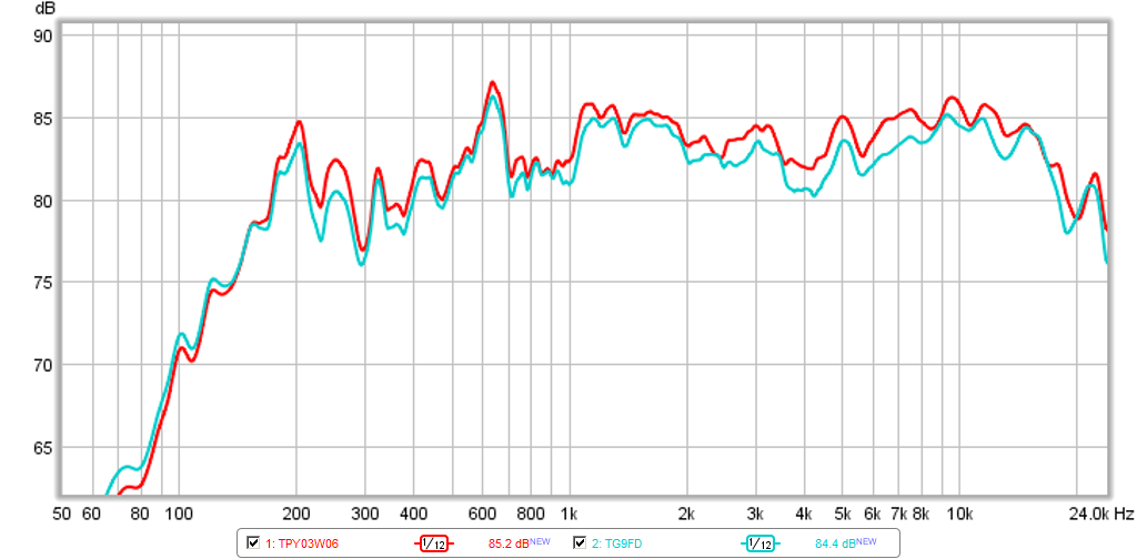

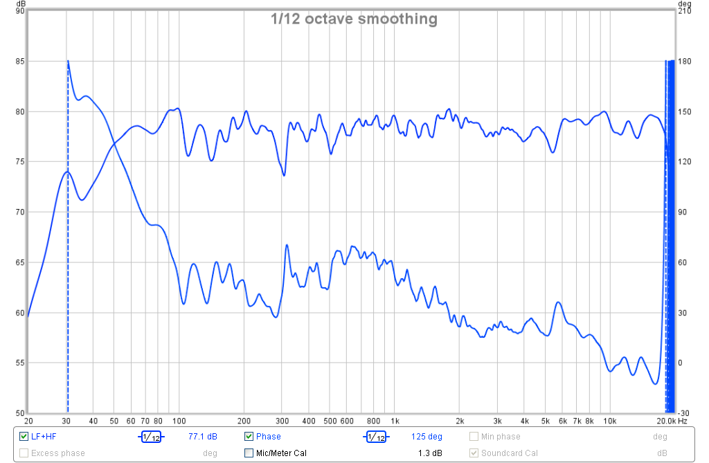

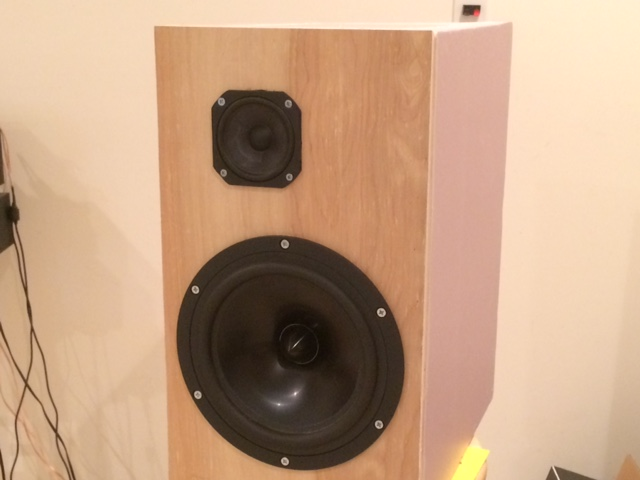

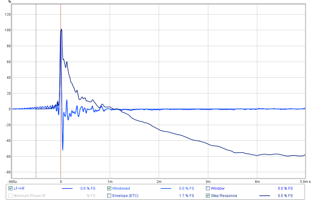

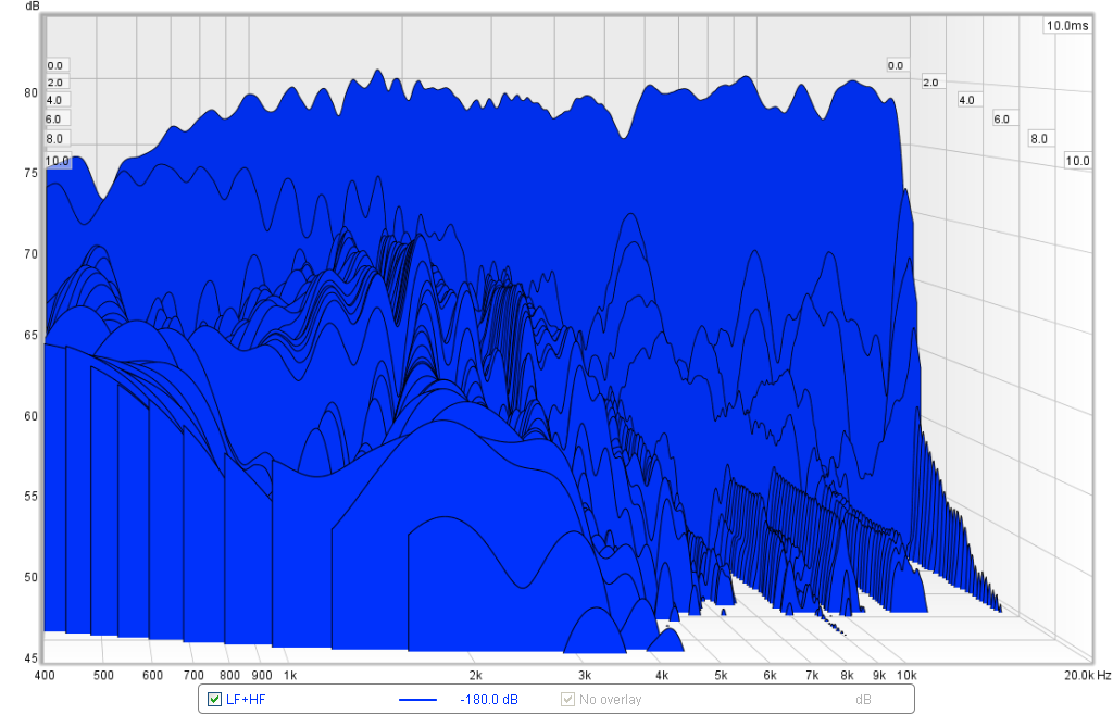

I installed this new driver in my RS225 FAST speaker normally where the ScanSpeak 10F resides. I redid the XO with to match a textbook 4th order LPF and 2nd order HPF by using a BW3 at 325Hz on the woofer and a BW1 at 500Hz on the full range to get a 500Hz acoustic Harsch XO. With minimal EQ, this driver is monitor flat. The sensitivity perfectly matches the RS225 (after baffle step) so no level matching required.

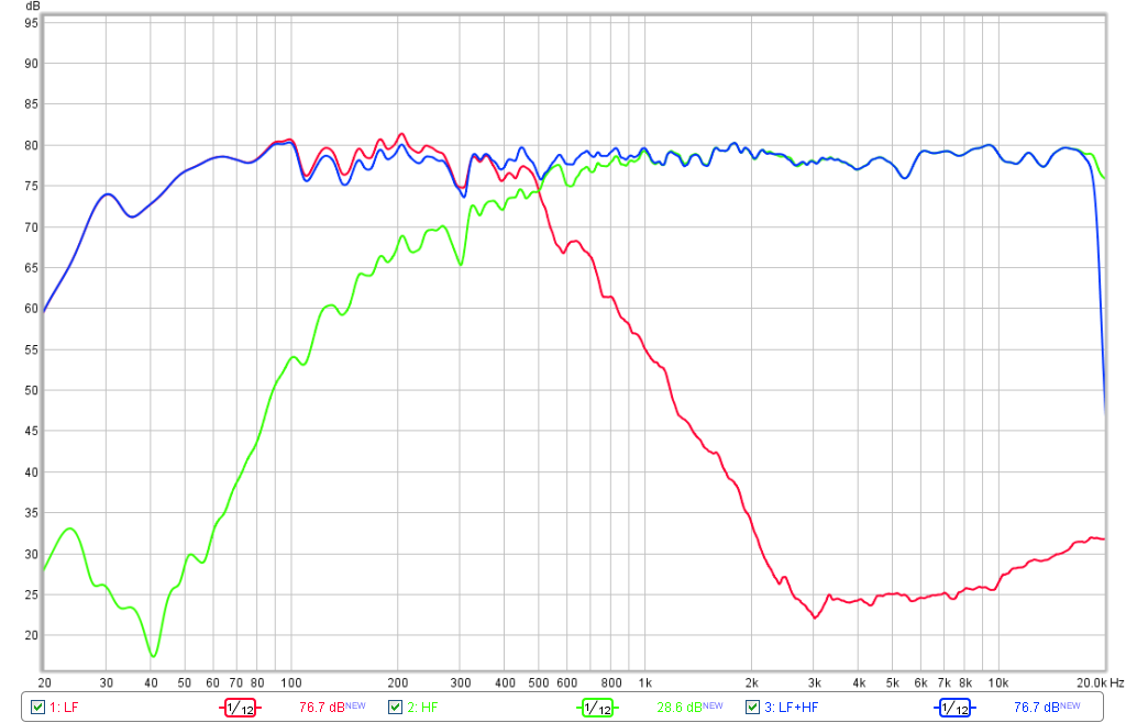

Here are the measurements.
XO (acoustic 500Hz):
Phase (+/- 30 deg variation over bandwidth):
Impulse/Step Response (typical quasi transient perfect Harsch):
HD (at low volume - I have a buzz/rattle in the cabinet, but fairly clean):

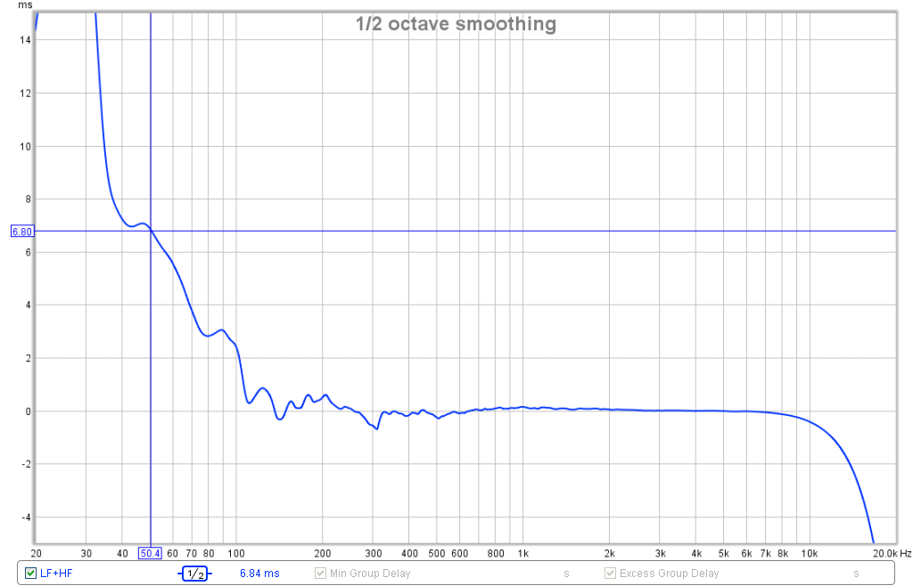

GD (under 6ms at 50Hz):

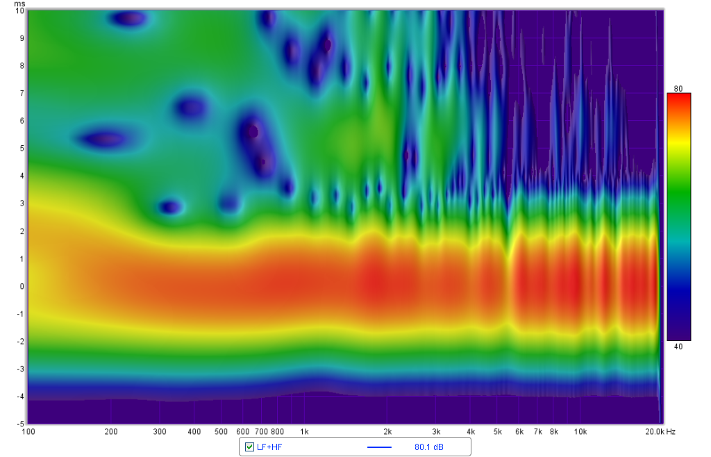

CSD:
Spectrogram:
It sounds excellent! If you can get your hands on these, they are a nice full range driver capable of hitting a good 20kHz.

CSD:
Spectrogram:
