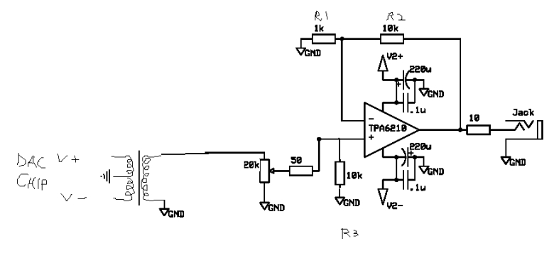

Minimaist approch, in a player...
I put this in my Sony dvp-ns900v.
Direct to the akm4383.
I pulled out all the chips on the analog board to free up power.
I used an old Tamradio 2400 ohm to 600 ohm xformer.
The sound is so good.
But the offset V comes close to 100mv as I get the linear pot about half way, loud! Over 200mv full turn.
The gain is r2/r1 + 1.
So 10.

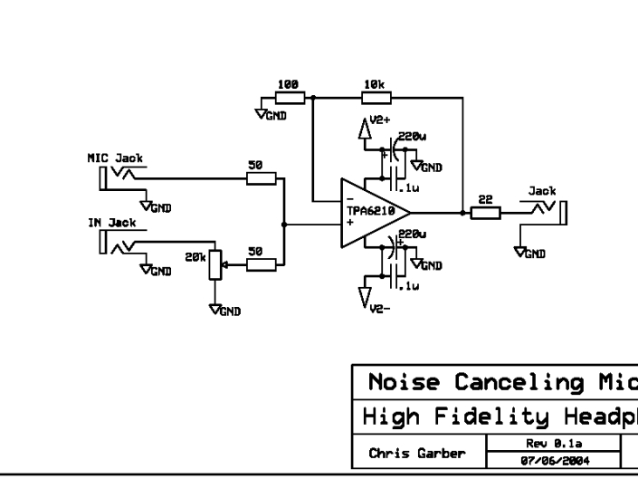

The second image I got off the net.
It shows a gain of 100.
I am tring to get an offset I can live with and still not use an input chip or buffer.
I want to next try another Tamradio that is 1 to 1 ( 600 ohms in and out) also CT in, SE out. Thereby reducing the gain needed.
It seems the offset is related to the gain.

quick question about this chip.
Is it safe to connect all the 10 NC pins to ground (and the powerpad)
neutron7:
I ground down the unused top and bottom end with a dremel tool. This was to get access to the ground connections that go to the power pad. These are visable on each end of the chip but they are reccesed.
I needed to do this because I epoxied the chip to a heat sink. I exposed the ground leads and made them the centre-point on me star ground.
I doing so I saw that the NC leads all run to the die but are not connected at that point. SO If you did ground the nc leads I think you would cause more net capacitance around the die and the touchie neg input lead.
What are you tring to do with the tpa?
BTW I assume this is a relabled ths6012 and it's appl data would apply. Can anyone can any one confirm this so I don't turn into something worse than a pumpkin.
Can anyone say (help) as to the best, lowest values for r1, r2 to get the offset lower. Im using 1k and 10k now. maybe 100 and 1k (gain of 11).
ALSO could I use a lower value pot? I am going to a 1 to 1 trans. so I could lower the gain to maybe 5.😕
