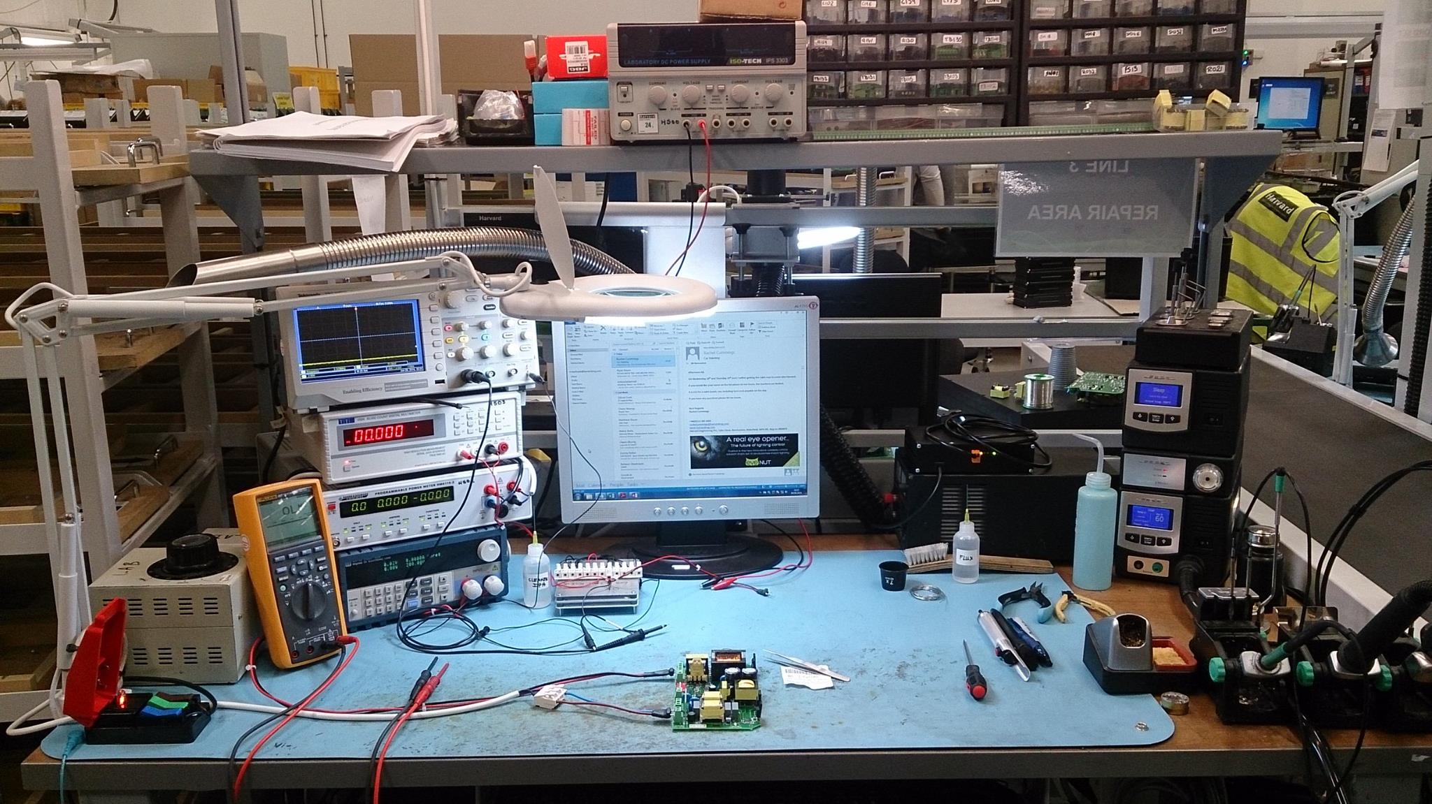

Smt isn't a problem if you look at my soldering stations 🙂
The breakout boards do look good, I would like to do something with them one day, like a "modular" amplifier, all boards are designed to fit each other and you can upgrade them stage by stage or PCB by PCB.

Aha, JBC irons, good ****!...Smt isn't a problem if you look at my soldering stations 🙂
JBC irons, the best I have used in my opinion.
