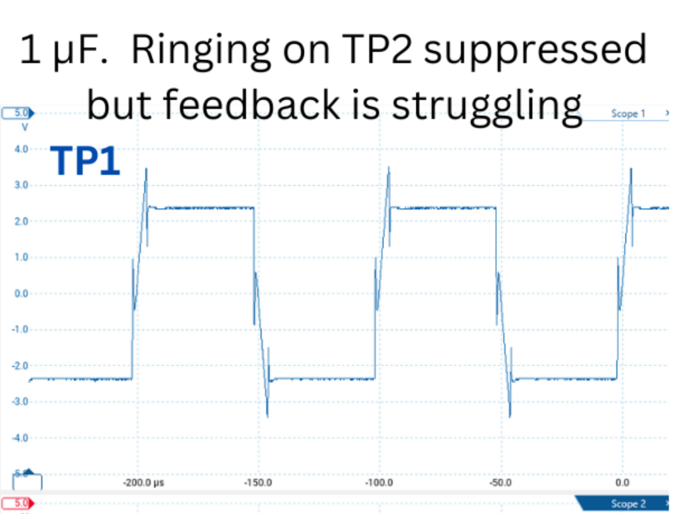

Finally, back to ferrite beads in the output with respect to capacitive load isolation. TPA6120 datasheet recommends output resistor (R5 in my schematic) to be at least 10 Ω to ensure stability. However, if a ferrite bead is added in parallel I found that it is beneficial to reduce the value of R5 because 10 Ω is not dumping enough the inductance of the bead to lower its resonant ringing with capacitive loads. Topping L30 has allegedly used 3.3 Ω (without any bead/inductor though) however they managed to include the resistor in the GNFB and had added a zobel. The 3.3 Ω value concurred with my simulator as the lowest permissible before oscillations would begin on fast transients even with small capacitive loads. I stopped at 4.7 Ω. Experimentally, I found that another dumping resistor R6 of 0.5 Ω in series with the bead is good to have. Not strictly necessary but it decreased the ringing further on higher capacitive loads. Here come scope shots with 10 kHz squarewave into 33 Ω load resistor in parallel with capacitors from 0 to 100 nF. It is very stretched IMO, I consider anything above 10 nF being rather unlikely in the headphones' world, but I will readily admit my ignorance here. As with IMD measurements, TP1 shows capture before the bead, TP2 - after. All measurements here without the input RFI blocking capacitor C1.
For the sake of experiment only here is also a 10 kHz squarewave with 1 μF load - a highly improbable case. Wave form on the right side shows wild (but well damped) ringing in case of insufficient damping R5 = 10 Ω and R6 = 0. The loop remains stable although TP1 wave form is looking ugly. The bead does its isolation job well!

Seems to me what’s happening here is the system is slew limiting on the very fast rise fall times, and then the loop recovers so you then get an overshoot halfway up or down. The loop then recovers, and overshoots again at the top and bottom of the flat parts. Given the x time base (50us per division if I am reading this correctly), I’d say this is begging for some improved compensation. You could try removing C3 and then placing a 50-100pF capacitor from the output of U1 to its inverting input.
Ultra wide bandwidths and ultra fast rise/fall times almost always lead to problems and suboptimal sound. Keep rise fall times to no faster than 2-3 us and amplifier bandwidths to not more than 250-300 kHz - this latter limit merely to ensure the audio bandwidth is not out by more than 0.1 dB at 20 kHz. Keep in mind almost all digital material nowadays is brick wall filtered at a shade over 20 kHz and yet still sounds superb.
@Bonsai thank you so much for your considerations. Valuable as always.
I admit I have pushed the BW too much to about 1.2 MHz (note - this is without RFI cap C1). I had tried to put a cap from U1 output back to the inverting input as you suggest. That did not work well as I got notable overshoots in square wave response even with purely resistive loading. It took 100 pF cap and gain increase to x5 to get rid of the overshoots. The response to higher capacitive loading (1 μF) remained the same as in my own version. And in terms of BW I ended up in the same ballpark, too.
Here is something I have arrived at following your advice on sensible BW while still maintaining my goal for overall gain x2:
I changed two things - increased C3 to 1 nF and added R7 1k. R7 appears to play an important BW limiting role, as well as the volume pot. With values shown and volume pot at max the new BW (again, without RFI cap C1) is ca. 230 kHz. ULGF drops from 3.5 Mhz to 2.8 Mhz but I only lose a fraction of a dB from LG @ 20 kHz. All good. I consider negligible the added resistor noise. The nastiness of square wave response with 1 μF load is greatly reduced, and of course response with all lower load capacitances improves too. With the volume pot position of 80% or lower, the square wave response at TP1 becomes clean even with 1 μF load albeit with rounded edges as BW shrinks to ca 140 kHz in the worst case when vol.pot is at ~50%.
Is the new BW not too low now given this response is without the C1 at the input? I suspect it may be and I have overcompensated. Regardless of the BW drop to 140 kHz the increase of gain magnitude variation in the audio band is tolerable as it still remains just below 0.1 dB. So, no issues here. Phase response linearity is suffering more with -5.5° at 20 kHz vs 1 kHz. Should I be concerned?
This is where I am now in my thinking. But I need to think some more before I open the amp box for rework anyway. One more question I have is - how to properly split the BW limitation between the RFI input cap C1 and the following composite stage? From better HP amp designs I have seen that C1 is sized to provide major contribution to BW limitation to the mentioned overall 200-300 kHz range letting the amplifier stage itself be BW limited at much higher level somewhere between 600-800 kHz.
I will very much appreciate also any other comments.
