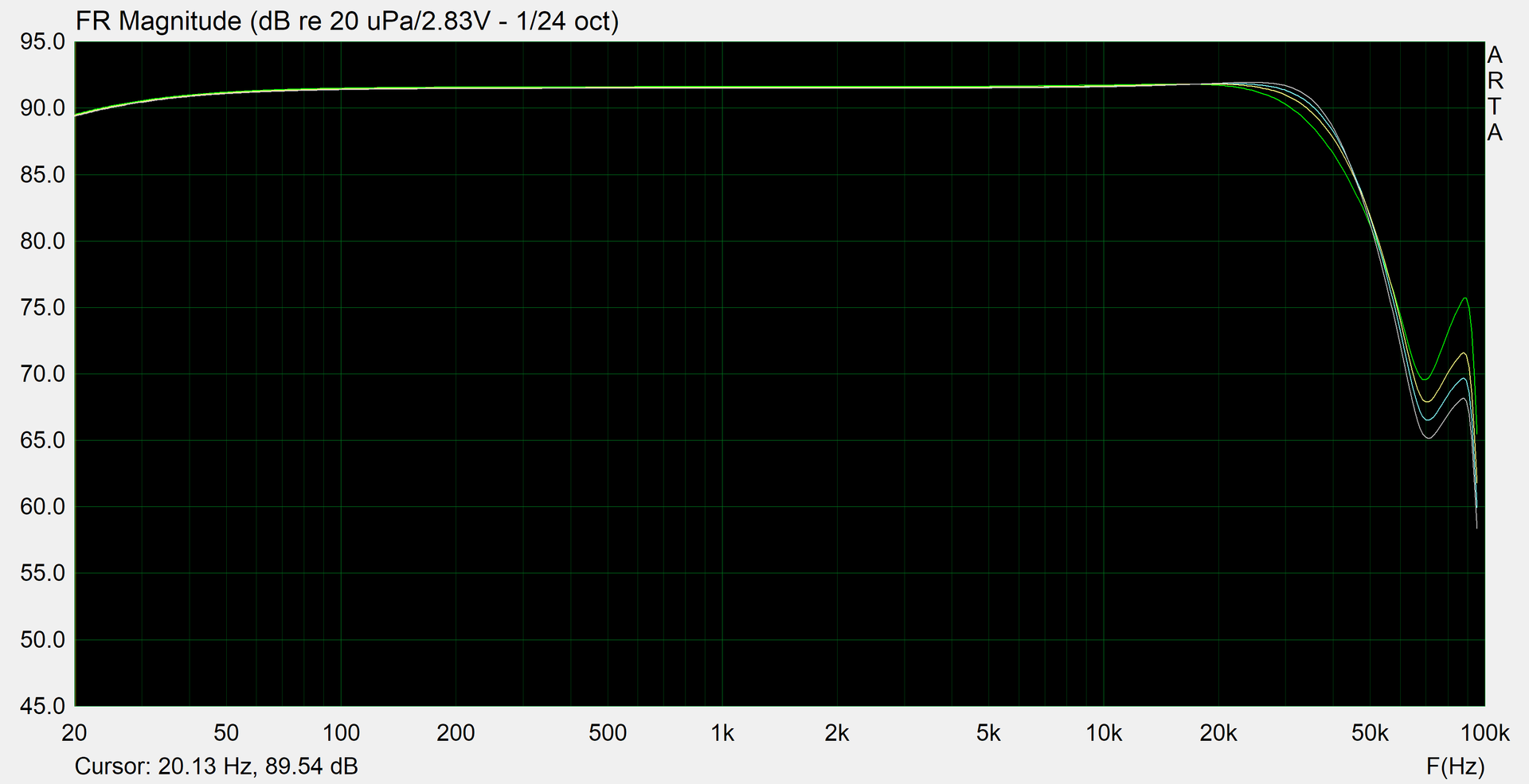

Over the years I've seen it mentioned a couple of times that one could go composite with the TPA325x using an ncore style integrator only I'd never seen it actually done. Now my main amplifiers, for my active speakers, have been based on a PFFB implementation of the TPA3251. The performance is more than acceptable but I'd always wanted to try and go that bit further so figured I'd give the integrator a go. It wasn't my plan for this to coincide with the chips ten year anniversary but there you go.
As you can imagine it took a considerable amount of trial and error, plus simulation time, to get things working correctly. This is especially so as there are no models provided for any of the TPA325x series so everything required a large dose of guestimation.
4 layer PCB from China with the TPA mounted on the bottom side of the board. The PCB being bolted to a bar of aluminium to get the heat out. The bar then being bolted to a case panel once 6 channels have been built.
So some performance graphs.
First up frequency response into no load, 9.4 ohms, 4.7 ohms, and 2.35 ohms.

Anyone who is familiar with the TPA325x will immediately notice the significant improvement in high frequency distortion. The main area the TPA325x has issues is at the high frequencies. I'm assuming that, for stability, TI needed to start compensating the amplifier pretty low down in frequency as can be seen from distortion Vs frequency sweeps of the standard implementation.
Here's the datasheet distortion at 80kHz bandwidth.
At higher power levels it can be seen that the distortion starts to rise as low as 100Hz! The composite version completely does away with that and reduces the overall magnitude significantly. So happy 10th year TPA325x and enjoy some higher performance.

As to the clipping of the TPA325x composite. The usual ncore clipping detector and limiter is used although I haven't tried to really fine tune things. Nothing, so far, has blown up. The TPA325x amps are very good at shutting themselves down if anything untoward happens, and that happened a lot when trying to get this stable. The window of stability being quite narrow. Not enough feedback and you oscillate, too much feedback and you also oscillate. You need to find the Goldilocks zone of stability. One nice thing about the TPA chips is they have a clipping detector so should it be necessary you can shut the amplifier down at the onset of clipping.
