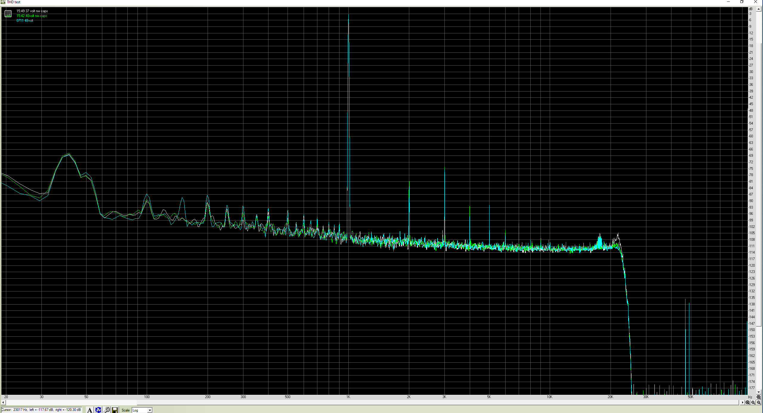

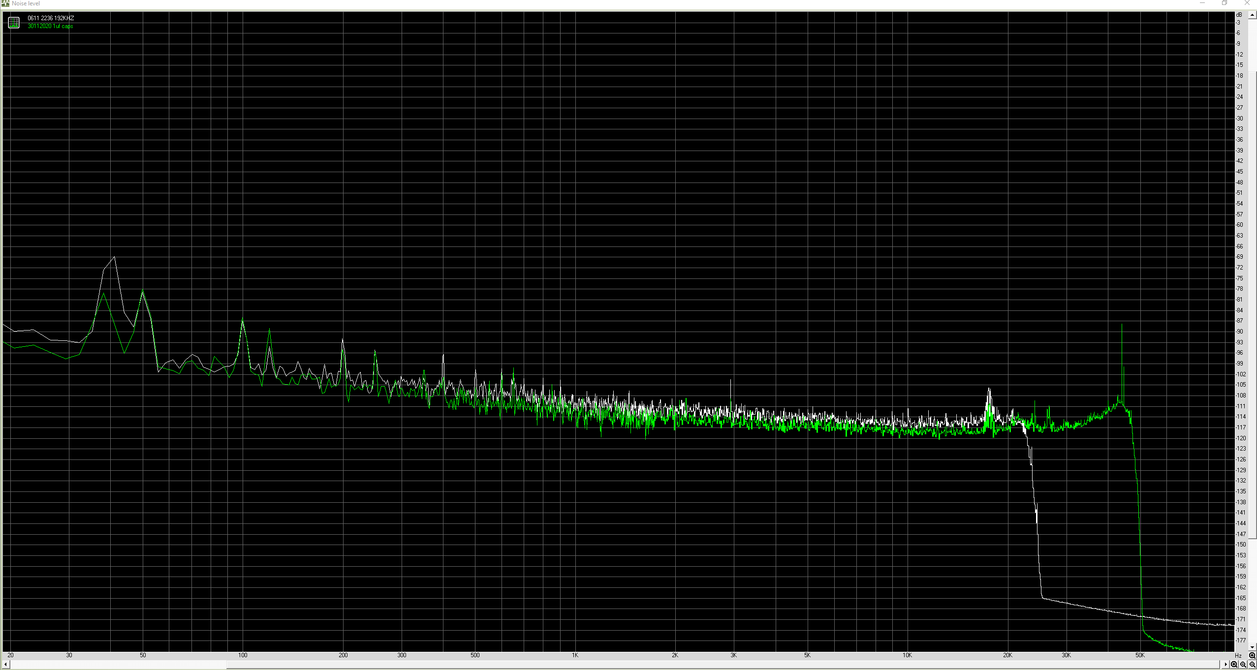

I have this board. I changed nearly everything (accept the part you mention) and measured the difference with Rightmark audio analyser. Always the same setup cables etc.
Here you can see the difference (see voltage test)
Changing the caps before the opamps, the large caps and the coils for better quality gives you this difference. White line is original the green line with all mods.
It is fun to do and you learn to understand what does what in audio electronics
