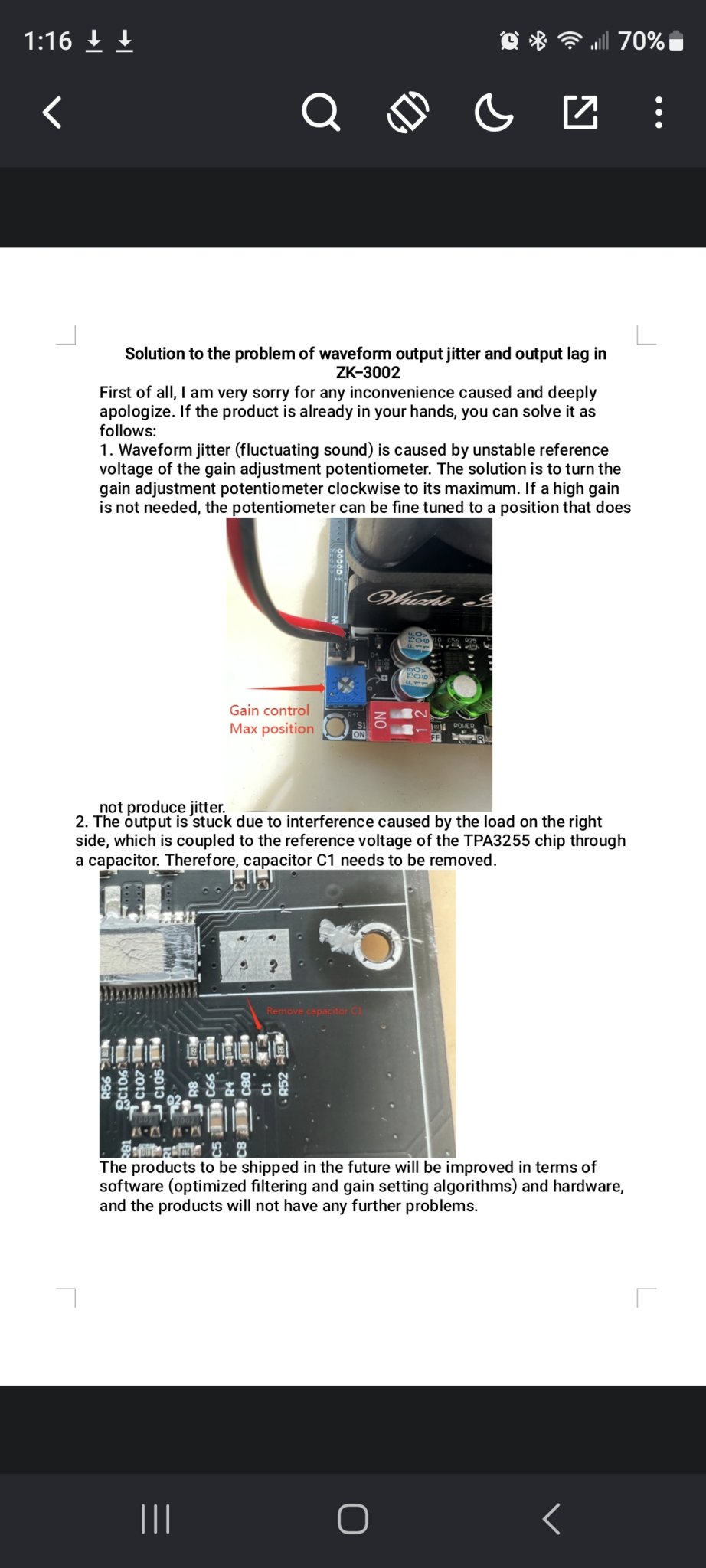

Remove the c1 capacitor from the board.....
I did and it worked for 2 days and now I have no output to either channel. Searching around I found dozens of threads about the tpa3255 having issues especially with channels c and d. It's a very tempermental chip and requires a perfect layout of your circuit. I'll stay away from them in the future.
Sorry to hear that, the article i send you is directly from Wuzhi it shelf. I use 2 variant of tpa3255 amp (aiyima A07 and Fosi M03) with caps mod and they works perfectly fine for my HT till now...just buy this wuzhi zk-3002 for my tactile transducer because they have active fan and can works up to 48v (aiyima and fosi can only up to 36v), so i think its not the TPA3255 fault afterall, but the board maker (wuzhi)....
edit: are you use this amp in stereo or mono mode? i dont trust PBTL mode in this board anyway...its just to damn simple, maybe better to pick Fosi M03 if you plan to play in PBTL mode (I use it for center channel)
I picked the Wuzhi to try because it is one of the few that can do BTL and PBTL easily with just changing a switch. I also have 2 other Wuzhi amps already that have been working almost daily for 2+ years. One of them is a 100w x2 and powers 4 8" ceiling mounted speakers in a enclosed porch. It's disappointing that they screwed the design up on the zk-3002 so badly and are still selling it everywhere. I did a little investigating last night and the reset, fault, and clip pins all are showing around 600ma so I'm pretty sure the chip fried and I have no idea why. I think I'll try a tpa3255 variant from Sure/Wondom or Dayton audio.
