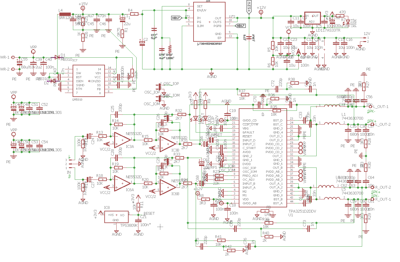

Hi all,
I am trying to redesign/make a TPA3251 amplifier with good components.
Most of you must already know that the PFFB approach has better results for all parameters, than a standard configuration according to TI's "slaa778" document.

There seems a problem occours when you use PFFB topology according to this document!
The total gain reduces to 12.75 dB (x4.34) in this case, which is fairly low !
You may say, "so drive it with a pre, or increase the front end stage's gain".
But according to TPA3251's datasheet, maximum input swing is limited to 7Vpp..
So if we apply 7Vpp = 2,48Vrms to inputs then the output power will be just 29W@4R, if you consider the total gain of amplifier.
And this is the limit value, you cannot reach the 2,48v level in any case.
So what do you think about that?
Isn't there any way to make a powerfull amplifier with PFFB topology?

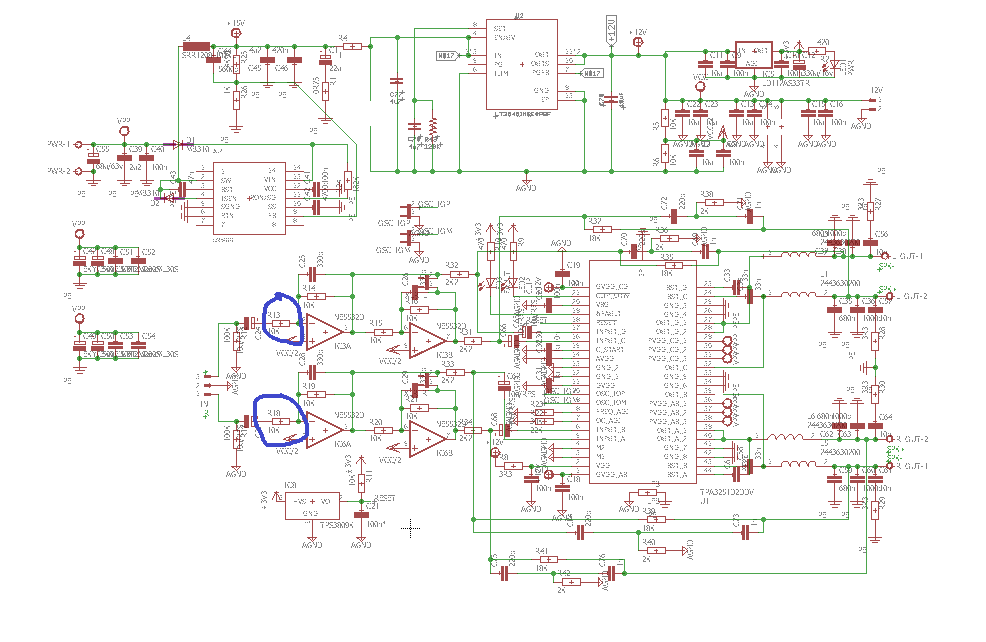

This is my application circuit (sorry for a bit "crowded" drawing..)
I'll change the input (R13&R18) resistors value to 4K7 etc..

The sch is wrong for input A and B. Out B is not connected.
Thanks a lot for warning.. I'll fix it.I agree with you. 🙂
