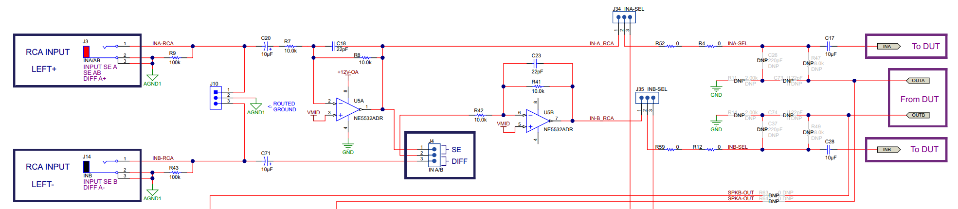

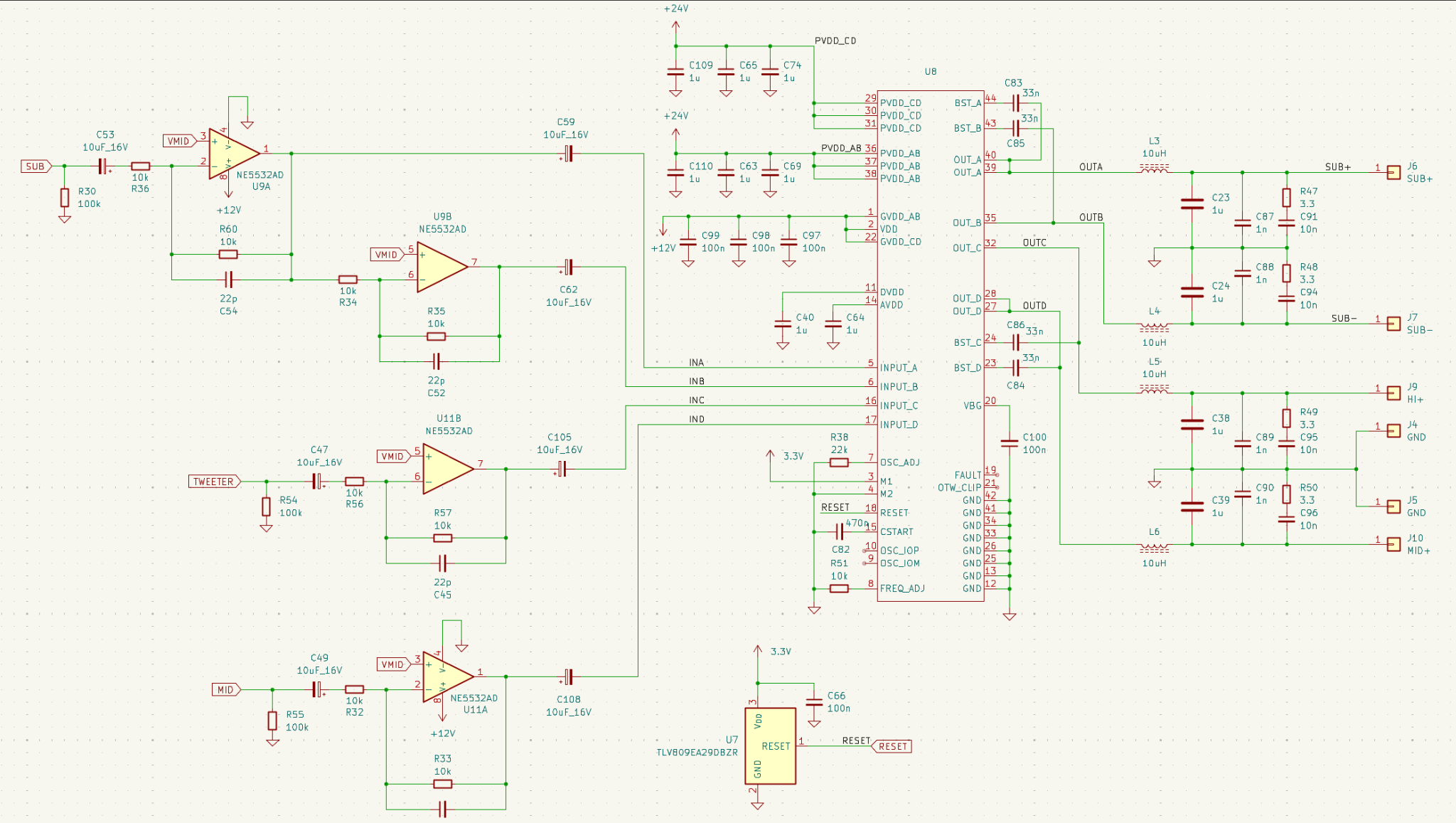

I'm building a TPA3251 based board with 3 outputs (1xBTL + 2xSE) and I'm not sure if I designed the input correctly. I followed the EVM documentation but I would like a second opinion.
2.2 BTL MODE (Three-Speaker Output)
OUTC and OUTD are the SE output channels and OUTA and OUTB are the BTL channels for 2.1operations. OUTC and OUTD can only be in DIFF input mode.
Schematic of the EVM module:
My design:
