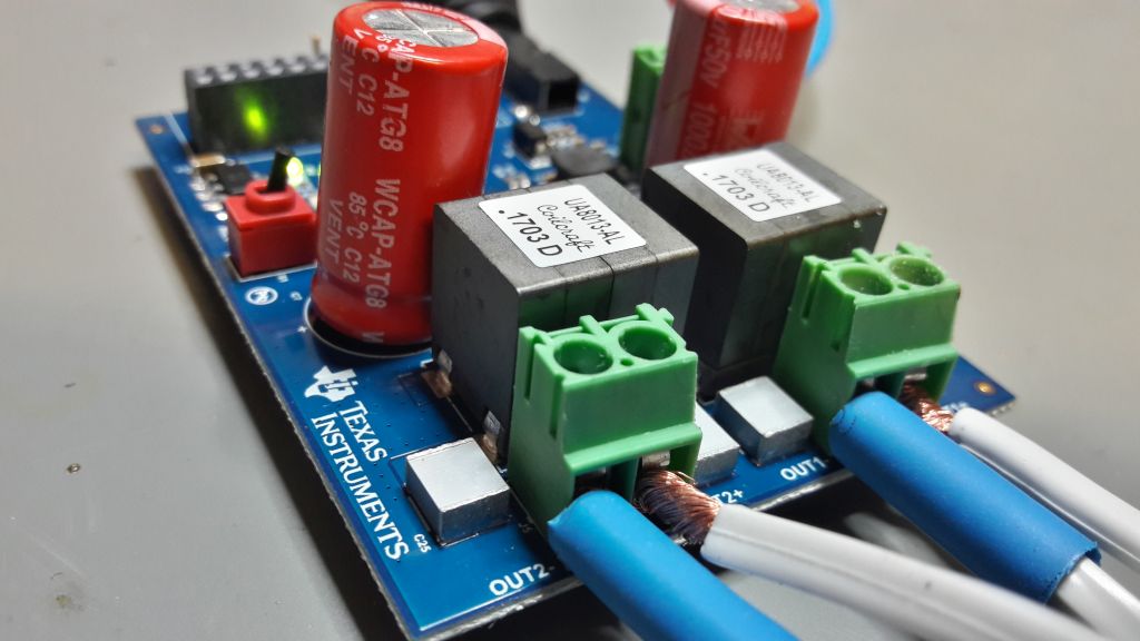

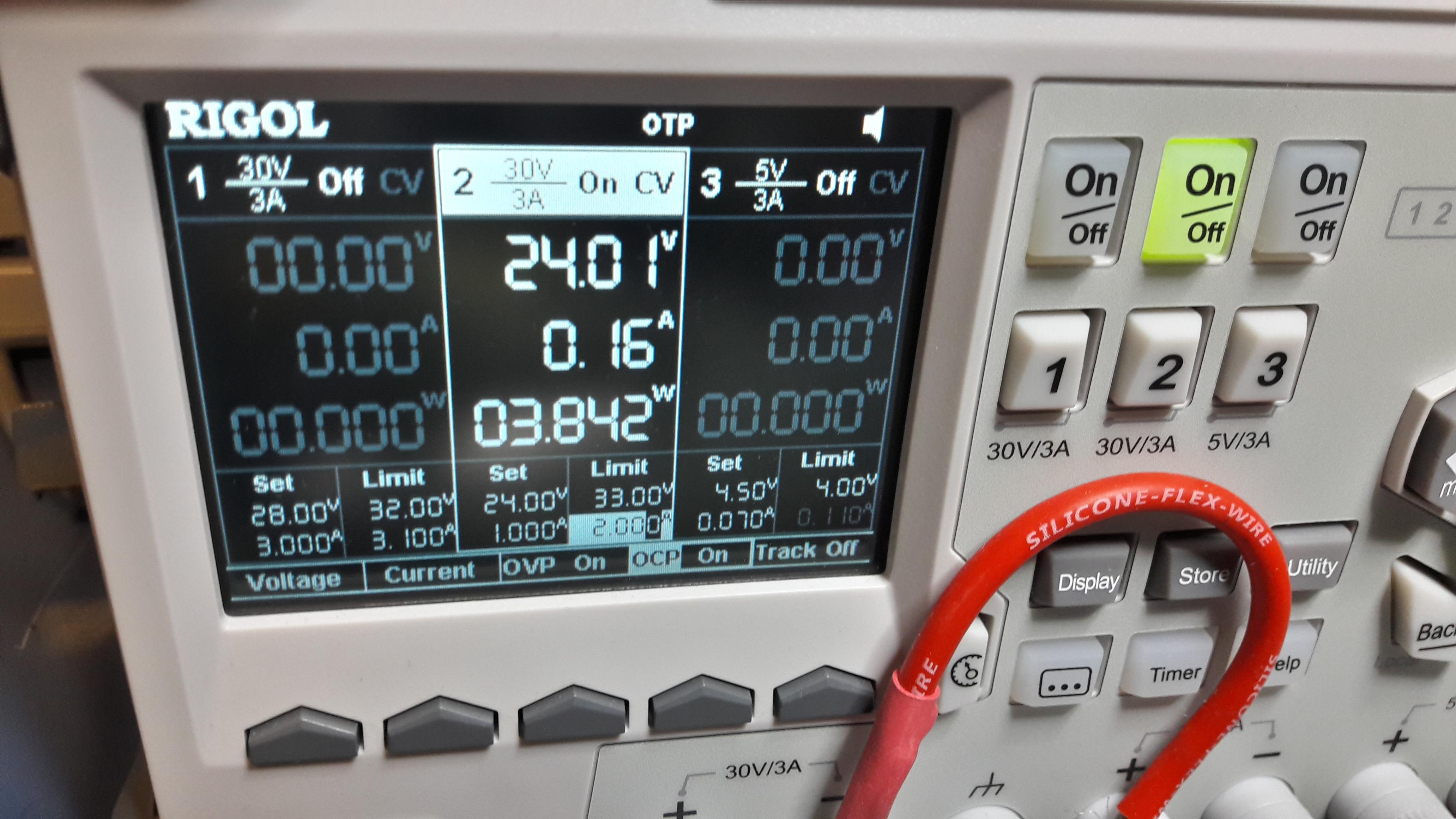

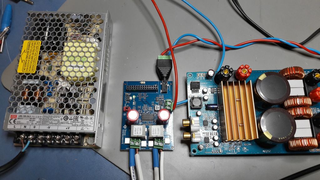

Hi
Thanks to TI and Fedex the board arrived today. i connected and powered it up and its works...😀
i use my DP832 rigol with 24V set.
if i power it no current was shown on the psu display..😉reset switch off and 160mA run at 100mVrms through the amp into 8R i get 9,8Vpp ---> so Gain is 30dB...as written in Datasheet.
i bought for listening this 7 euro cable:
Cinch auf Klinke Kabel 2M,Victeck 3.5mm Klinke auf 2 Cinch Y Splitter Stereo Audio Kabel, Nylon Geflochten Klinkenkabel,Vergoldet Metall Stecker: Amazon.de: Elektronik
since 3 hours this amp is running at 24 into 8R with sweep of 100mVrms 10Hz-35kHz. room is 24°C this amps stay at 34°..
power:
about 10Vpp into 8R i got about 1,5Watt per channel...fine😀
its really very tiny...to connect my fat test cables...😀
to fix this amp board in a housing or fix for test...no idea..😱
chris

I just fired up my board which arrived a couple of days ago. Initial impressions - too shouty on orchestral violins and massed vocals. Turns out there's a very simple fix for this though - increasing the value of C19 (which is a 100nF, decoupling the analog signal rail). I have 1800uF/6.3V in parallel there now, no idea how much overkill it is but it sweetens up the top end magnificently 😀
