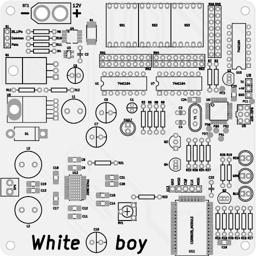

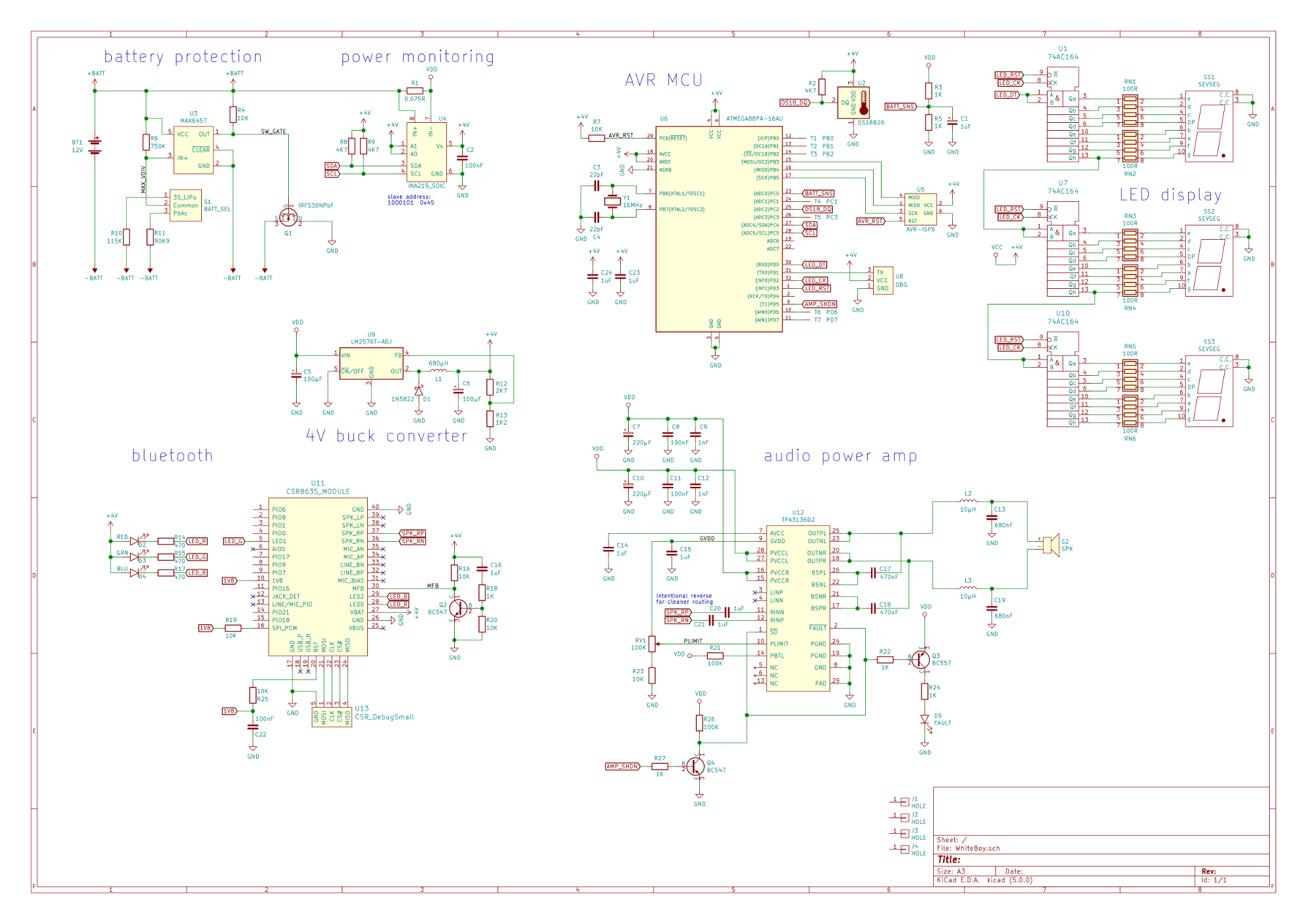

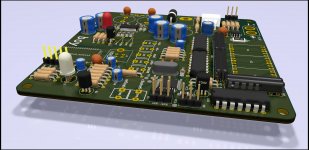

I have finished the first version of the schematic and the PCB. The PCB is a very rough prototype with crude layout, it will need more work. I should receive the boards in the next week or so. Can't wait...
I plan to assemble and test the prototype and maybe make a final PCB version with the bigger problems ironed out. I am sure I will have a few problems because I rushed the PCB layout a little.
This will be the first white PCB I ordered, so decided to call it White boy 😛
I will post more details in the next few days while I wait for the PCB. Meanwhile, you can check the project out on GitHub and open it with KiCAD v5: NovaBox and WhiteBoy
The schematic PDF: https://github.com/nodep/NovaBox/raw/master/docs/WhiteBoy.pdf

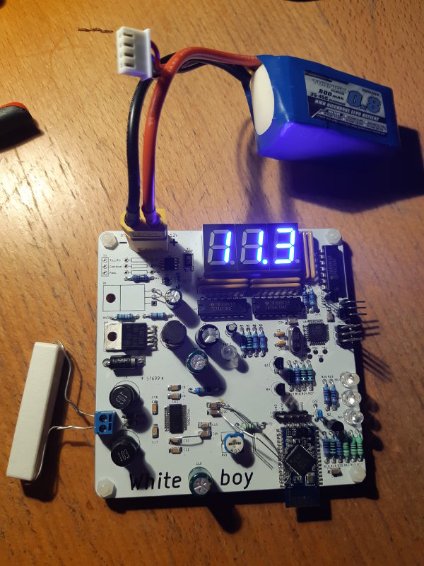

I've got the PCBs! Yay! 😀
I've assembled the first prototype, and of course, there are bugs a-plenty. The biggest one is that I didn't connect the amp's AVCC to power 🙁 I've just connected the decoupling 1uF cap between AVCC and GND but it has nothing to decouple. A botch wire fixes this.
The second problem is that I've miscalculated the resistors for the battery protection voltage divider, so that instead of cutting the power off at 11.2V it cuts it off at 10.4V. I've selected the wrong threshold voltage for the chip I got 🙁 Not too big of a problem.
Then I've messed up soldering the AVR. I've started soldering it but then noticed it is slightly misaligned, and when I tried to move it I lifted a few traces off of the PCB. But, I've managed to fix that.
And btw, white soldermask kinda sucks. It sure looks nice, but it peels off too easily if heated up. Or maybe this was just a bad batch?

After a few more cut traces, botch wires and facepal moments, things are (mostly) working. 😛 The circuit sounds decent, but it is quieter than I expected. I guess 20W is not as loud as I thought. I might try to change the power supply and increase the voltage to 16V just to see what happens. Maybe it will release the magic smoke...

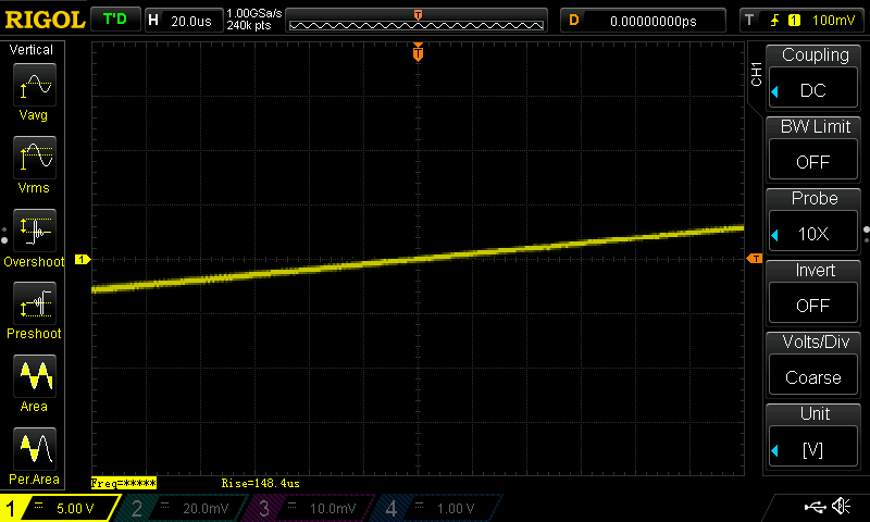

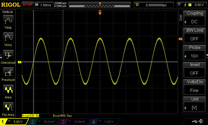

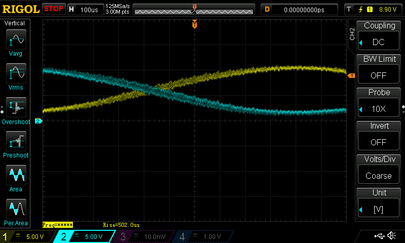

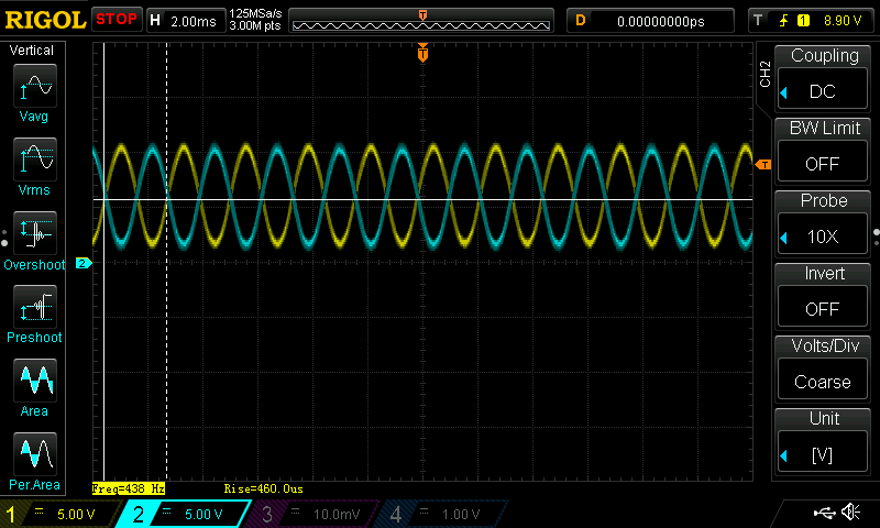

The chip is barely heating up. It is lukewarm after playing a 440Hz sine for a few minutes at just below clipping. This bottom pad soldering really does wonders.
I have a 4.7 Ohm 10W resistor as a dummy load, and I am playing the 440Hz sine wave into the load. The first three measurements are created with the ground clip and probe connected across the dummy load:

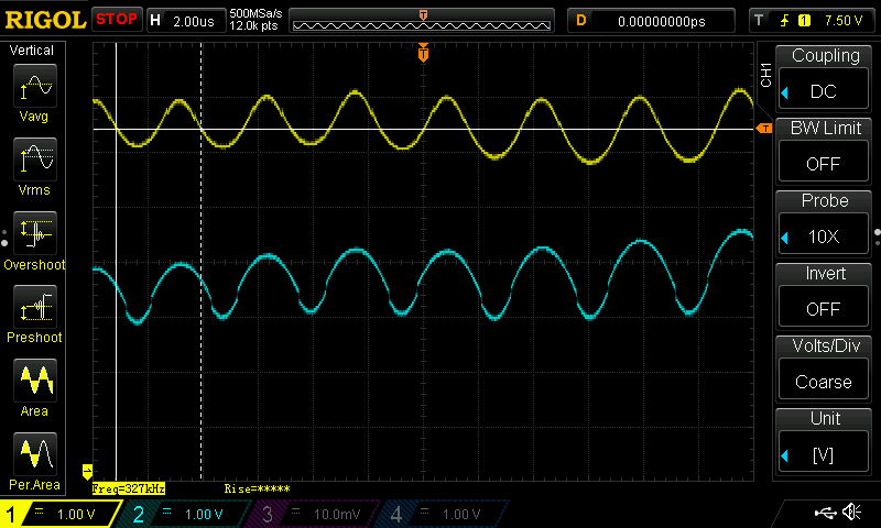

I guess this is nice, but things get a little more complicated when I connect the oscilloscope ground clip to my circuit ground, and two probes to the speaker outputs:
That 1.2V peak2peak noise is clearly the Class D switching frequency, and it is in phase which is why I didn't see it in the first batch, but this is where I need help: How can I figure out what is causing this? Is this even a problem?
I have unshielded coils and a 680nF 50V X7R capacitors at the output. Could that have something to do with this?

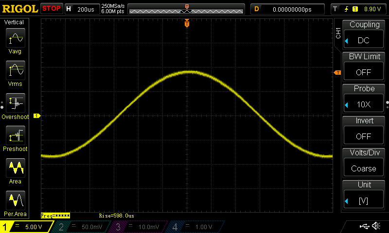

I have tried waves with lower frequencies (down to 55Hz) and the output looks similar to the 440Hz. I have not tried to go above 440Hz yet, I ran out of time, but I will check that too.
What else can I test? I don't have a spectrum analyzer, but I might try the FFT of my oscilloscope.
Thanks for reading and thanks for any help or comments!

The 2nd order LC output filter reduces the carrier frequency, it does not eliminate it. 400KHz sent to the speaker cables will further reduce the content and the remains will not disturb your speakers. Not even your dog will be aware.
Oh, I know I can't hear it, and judging by the first measurement (the first three captures in my previous post) I am not really releasing anything other than the 440Hz sine wave into the speaker. But I can measure the switching noise between my ground and either of the speaker terminals. That is what the last three captures show. That noise is in phase with respect to the two speaker terminals so it cancels out.
What I want to know if I can do anything about that? I am guessing beefier power decoupling capacitors might help, but I didn't have time to check that yet. I currently have two 220uF low ESR caps on the power, I will try to double it.

My understanding is, having that carrier frequency on your output "shouldn't" have any audible impact. You mainly want to be a "good EMI citizen" and not pollute the environment with electromagnetic noise. With sufficiently short speaker cables, you naturally become less of a polluter. Ferrite bead + cap also has the advantage of being smaller (save PCB space) and cheaper.
On the other hand, you can add further filtering. Take a look at the tpa3116 datasheet, specifically page 26: the "Typical Application" Schematic (Figure 37). You can see that TI has the standard LC filter, but also a 1nF C to ground and 3R3+10nF RC filter, too. Most of TI's higher-powered class D amp chips have the extra filtering in the reference implementation circuit.
Another thing to think about, you probably already know this, but in case not: that LC filter is actually an LCR filter, where the "R" is your speaker. That's why the L & C values change depending on speaker impedance. But rarely (ever?) do speakers have a flat impedance curve, i.e. impedance is different at different frequencies. So when you decide on an "R" value for your speaker, you should think about what frequency you reference.
There are quite a few threads here talking about class D output filters. Here's one that's fairly short and readable: Some rambling calculation on TPA3116/8 filters.

I tried feeding 16.8V to my amp. I didn't work. 🙁 I am guessing it went into overvoltage protection because it would not turn on. It woke up for a moment when the voltage started dropping when I plugged out the battery. I don't have a bench power supply (any recomendations for a physically small one? less that 300EUR?), so I can't say exactly what is the overvoltage limit. I had to discharge my battery in steps to figure out at what voltage the amp starts to work. But it was somewhere between 15.5V and 15.8V
The INA219 power meter seems to work nice 🙂 It measures battery voltage, average power consumption (in Watts), and total energy consumption (in Watt/hour). I was really surprised at how little power is drawn on average when it plays music. With supply voltage at 15.5V, and volume set around clipping, the average power consumption is about 3W. This seems so low, that it is possible I might be missing something. But the same circuit is reporting 20-22W of power draw for my test 440Hz sine wave at the same volume, which should be correct. So I guess the conclusion is that music is not a test sine wave, after all. 🙂 I just didn't think the difference would be so large. The way I configured it, INA219 is sampling the power consumption every 0.5ms, then averaging that over 128 samples, and reporting that average every 68.1ms to the microcontroller. I might try less averaging, but I don't think that should matter much.
