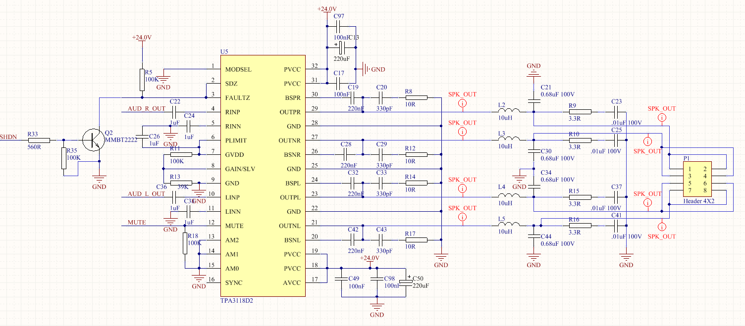

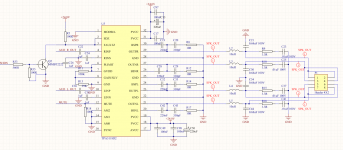

I followed the reference design. But don't know why the circuit is not working. Can you put your opinion why the design is not working ?
When I power up the circuits, R12 (10 ohms) is getting very hot and starts smoking and the whole circuits take almost 1.1 Amp without any load.

There's no other way for current to flow through R12 except through C29, unless you've got something shorted or messed up with your layout.
I further investigated and didn't find any short in the layout. and discovered that R8, R12, R14 and R17 all are heating up ! It seems C20, C29, C33 and C43 are not shorted , but when I power the board they gets shorted ! Strange !
Take a picture of your build. Also verify the cap value is what you think it is, eg. you didn't mistake pf for nf.

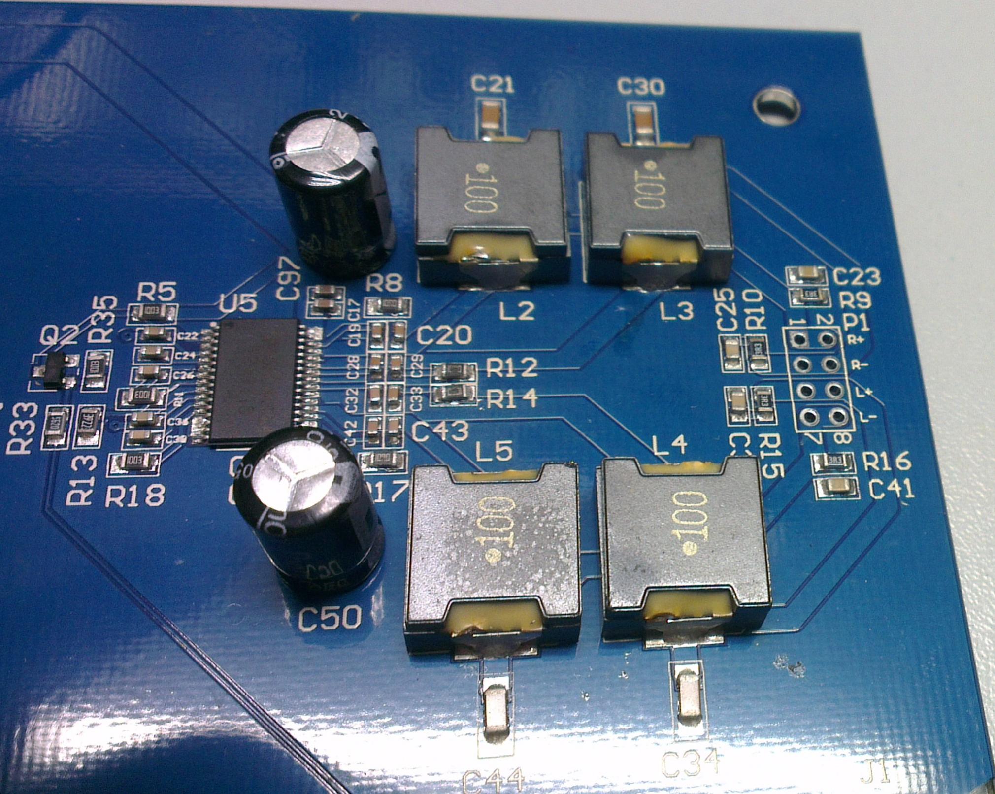

Attached is the picture of my PCB. I didn't use any load.

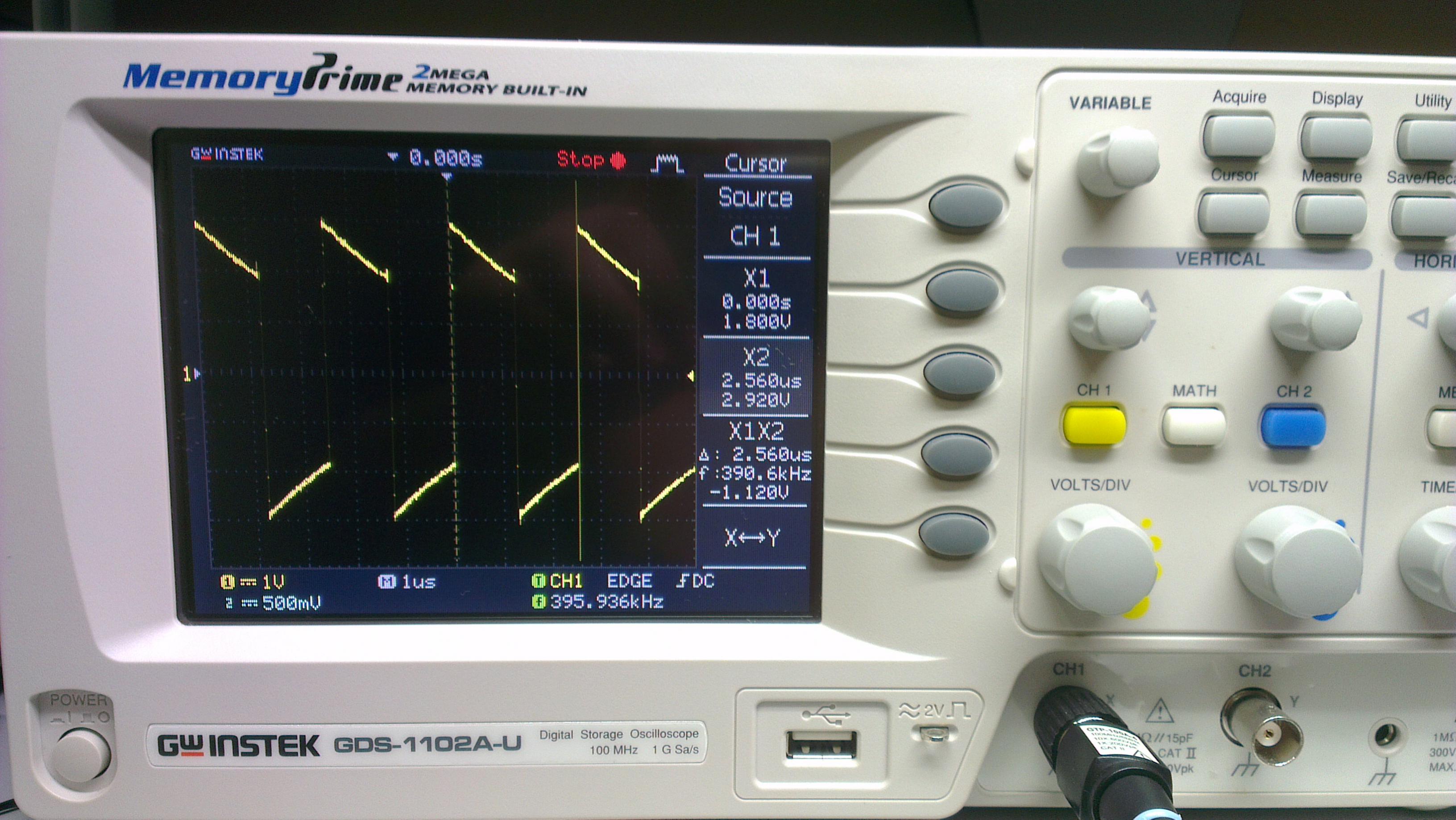

I also powered the board with 5V power supply and observe the waveshape across the R8, R12, R14 and R17 resistors. It seems that they are oscillating at 390 Khz rate. Thats why current is flowing through the resistors and heating up.. Whats the reason of this oscillation ?

The "oscillation" is the 400KHz switching frequency.

You use MUTE. It really doesn't prevent the "oscillation" as such but it's not present on the outputs when muted.
If you really want to kill the "oscillation", you turn off the amp. As said the "oscillation" is the switching frequency and as such the basis of the working principle of a class D amp. If you don't want it, build a class AB amp instead.
I made mistake in the cap value. it was .33nF and my cap was .33uF ! I replaced them and they are no heating up issues.
And I dont see any problem without load now. It seems ok and idle current is 100mA. 🙂
