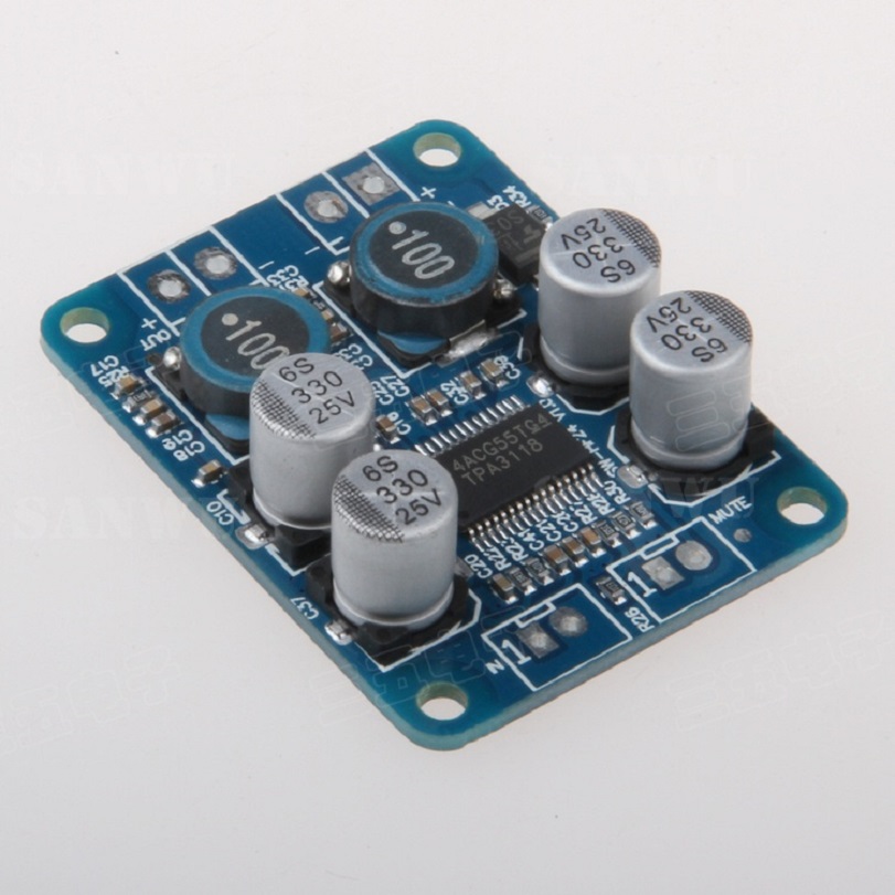

Hello Everyone
I am building a Bluetooth speaker with 2 x TPA3118 Mono Sanwu.
Everything is powered from a battery pack with a step up voltage converter.
Even without the Bluetooth powered on, as soon as I Plug the power there is hiss coming from the speakers.
Could anyone give me a help on what could be the reason and how to solve it?

Hello!
Thank you for the answer.
http://g01.a.alicdn.com/kf/HTB1f8Lo...font-PBTL-mono-font-b-digital-b-font-font.jpg
This is the board

If you disconnect the audio inputs, including the grounds, does it still make a lot of noise? If it does, check the DC supply from your power supply is smooth and not noisy.
I will check both options.
Nevertheless, even with the Bluetooth module not connected to the battery pack, there is noise coming from the speakers...
What if you remove the dc-dc step up converter, any noise then? Maybe go to a 4s or 5s pack to get the higher voltage?
Just confirmed. No audio cables connected and also Bluetooth module disconnected from batery pack, still noise coming out of the speakers... :S
Also tried with the DC step up module not connected and powering the amps directly from the battery pack. The problem still persists
Got your PM. First things first. Gain mod. Did you do it? These boards often come with 32dB configured. You can remove R2 (R27 on Sanwu Boards) to lower gain to 20dB.
Secondly. Powering from batteries you combine gnd from bluetooth board and sanwu amp. This would create a groundloop if there is no circuit preventing this. You can buy a cheap seperator on ebay for usb if it is 5V
Third thing. Sanwu board come with 10uH filter inductors. This is suited for 4 ohms. If speakers are 8 ohms use 33uH

I started with the gain mod by removing the R27 and the noise is noticeably lower, but still audible. Curiously, the noise is higher when no audio input cable from the Bluetooth board are connected to the amplifiers. When connecting and powering on the Bluetooth board the noise in the speakers decreases... (?)
Yes the Bluetooth board and amplifiers have the same ground connection on the - of the DC-DC boost converter... The Bluetooth is rated 12V, Is there any isolator for 12v?
The speakers are 4ohm - SBAcoustics 2,5" fullrange

Not sure exactly the device Mortenhoe was suggesting, but there is a 12v isolator available from Mornsun: B1212S-1W. You can't always find it on ebay but it is on AliExpress. I haven't tested it with the specific Bluetooth board you are using (on my list of things to do) but it fixed a noise problem I was having with this board:

The noise I fixed with the Mornsun device was classic Bluetooth/ground loop noise. I am driving a "Verst" 2.1ch board.
