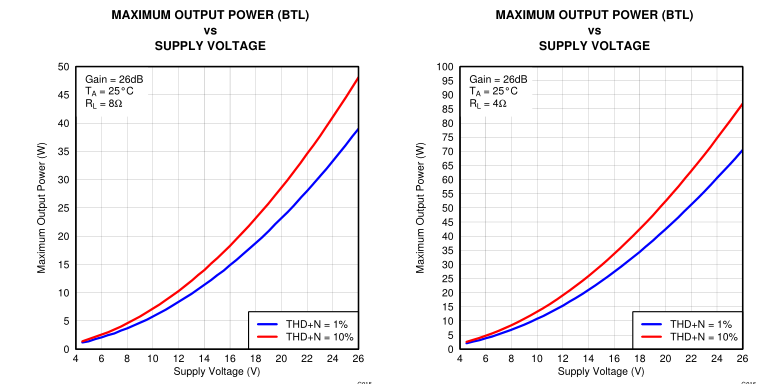

How much power output is expected at 16Volt? Is there any way to calculate the voltage in vs power output ?
The output power rating depends on how much distortion you decide to accept (1% and 10% are common choices) and the load impedance. In the DS the 10% THD point into 4R is 25W typically, at 14.4V. Going to 16V would give you about 30W. If you choose the more conservative 1% distortion point, you'll get a lower power.
Here are two graphs from the DS - left is 8ohms, right 4ohms. The red line is for 10% THD.

What are the requirement or changes in circuit for making THD 1%? how can it be 10% and 1% at same voltage?
The choice of 1% or 10% is up to the person doing the measurement. If someone wants higher numbers, they'll go for the 10% figure. Myself I tend to prefer even less than 1% - onset of clipping is where I measure output power, but that's rather subjectively determined on a scope as I don't have a THD analyser.
Its not '10% and 1% at the same voltage' rather the 10% figure represents a more 'square' sinewave signal and hence higher power than for 1%. Another way of looking at it is the 10% figure is taken with the volume control set higher (more gain).
