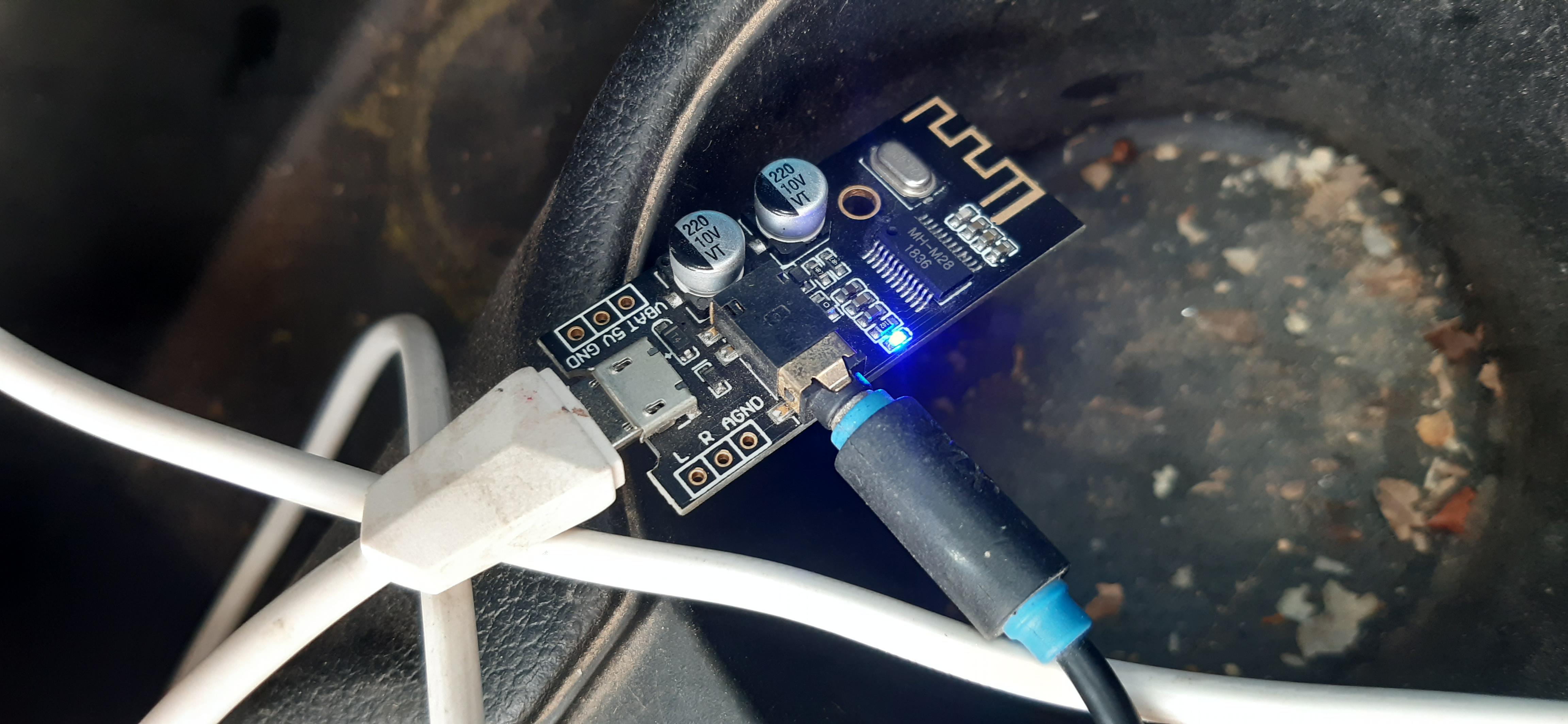

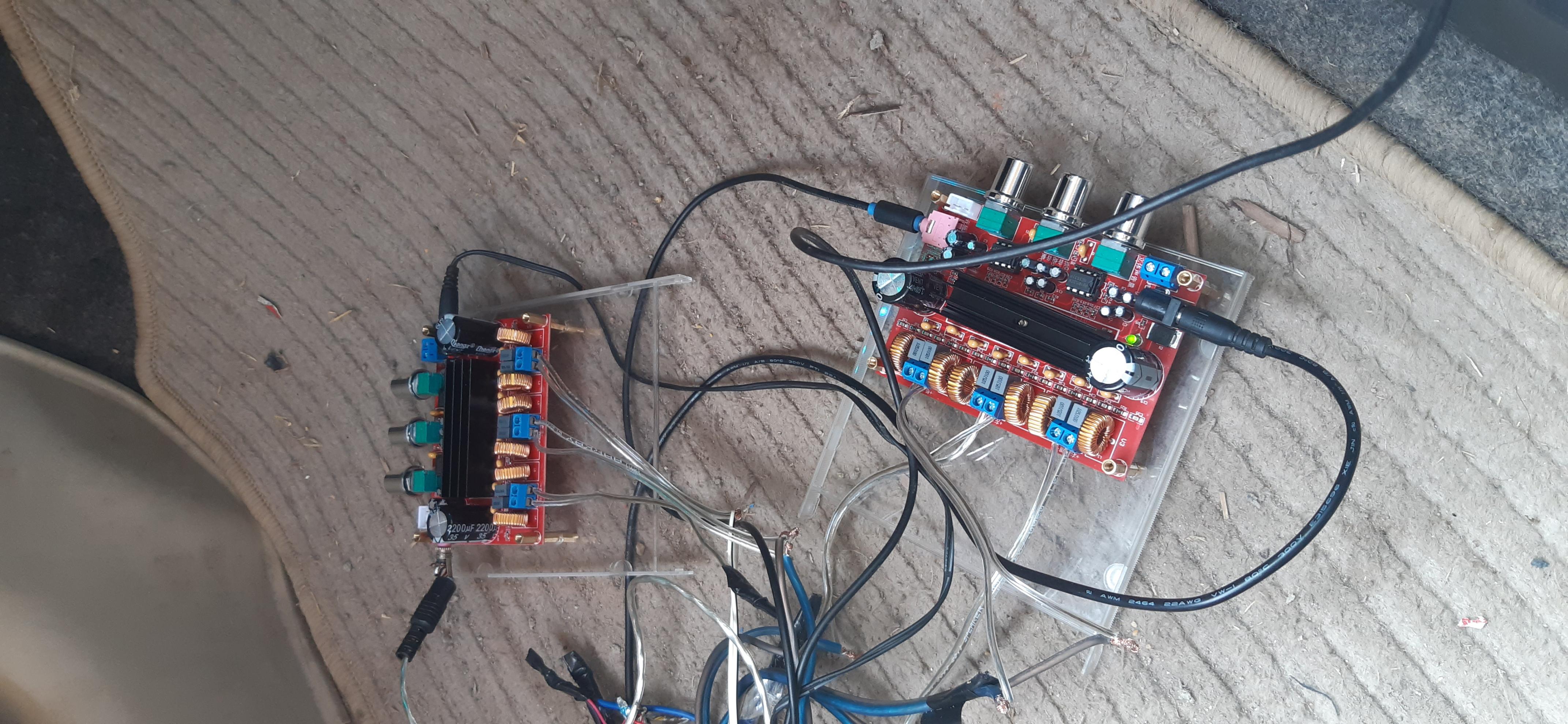

I am trying to use the TPA3116d2 and NE5532 Preamp in the car.

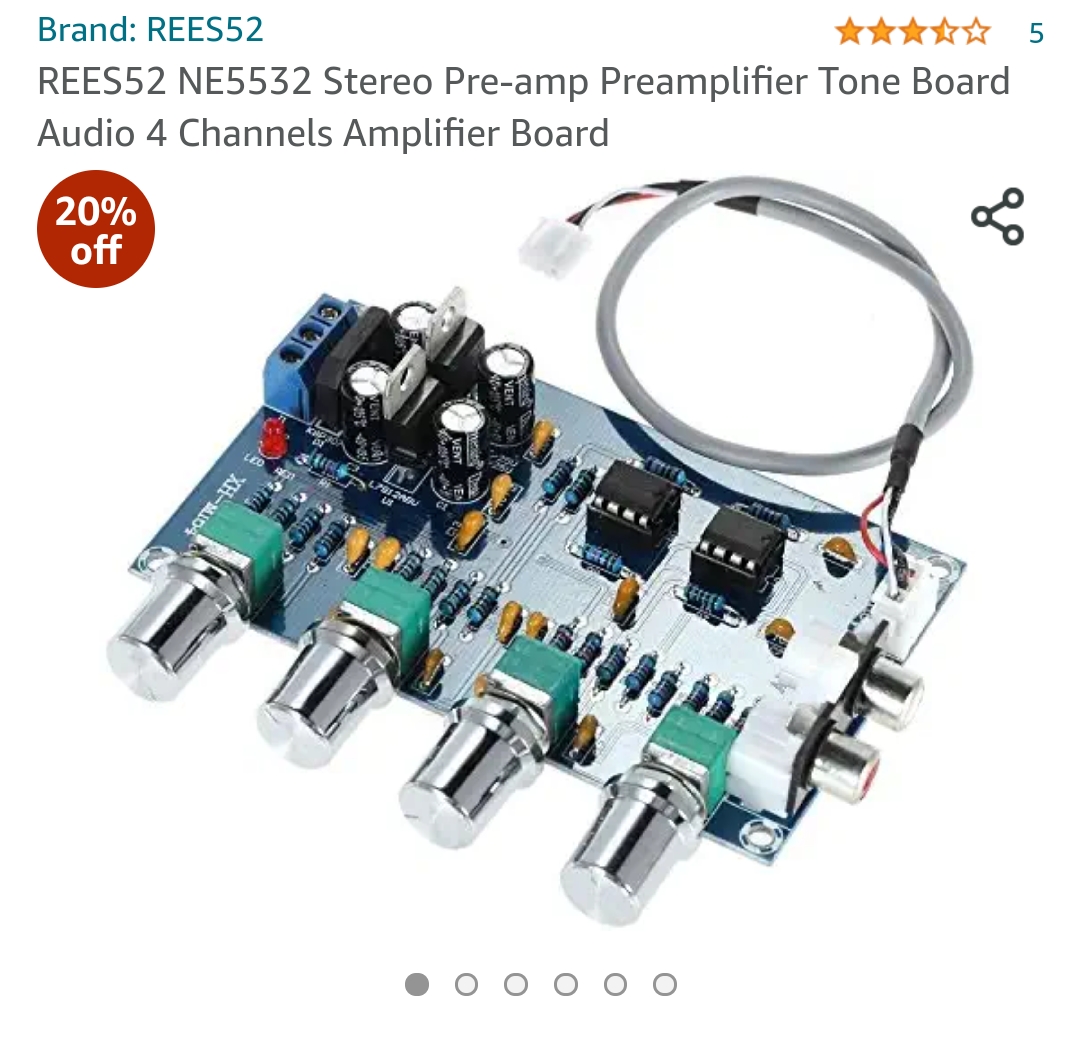

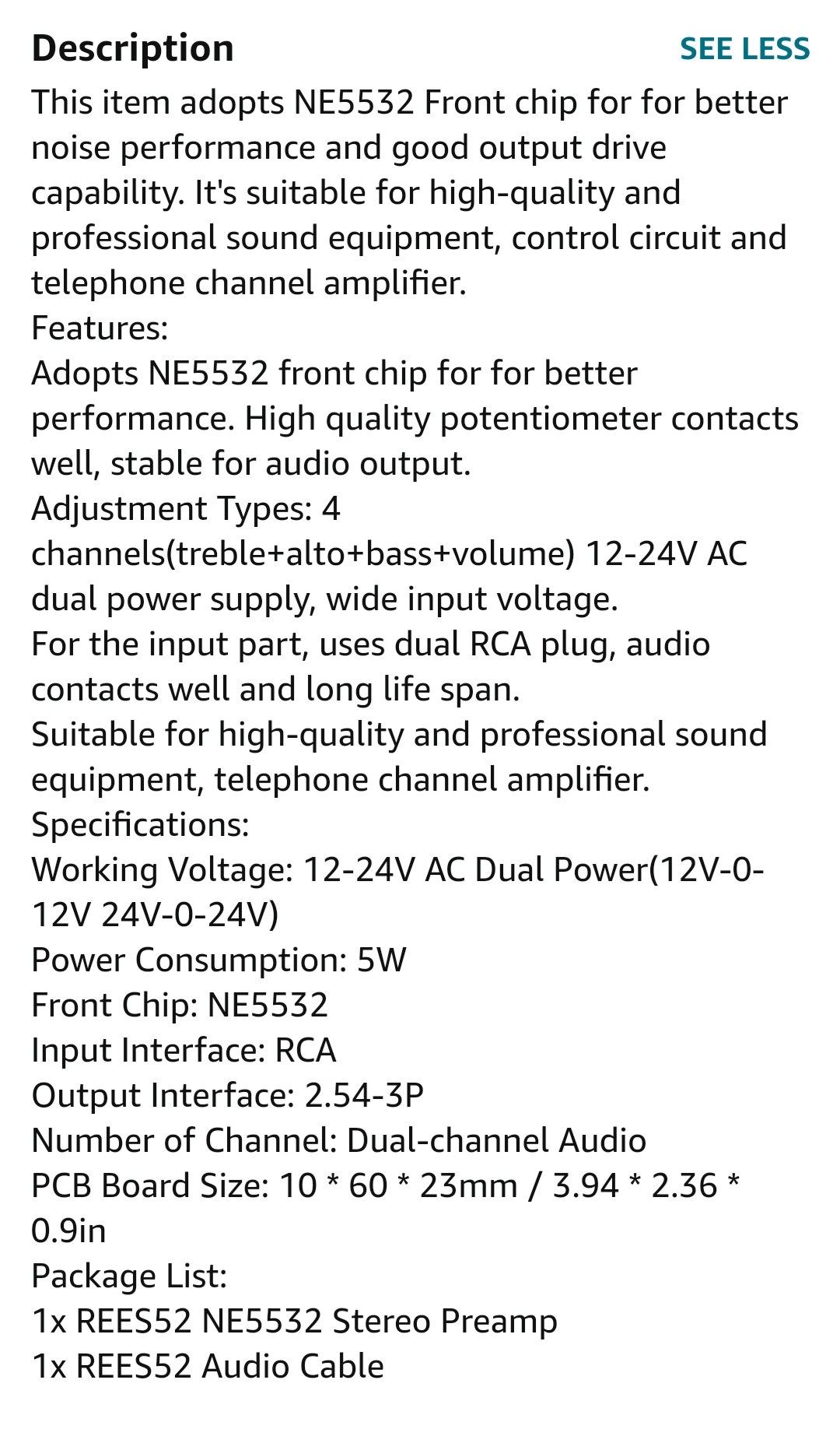

However I just found that the NE5532 is running on 12V AC and not DC so is there any way to use this in the car as in car we have only DC Voltage.
Also I have connected a small MH 32 Bluetooth to the audio input on TPA and when I turn on the amp in the car it gives lot of noise.
Is there any way to eliminate that weird noise from the TPA on Bluetooth in the car.

In theory it is possible to convert 12Vdc from your car into +/-12V for the pre-amplifier. The only problem is that it will cost as much as buying another pre-amplifier for single 12Vdc.

The solution with an 12Vdc->220Vac and then down in voltage is a logical solution but would not my choice. It would be more expensive, more bulky and I can imagine the 12Vdc->220Vac inverter to generate some noise.
The Imgur picture seems to be an ordinary boost/step-up converter that has a single voltage as output. I cannot see that as a solution.

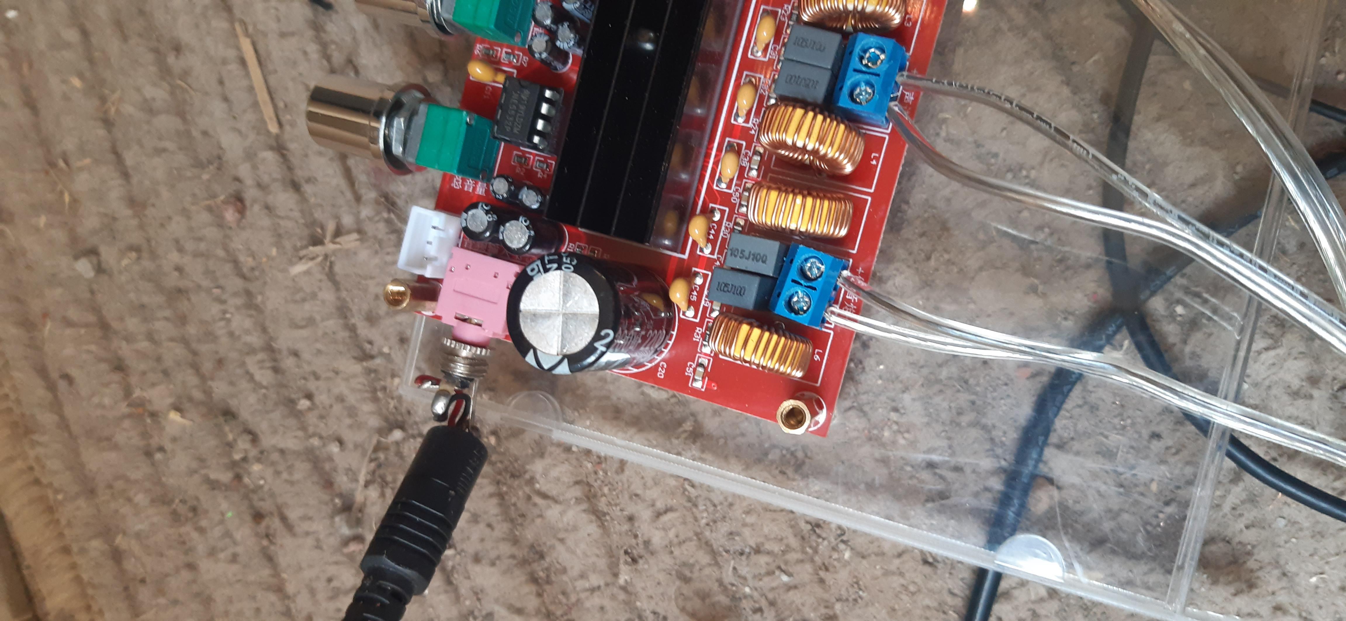

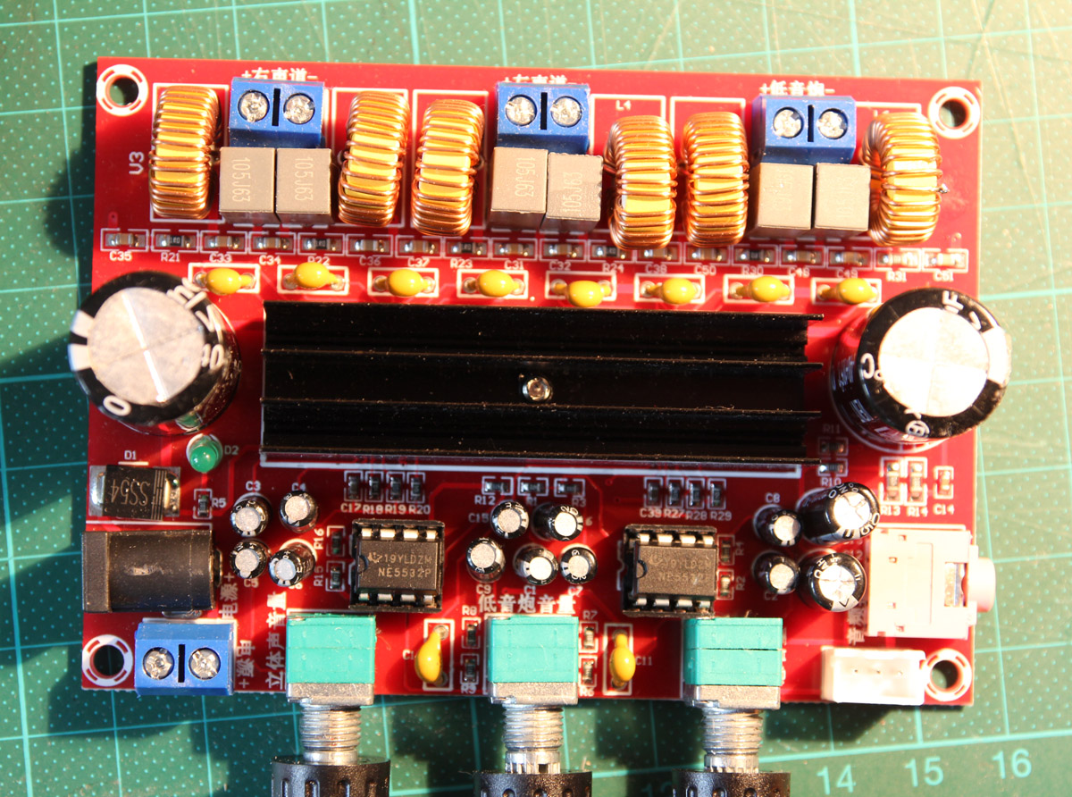

attention, that's a bad amp!
hi digitaled,
seems you have the same amp as i bought some time ago.
my amp has several severe flaws:
coils heat up even when idle, coils seem to have wrong value (40 uH), idle current is far to high (around 300 mA), coupling caps make huge popping noise when turned on, cascaded pots are noisy and create severe channel differences...
so i would not invest money in trying to get this amp right with an extra preamp and power supply, but rather buy a better amp straight away!

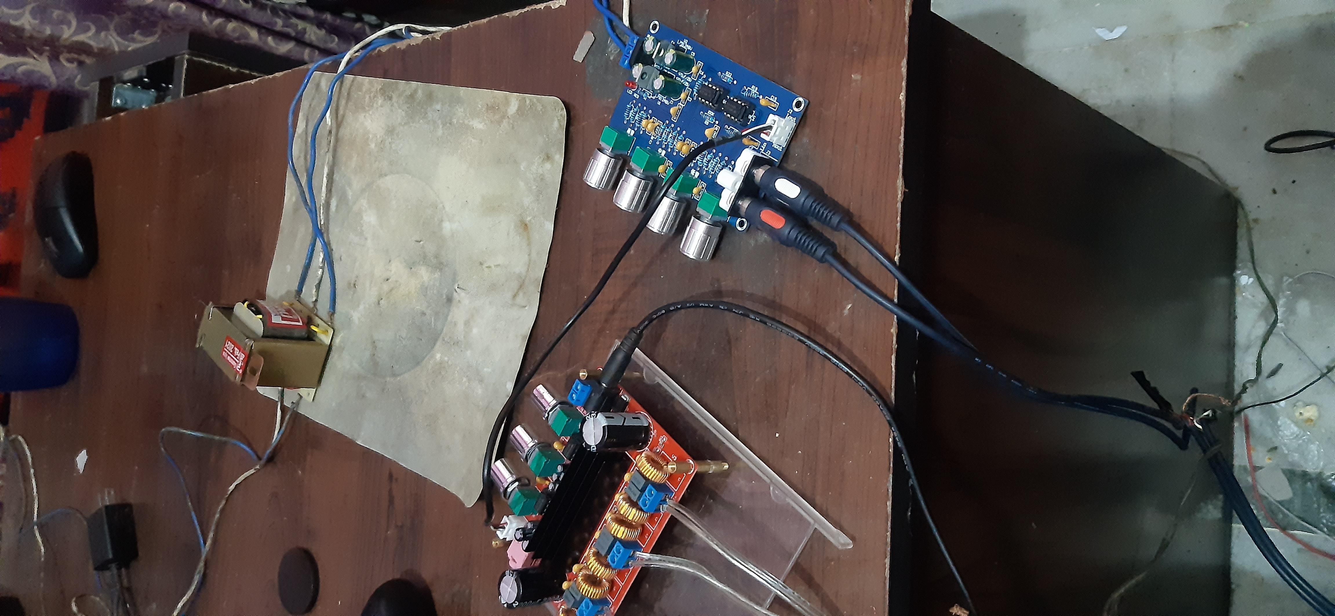

Just wanted to give an update as I tried connecting this Preamp to a centre tapped transformer at home and plugged in the preamp to BT and the sound after adjusting levels from preamp is much better now.
I finally heard that clarity and vocals from TPA and am bit happy now..
Now the next problem is to give the AC power to preamp.
I found this video where we can use UPS in Car as inverter. Since I have APC UPS lying useless was thinking to try that .
Is this safe to use such UPS in car and any sort of precaution I need to be aware of.
The video link is here
How To Make a Car Power Inverter - YouTube
TIA🙏🙏
