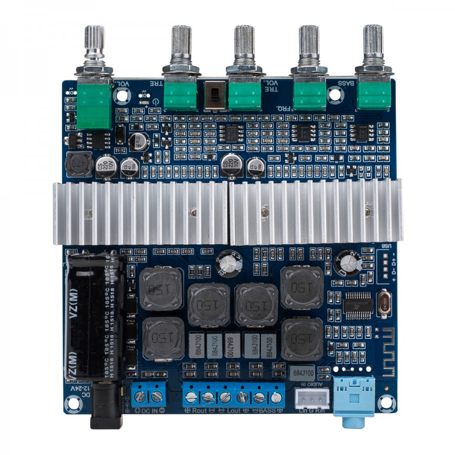

saw few thread about sound cutting but it was @ high volume.
It was working fine for few weeks, and out of no where, under normal use, the sound is now cutting under low/med signal.
- Mine is at low volume (low signal input), the sound is cutting. see video.
- the 3 channels are cutting in same time.
- If I stop music over BT or Line-in, the speaker are clicking in the same way.
It act just like a overtemp protection, the TPA shutoff and then ON every 1s.
Please, note that the ''shutoff'' click, is way different than the original hiss sound from no signal (battery saver).
Solutions so far :
-I tried many power supplies,
-many speakers (4 to 8 ohms).
- I cleaned the original thermal paste that was on the TPAs legs, put new artic silver.
- Play with volume knobs
Nothing worked.
Final note : if I'm blasting the sound, everything is ok. But its hard for the ears 😀

Good work you have done to find the fault. It is a vicious behavior. A further problem is you do not have access to the TPA3116 chip because of the heatsink being glued to the chip.
I do not believe it is an over-temperature problem with a 1 second period and these heatsinks.
My guess is it is a problem with the control circuit deciding to activate or mute the TPA3116 chips.
Pin 12 of the chip is the mute input. You may find that the signal on this pin is toggling between low and high at the same frequency as the sound. The question is if you can find this signal outside of the heatsink.
Another interesting pin on the TPA3116 is pin 2 (“SDZ”) which is a shut-down pin and may also follow the output being switched on and off.
Pin 3 is a “fault” output pin being pulled down in case of a fault detected by the chip.

thanks for your help.
In fact, the heatsing is not glued, there's 2 screws for each heat sink.
I'm pretty sure the issue is from the thermal paste all over the pins.
Ive cleaned it with alcohol and dry with air duster can.
So if I cut a pin or rewire it to bypass the ''protection'' , it could work?
Since I doubt there's a ''real issue'' because its working well @ high volume.

I tried all sources (usb-A, sd, 3.5mm, bt) it still cutting.
But I found something new.
- Right/left channel sound is cutting, but the sub still running ( note, 2 tpa on this board, one for the sub the other for stereo).
- Only Right channel is clicking hard ( speaker will get pushed all the way out)
- This is happening 5-6 minutes AFTER I turn ON the amp. This stating to look like a fake overheating !
- When ''cold'', amp is working just fine.
still dont understand why its working fine under big load.

Absolutely strange TPA3116 behavior. Could it be that you have an important DC-offset at the stereo outputs? Measure with voltmeter in DC-setting with volume turned fully down.
Don't use good speakers before the problem is solved. Cone all the way out indicates DC on the speaker which is not good for the driver.

I watched your video. I only see one speaker. Is that the left channel repeatedly turning off the sound? If yes, there is also a right channel (with DC failure) we don't see and a sub-channel we don't see?.
DC at the output could be caused by a leaking coupling capacitor at the TPA3116 input (right channel). When the right channel puts DC on the speaker, it does not take long before the safety-circuit shuts down the whole chip and after about a second, attempts a "hick-up" re-start which turns the left channel on for a short moment.
Perhaps the key to the problem is the right channel that only does "clicking" (no music), correct?

Try to start the system with music as usual and with a voltmeter (DC range) across the right speaker terminals. For a start the voltmeter is likely to flicker somewhat from the AC music but without a clear DC component. After a while, you will probably see a DC value grow until you have the clicking in the speaker. Then switch off.

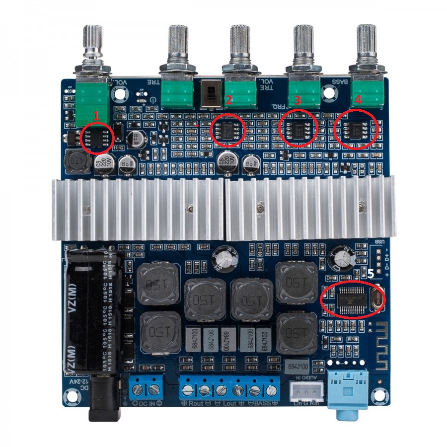

Dear All,
I bought a similar but not the same board than overdose but I have the same problem:
- After about 1 hour usage of the amplifier at low input signal starting the same behaviour: sound cutting every seconds on right and left channel.
- If I increase the volume with the volume knob then the problem disappears.
- In this case (from this time), the board working well but if the source volume become low (for example between two songs) the sound cutting returns OR I decrease the volume the sound cutting also returns.
I found this topic with google, because I searched a lot for solutions. I built a complete project that based on this board: designed and 3D printed an enclosure with oled display and arduino: temperature and power supply monitoring, so I really want to use this board. I attached some picture for help in identification of my board (and my final enclosure😉).
I can imagine the root of the problem may be the input selection. The Bluetooth section is not important for me, because I use only the line in.

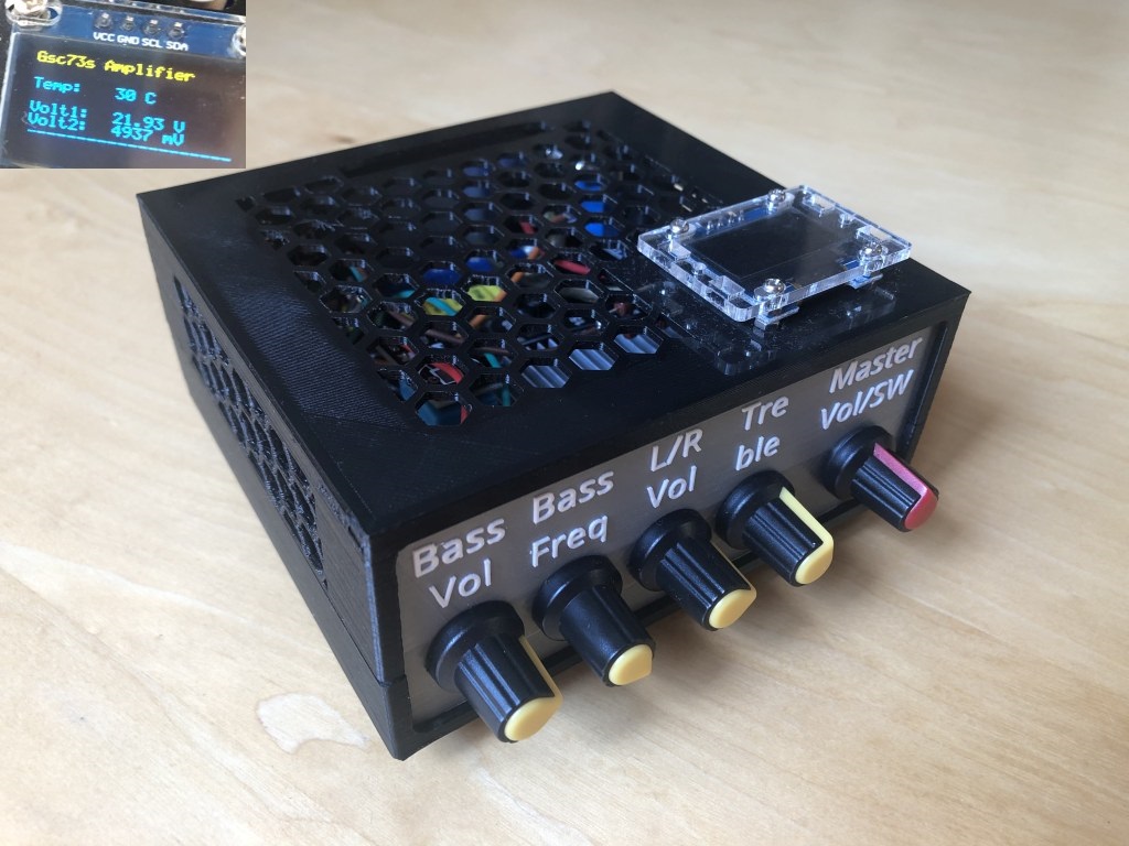

I will be very happy if somebody can give me any idea to solve this problem.
Best Regards,
gsc73

Dear All,
Today I identified all chips on the board (see attached picture):
1: XL1509-5.0E1: 12V to 5V voltage regulator.
2: R45810I: Dual Audio Operational Amplifier
3: TL072C-98M: JFET-Input Operational Amplifier
4: TL072C-98M: JFET-Input Operational Amplifier
5: AS19AP-1R340: Blutooth chip.
I think the BT chip could be the key to the solution, but I could not find any exact information about it, only hints: site1, site2, site3 (translate Russian to English).
I don't know how next.
Best Regards,
gsc73
Best Regards,
gsc73
