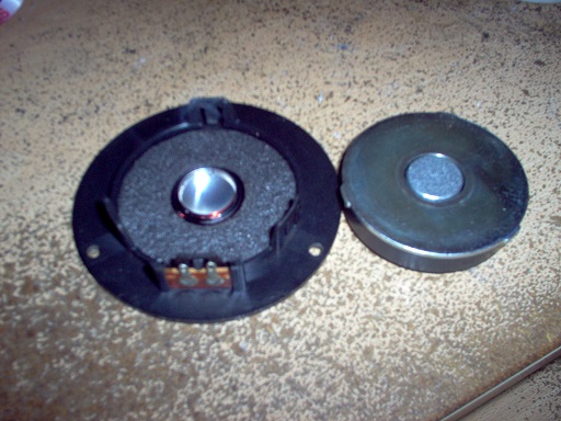

Adding to this (sorry, I didn't find the edit button), I found some images of the tweeter in question, with and without the said chamber added by Totem:
I'd like to know if this chamber is removable somehow, and swappable to a new tweeter.
The original looks most like a modified H0831-06 27TFF. The added chamber lowers the Fs slightly. The 27TBC/G has a chamber.
I can only tell you what your options are here. Me, I'd get a new whole tweeter.
You might go to madisound and try a replacement voicecoil:

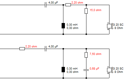

Ferrofluid is optional. It changes the impedance and frequency response slightly:
Vifa C17WH-
Level adjustments are easy enough for the cost of a ceramic resistor. I have already suggested how to do that:
Each ohm is about 1dB level change.

seems a bit odd not to have any damping in the added chamber, which would lower the impedance peak at resonance I guess

I got a factory visit to Mitcham, Surrey and free replacements out of Chartwell. Got to meet all the engineers.
And, TBH, it was entirely my fault the tweeters had popped. I'd taken the fuses out so I could party harder! 😱
My experience of loudspeaker companies is they like happy customers.
If you phone them up after the folks have had their coffee, is they want to help.
Ring Totem up and explain the problem. Having checked the facts they need to know.
