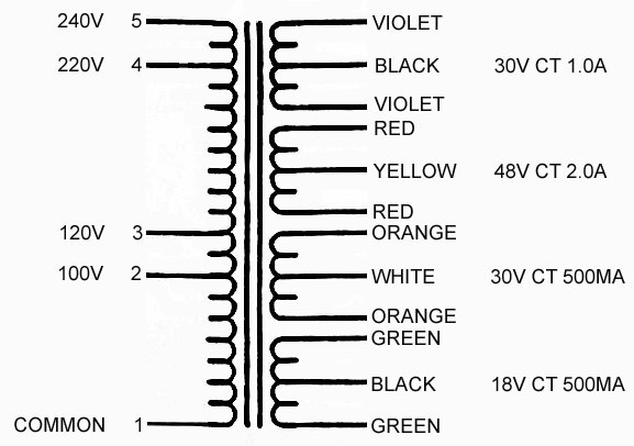

I have a 150 VA Transformer that has multiple secondary taps I will not be using.
The tap I will be using - the 48VCT - is rated 2A (96VA), but can I assume 3Amps are available to the 48VCT (all 150VA) if other taps are not used?
There are two other 30VCT (one 1A and the other.5A) and one 18VCT (.5A) on the secondary...all unused...
Sorry for the lame question...tried "googling" the question and got nowhere fast. I know the question can get answered fast here...

The core is capable of delivery this much amp, but the magnet wire of the tap that you plan to use is capable of withstand 3A is questionable. Unless you can find out the size of the wire, it is difficult to say for sure.

If it is rated 2A chances are it will withstand roughly 2A. If you are draw 3A from the winding it may overheat the transformer and cause an insulation breakdown resulting in a possible fire or shock hazard.
You could give it a try, just load that 2A secondary with a load equivalent to 3A and monitor to see if the transformer core is becoming too hot (wait a few hours). An insulation problem usually happens when the transformer becomes way too hot. If yours is equipped with a bi-metal thermal cut-off then it will simply cut the primary power going into the transformer.

the two lower windings can be connected in series to give 48Vac @ 500mA.
I think each winding should not be run beyond their rating for any sustained period. Yes, they can supply short term overloads.
Now if you rectify the 500mA supply and separately rectify the 2A supply and then parallel them you can draw upto 2.5Aac from them.
This will give you a 67Vdc 1.25A PSU. About 83W continuous.
The smoothing will meet any peqk demand that exceeds the continuous rating.

Some multi secondary transformers have a total secondary VA rating that exceeds the primary (and core) VA rating. this arrangement allows each secondary to deliver upto it's own maximum output PROVIDED the total output, at any time, does not exceed the transformer rating. This is achieved by using thicker wire for each secondary winding and this results in a lower voltage drop when under light and medium loads (=good regulation). Nice on a ClassAB amplifier with ancilliaries run off separate windings.
The core does not really care how much power is drawn, actually the flux is higher when the transformer is unloaded. The core size is chosen so that the windings fit, a bigger core requires less turns and is bigger, so it can be used at a higher power.
Windings are dimensioned by the current they are supposed to supply. 3A on the 2A winding is over double the R*I^2 losses so it probably is not a very good idea.

If I post rectify parallel the 30 + 18 .5A taps with the 48 2A taps, wouldn't I have different centertaps?
I repeat, you cannot draw 150VA from a 96VA winding.
Mega showed that the heat losses are worse.
If you do combine the 500mA and 2A windings then the centre taps locate on the same power ground.
But first you must measure these two different windings to see how close they are for open circuit voltage and loaded voltage at their rated currents.
If this proves feasible then 120VA can support between 60W and 120W of good audio. That equates to two channels of 30W+30W upto 60W+60W. That seems just fine for 8ohm loads.
The 24Vac (=48Vac CT) is too high for 4 to 8ohm speakers and certainly too high for 4ohm speakers.
So the series connection the 18VCT and 30VCT taps... The connection where these two connect, is the centertap for this .5A secondary, correct? Seems strange as these are not , well, centered...
I can then combine post recified positive (and respectively negative) out .5A to post rectified positive (and respectively negative ) out of the 2A at smoothing caps bank and then connect the two CT..

Can I connect the 30VCT 1A instead of the 30VCT .5A to the 18VCT to increase the VA Available, or do the Amps have to match??
sorry that does not work.
I was sidetracked by the reference to 48Vac without thinking about the need for 24V-0-24V.
You're stuck with 96VA unless you rewind/modify the transformer.
If you could get in and separate the centre tap (of either the 30 or the 18) to give two secondaries then it can be modified.
Ahh, what if I connect the primary to 100V - COM instead of 120V - COM? Will it increase the VA from 96VA to to around 120VA (I am on 120V - in USA)?
Whoops, it will decrease voltage 20%, and amps should be the same...I need some sleep.
