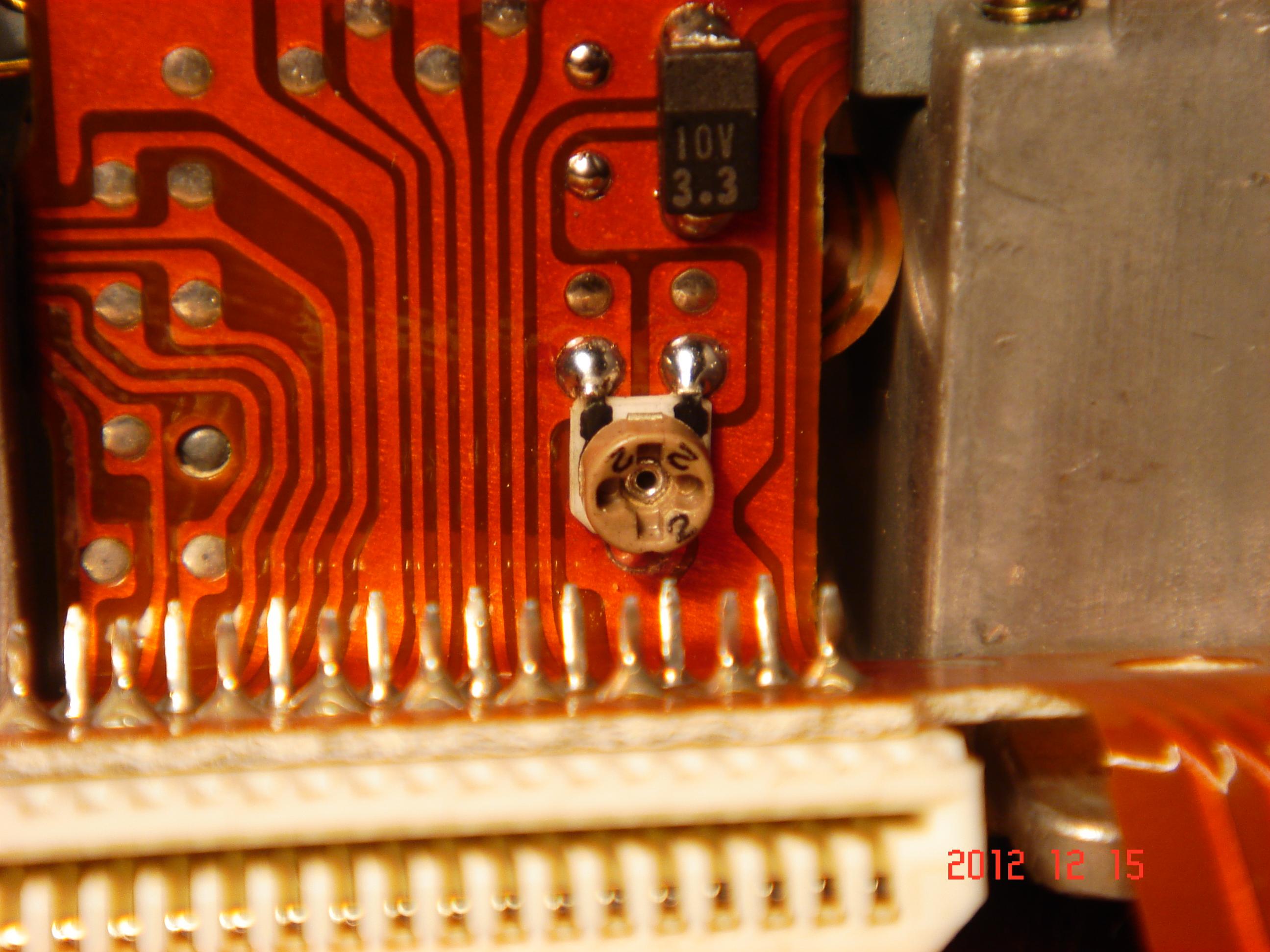

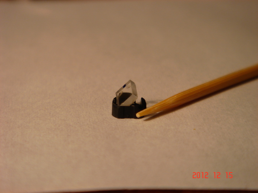

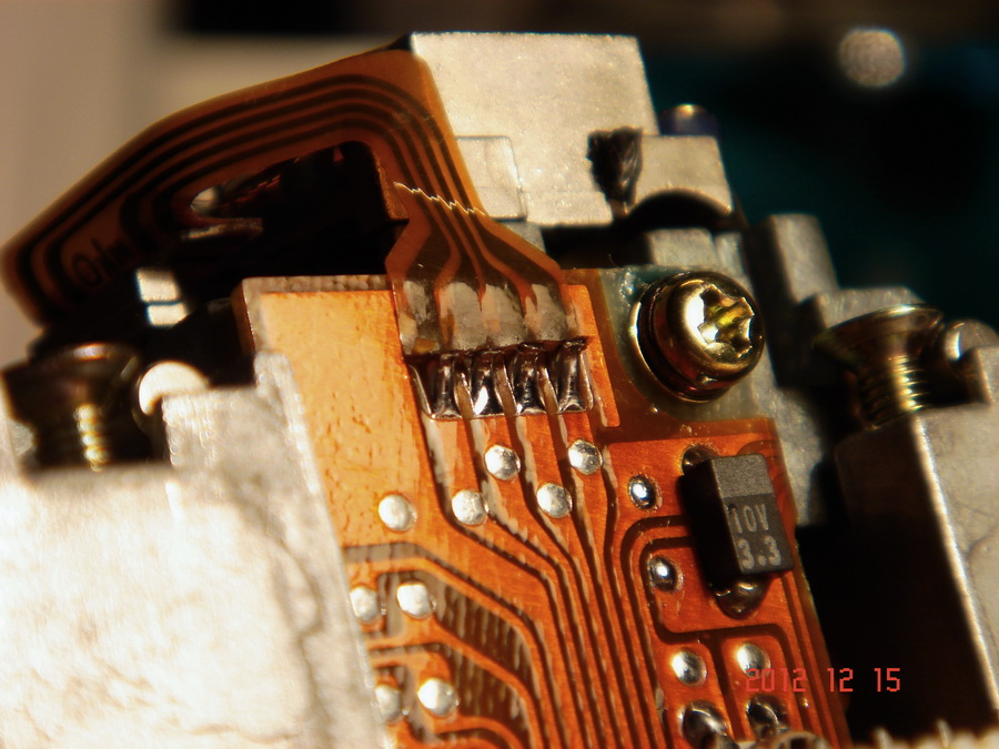

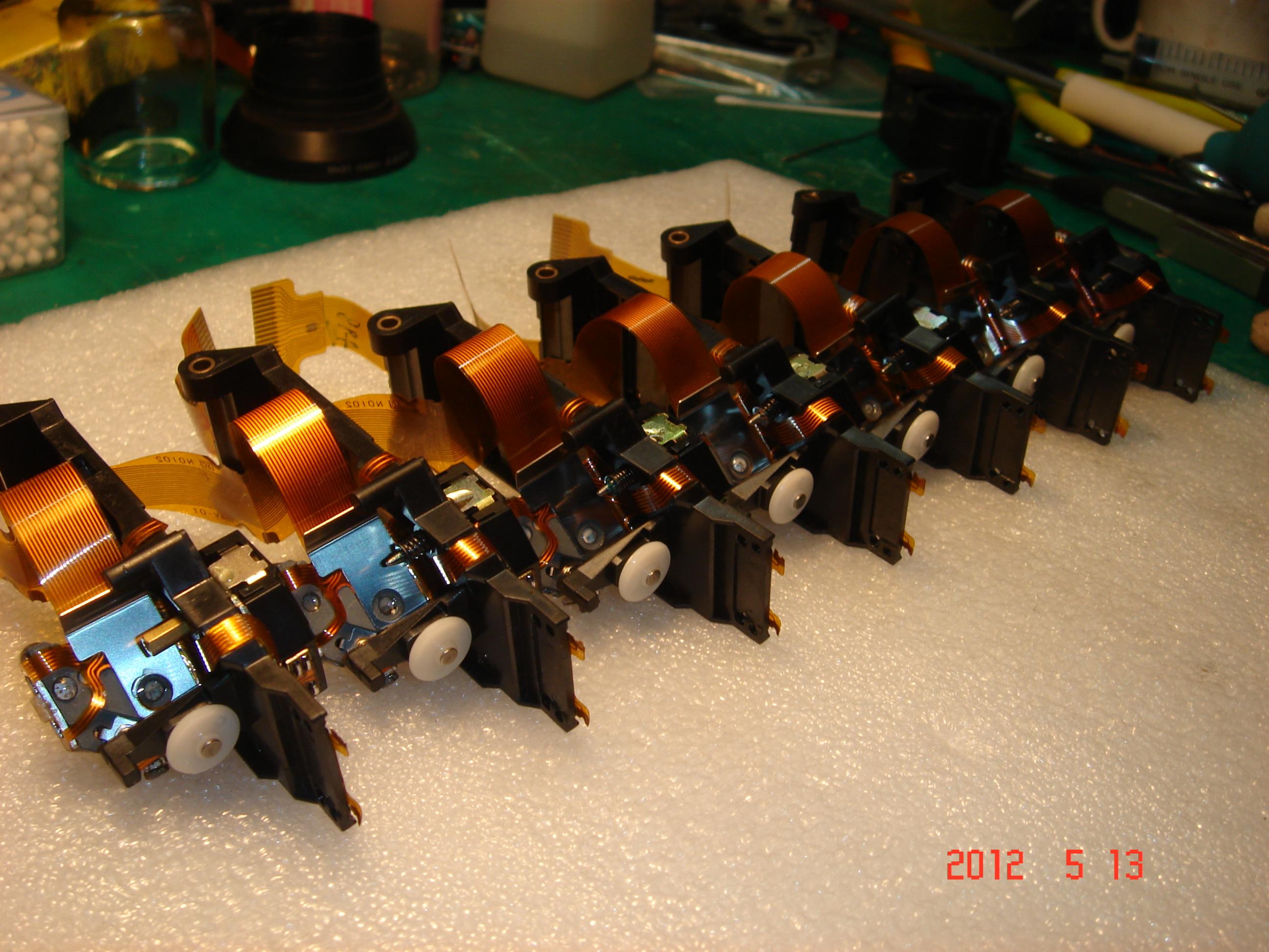

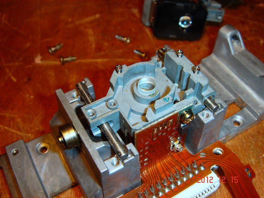

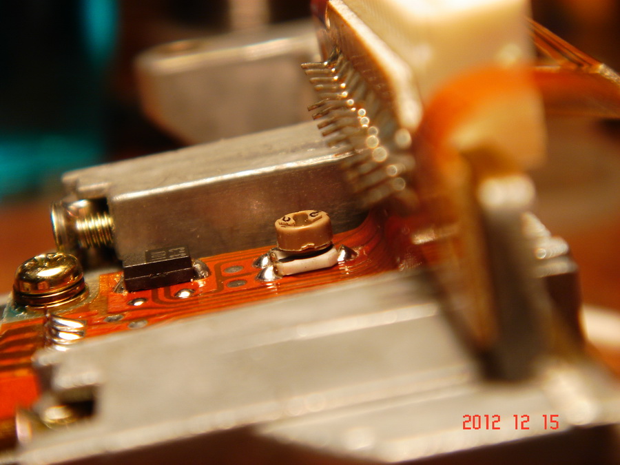

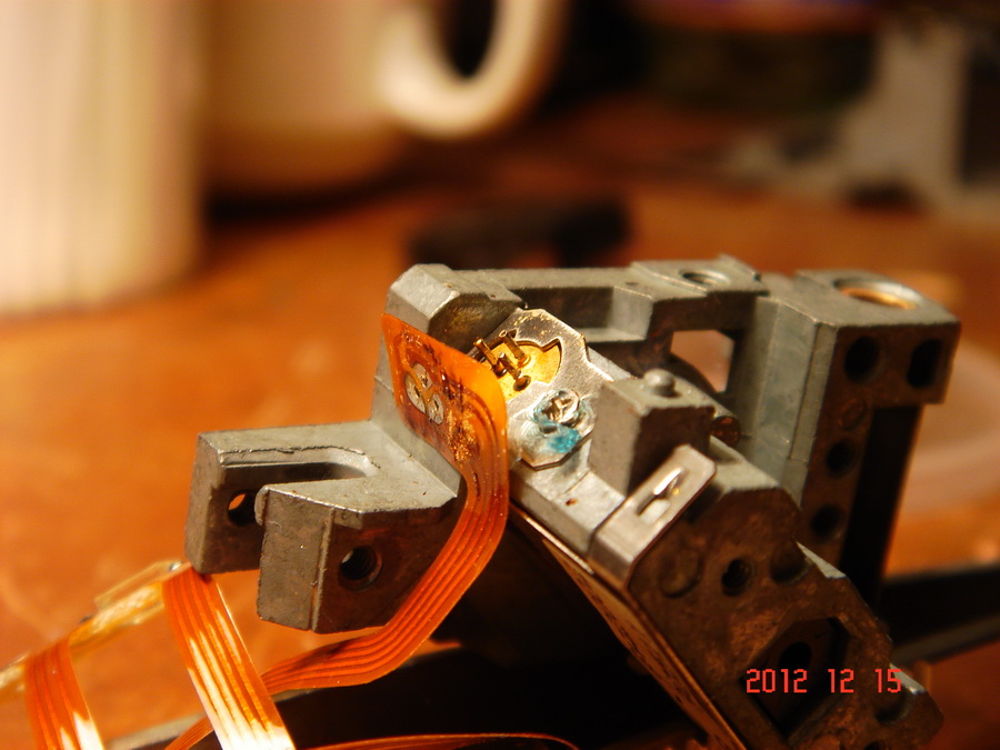

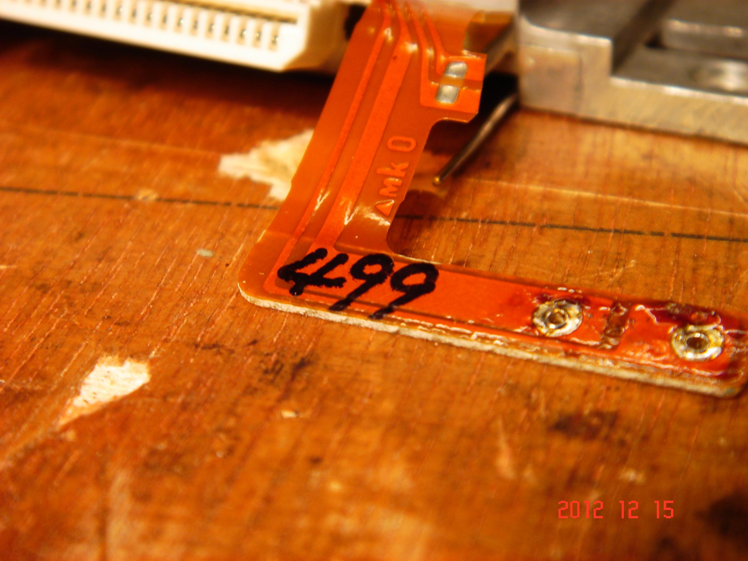

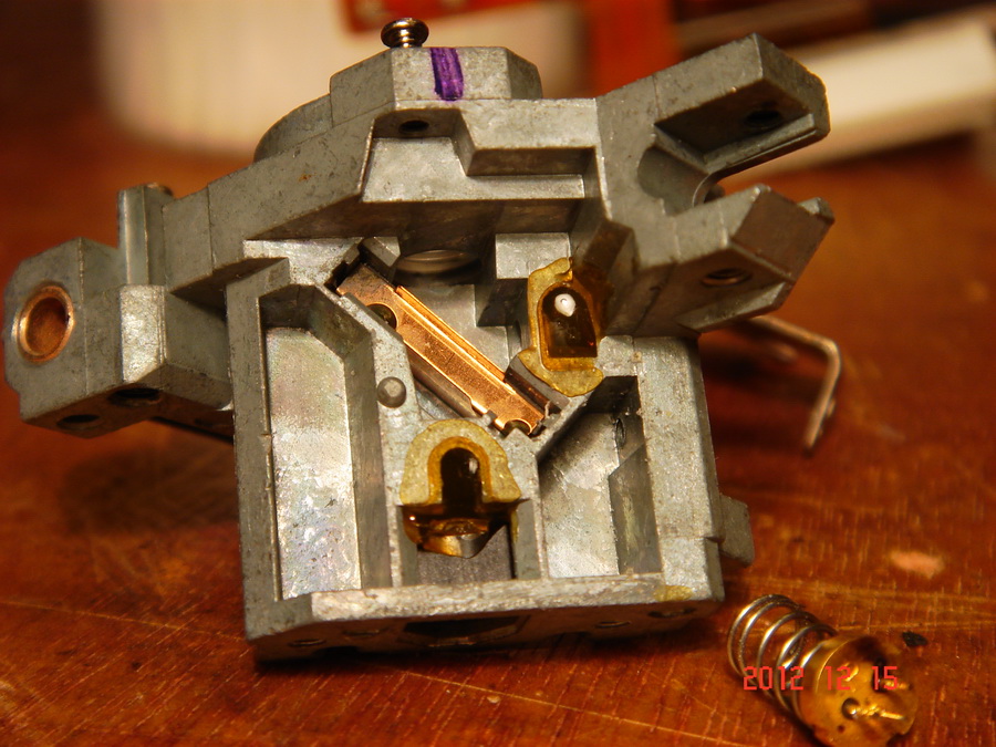

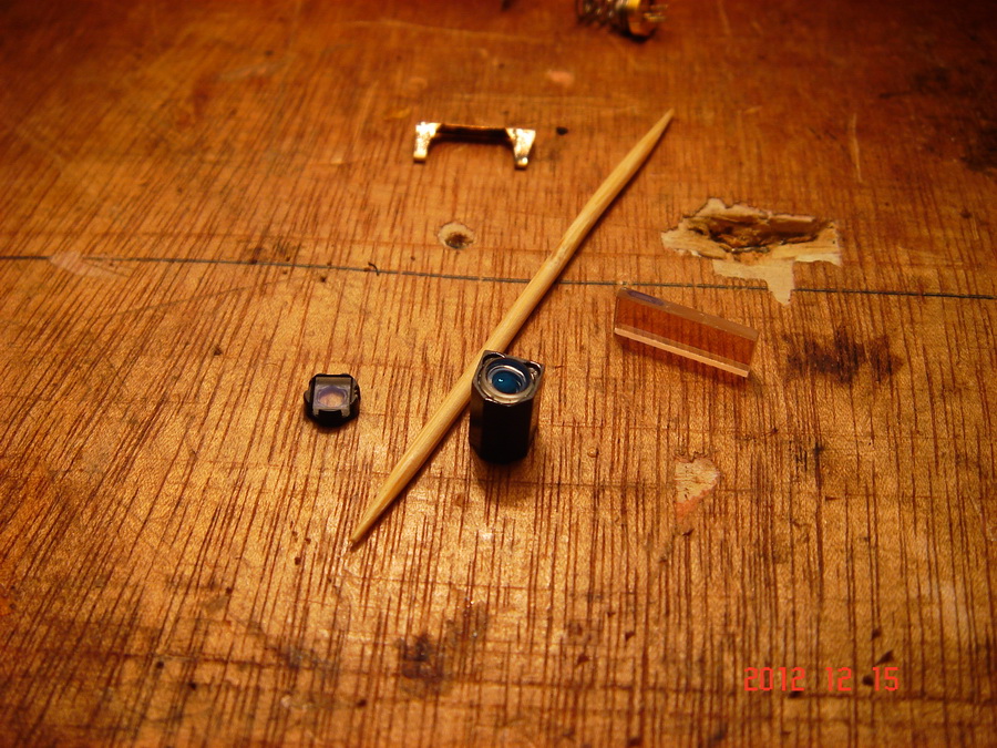

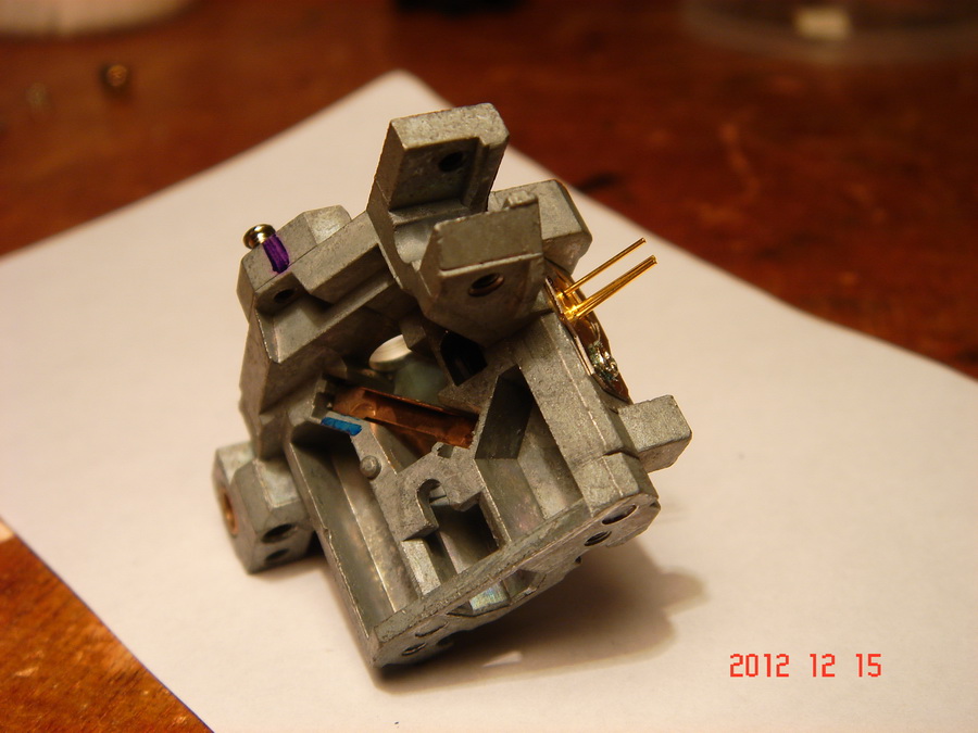

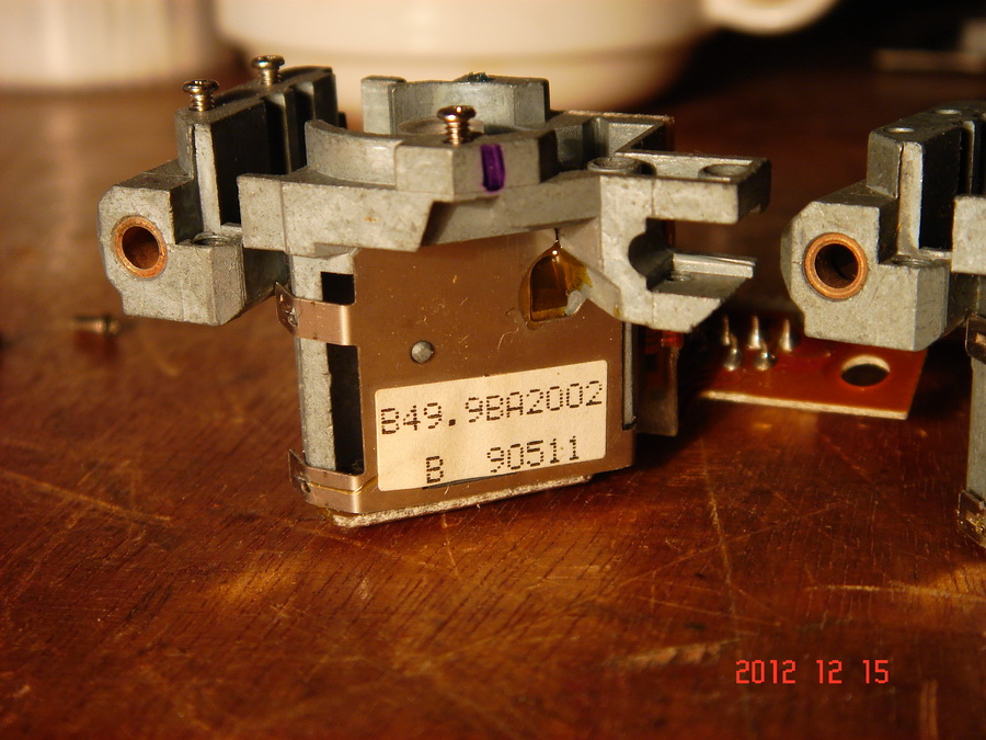

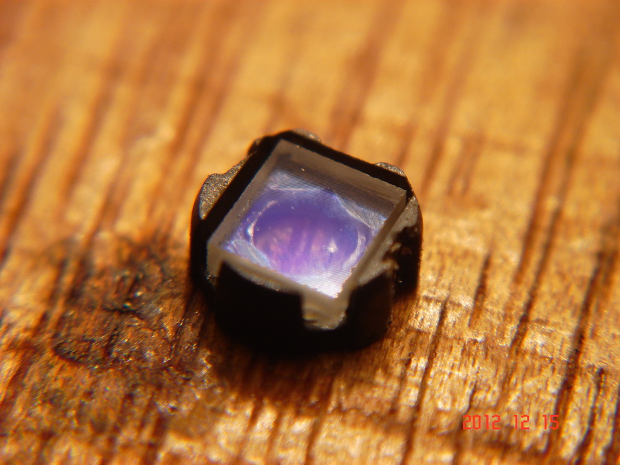

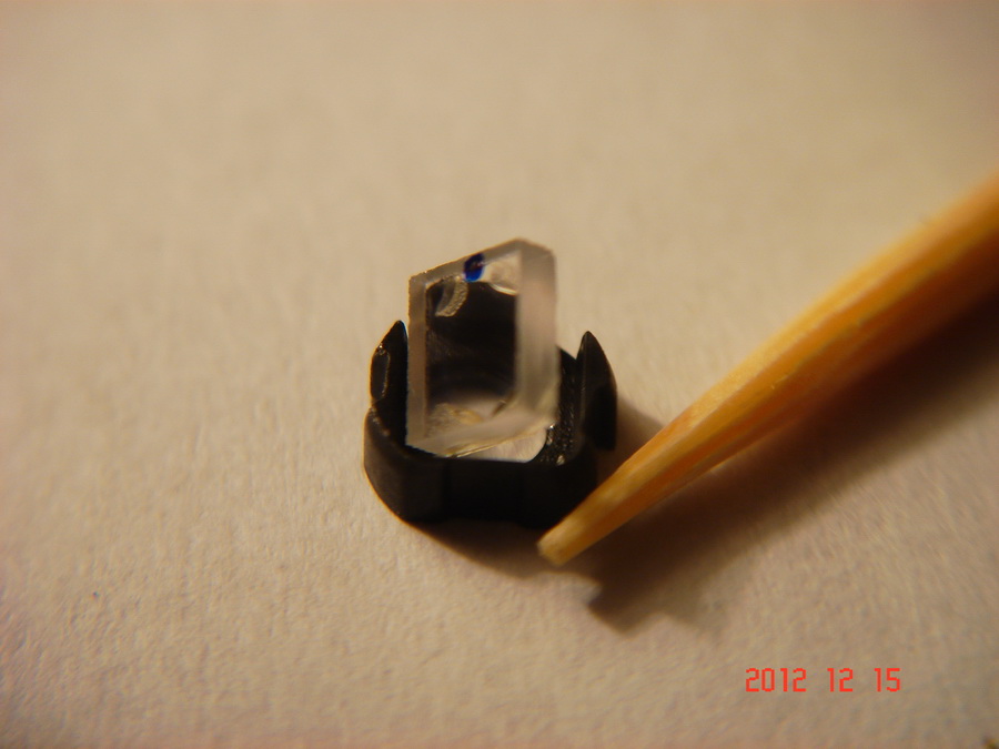

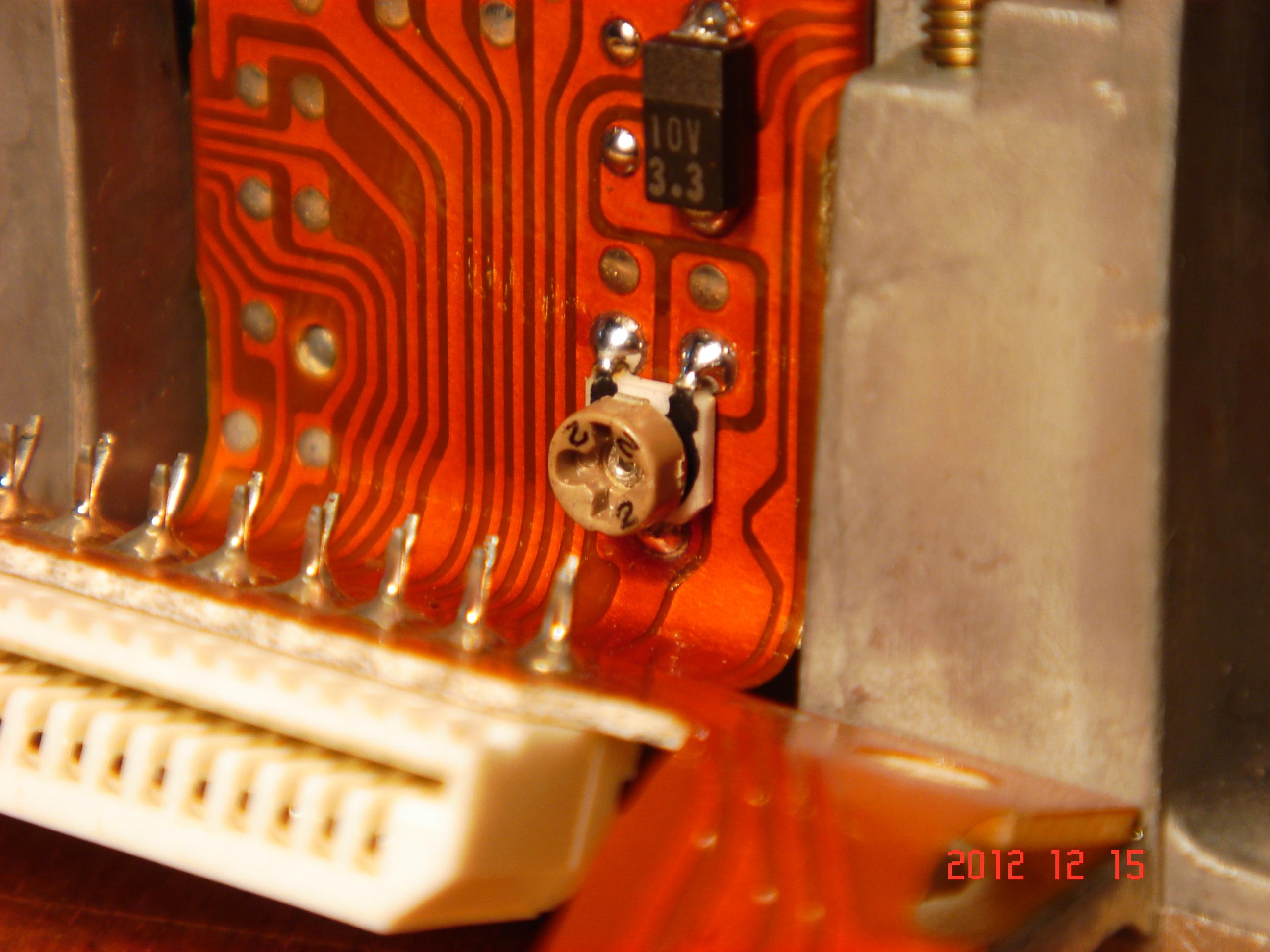

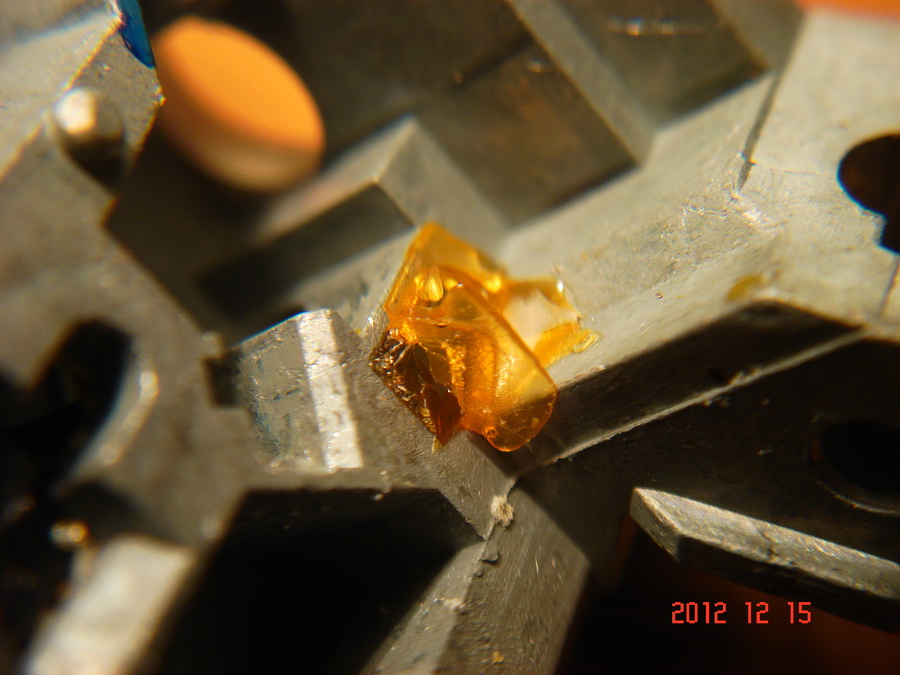

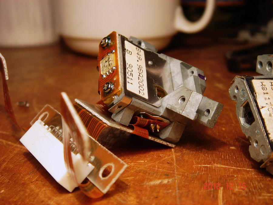

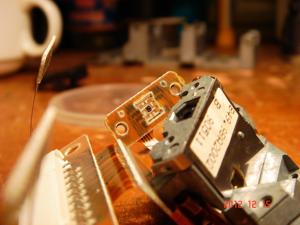

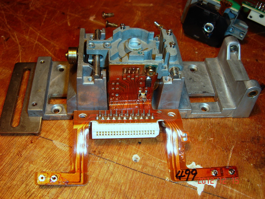

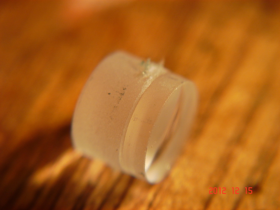

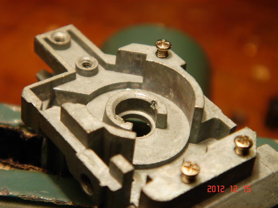

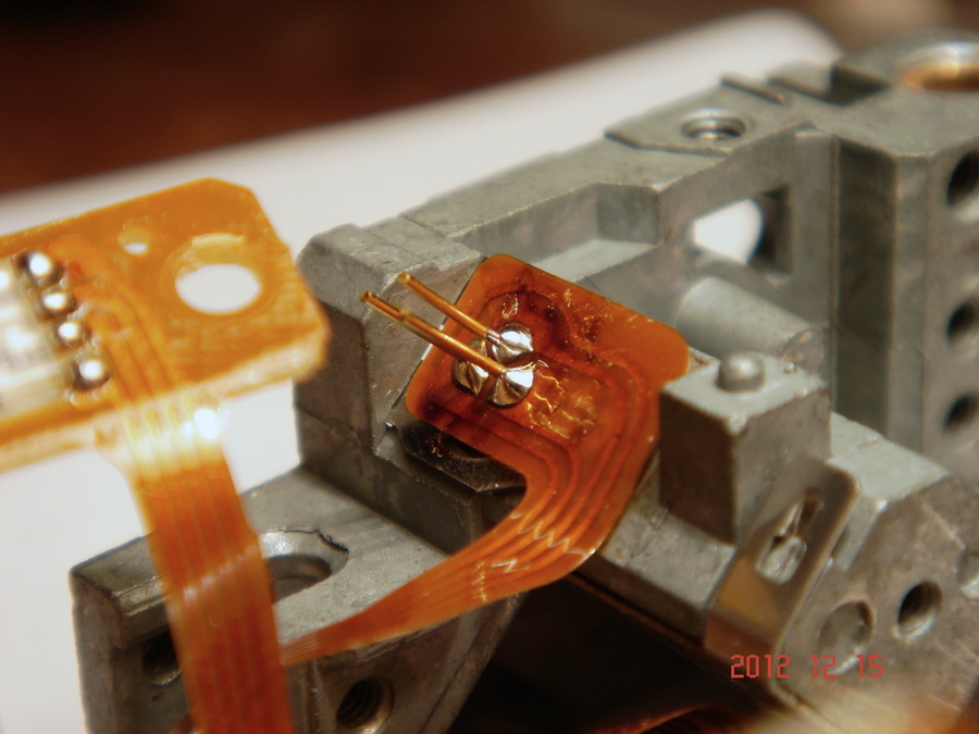

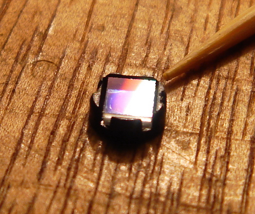

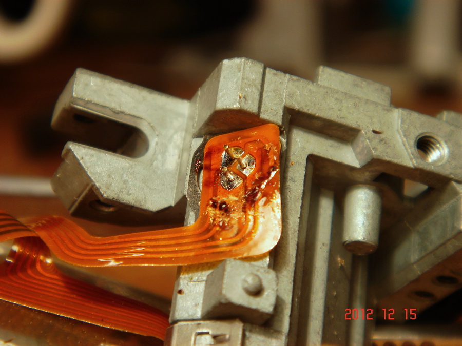

Please look at the pictures of TOSHIBA Laser pickup for KENWOOD DP-8010 CDplayer
When i set the disc in-- NoDisc!!! So i repairing it a few days ago,clean the optical lenses and change laser diode😀😀

continue...

Nice work! What Laser Diode did you use? What are the specs and Manufacturer. Thanks for posting this information.
Hello WAR415,thankyou for your reply! I use the Rohm laser diode , model for the "RLD78MYA1", package: To-18 (φ 5.6mm ) Fig1 , you can refer to the following PDF file
by living🙂
Fantastic! This is great information because this laser is impossible to get. Now I can keep my vintage Kenwood DP-8010 going, which is one of the best sounding players I've ever heard and I owned many. Thank you so much.

And another question to living:
How do you actually remove the laser diode, do you pull it out after resokdering, or ?
Thanks a bunch!
