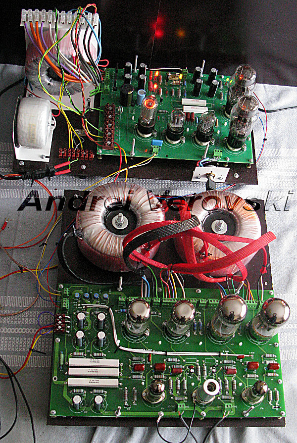

I have posted several times regarding this subject. Despite certain difficulties, toroids are really worth trying.
This is my draft build of push-pull amp using all-toroid design.

I do have a web page with pictures and some schematics but it needs some repair. I will fix it and let you know. Mine did not win because a screw had loosened on the drive down to our meeting place and a channel was not working. At a subsequent meet, it sounded better and more powerful than another of the contestants.

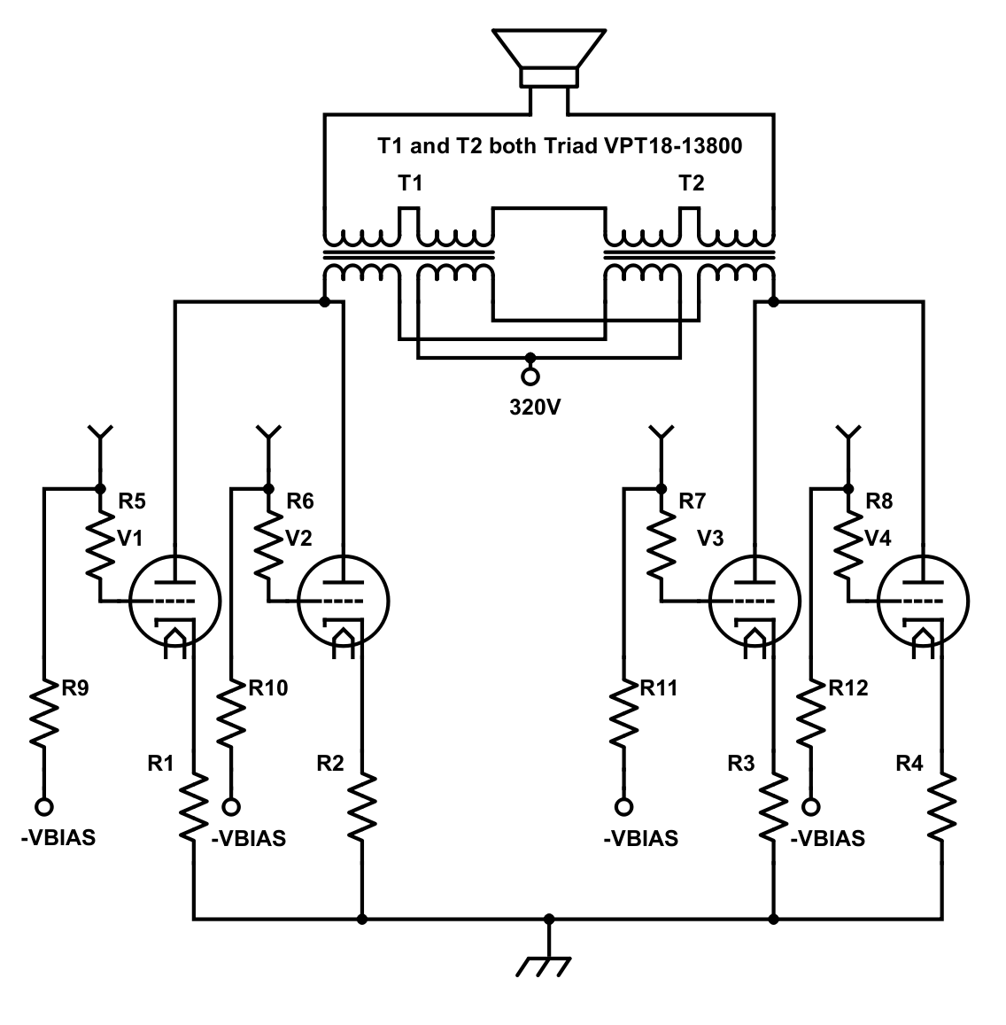

In a regular circuit, I totally agree with you. But mains transformers have been successfully used as output transformers. Have a look at this design :

I'm using a pair in series connection for my monoblocs. I get full power (112W) at 30 Hz this way.
