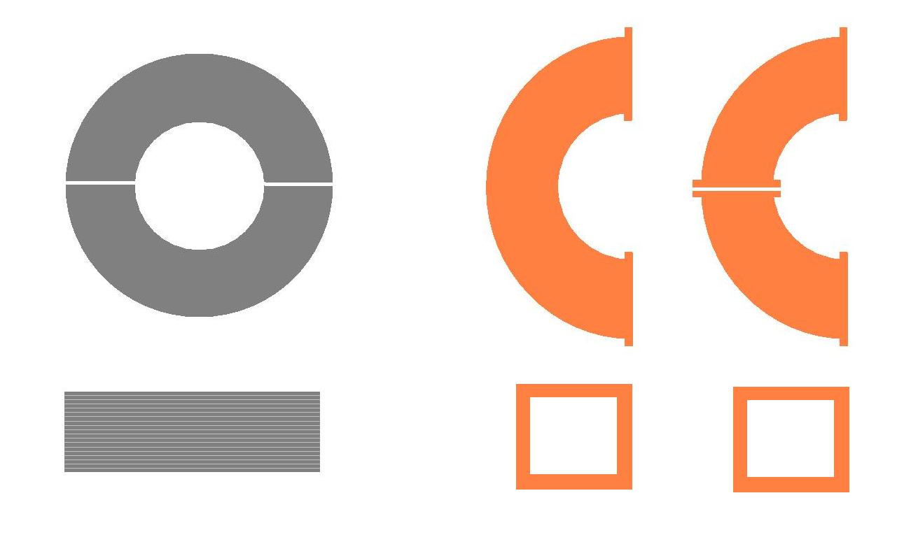

'piece of cake' 😉
why not cut a bundle of 'half moons' of transformer iron sheet
make two half moon plastic bobbins for the winding
when forming a perfect circle, they should all slide very easily into each other, and voila, a toroidal double C-core
'piece of cake' 😉
Maybe possible mechanically, but makes no sense at all.
What is to gain with this?
Good quality c-cores are annealed after forming; bending iron to form a core without annealing will impair the quality.
At the end I see no advantage in winding a circular core (with all possible haphazardness) over winding a neat straight coil for a c-core.
not bending, or rolled
stacked iron
with plastic bobbin
like the ususal
just different, toroid style
I dont know if theres any advantage, no clew, nada
nor do I know what kind of winding machine needed
but with bobbin, open winding should be possible, and different from regular toroid
but one major problem
I guess no parts available anywhere
but hey, this is DIY, right ?
