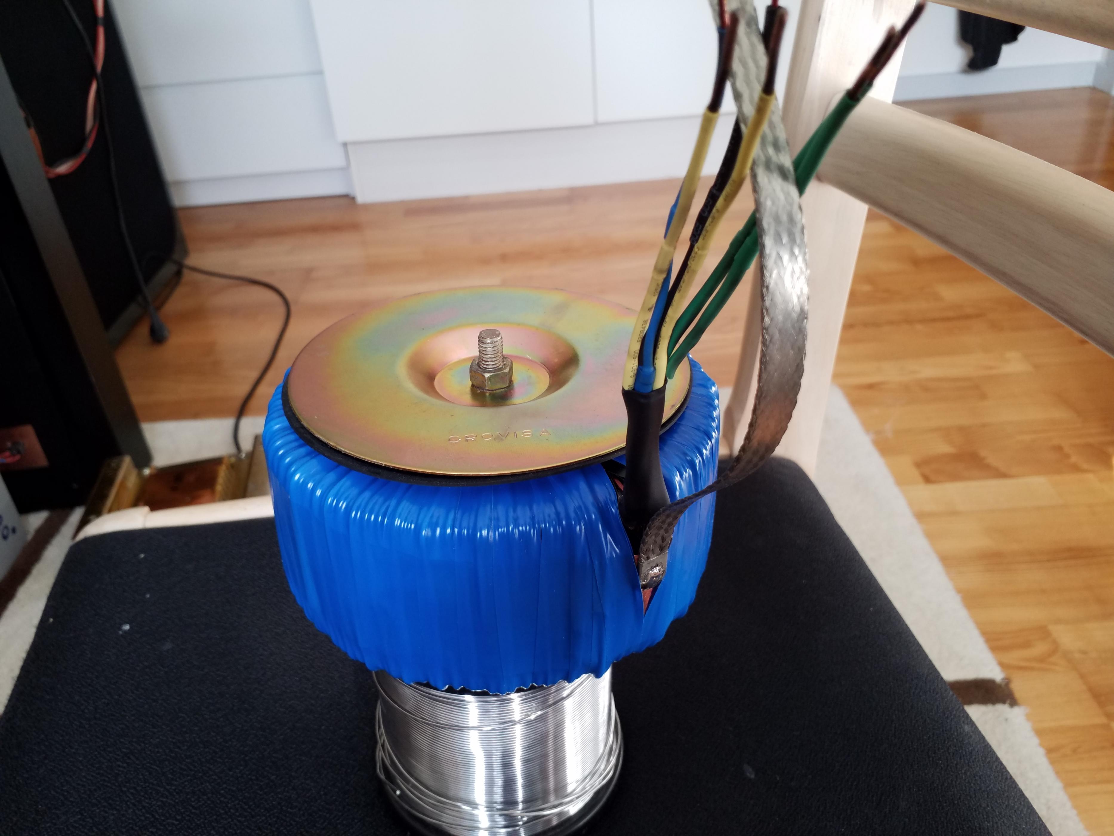

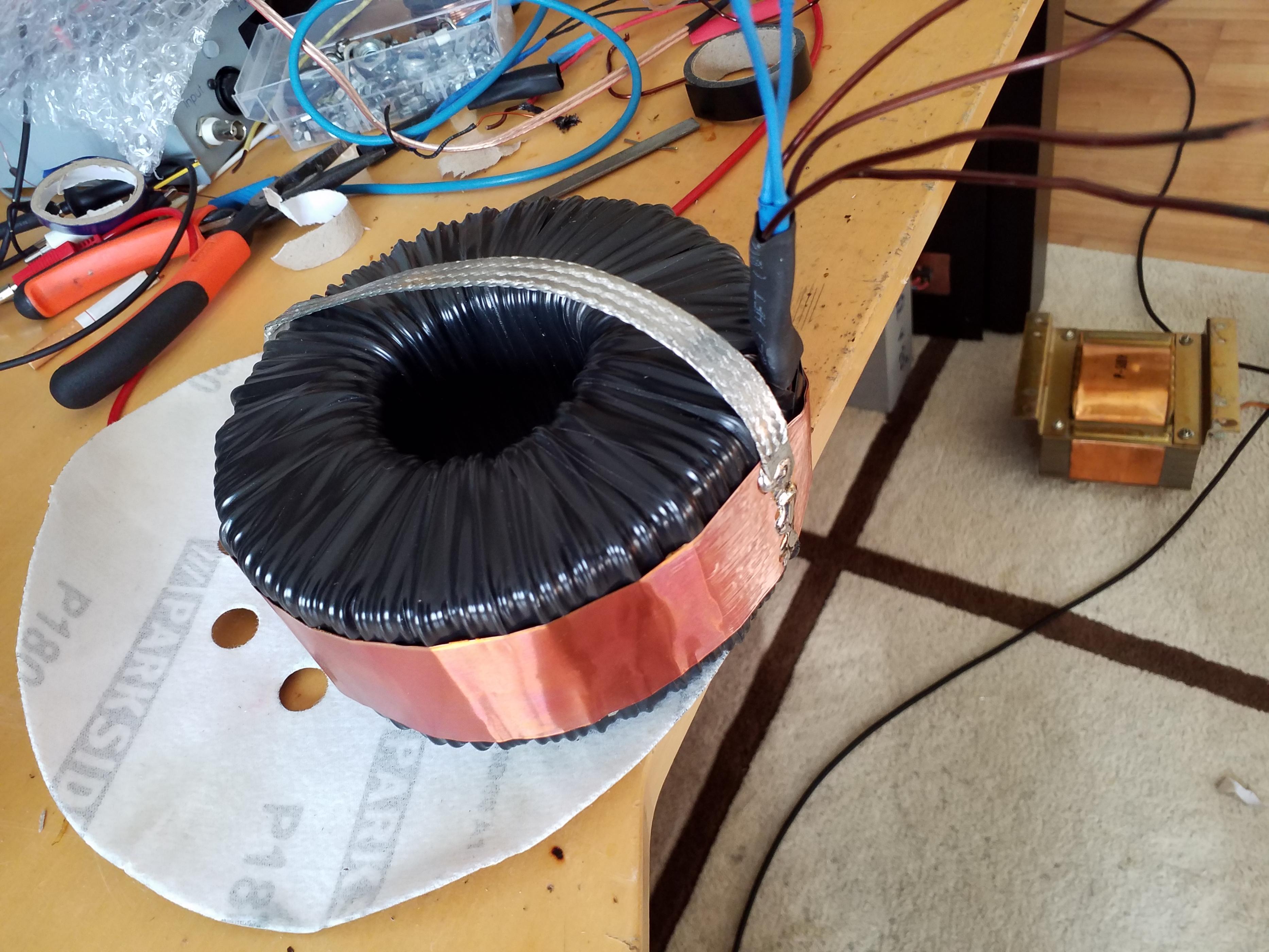

But just finished it, I added a copper belly band with ground litze attached, and two spools of black and blue electrical tape, think it came out nice.
Thanks again guys for helping me out

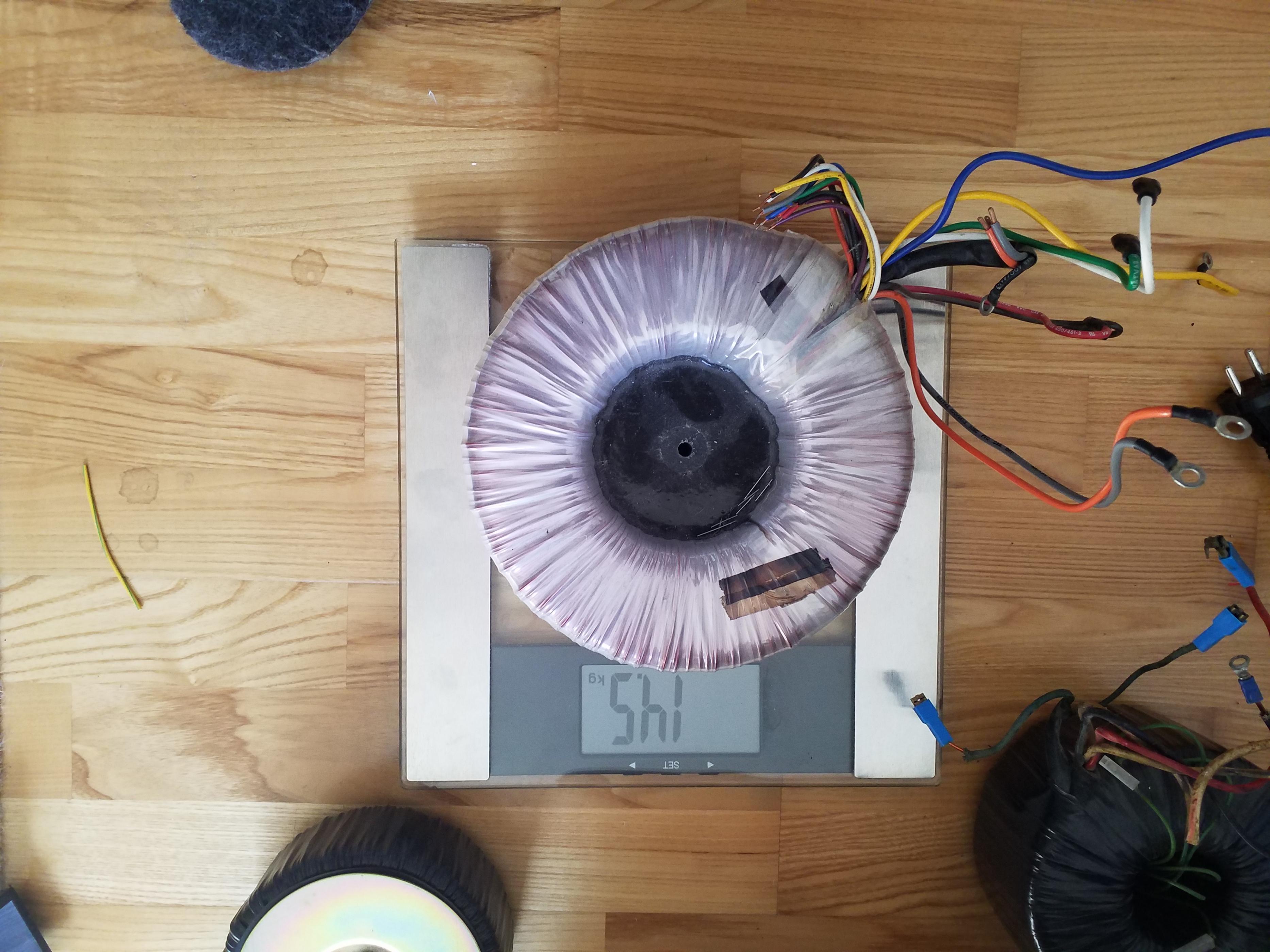

I checked my closet and found this beast, it has some for me not usable voltages,
Dual 65 volt 7 amp , and dual 77 volt 0.25 amp, plus an auxiliary dual 15 volt 1 amp.
Around 2kw in total. 22 centimetres diameter, 8 cm high.

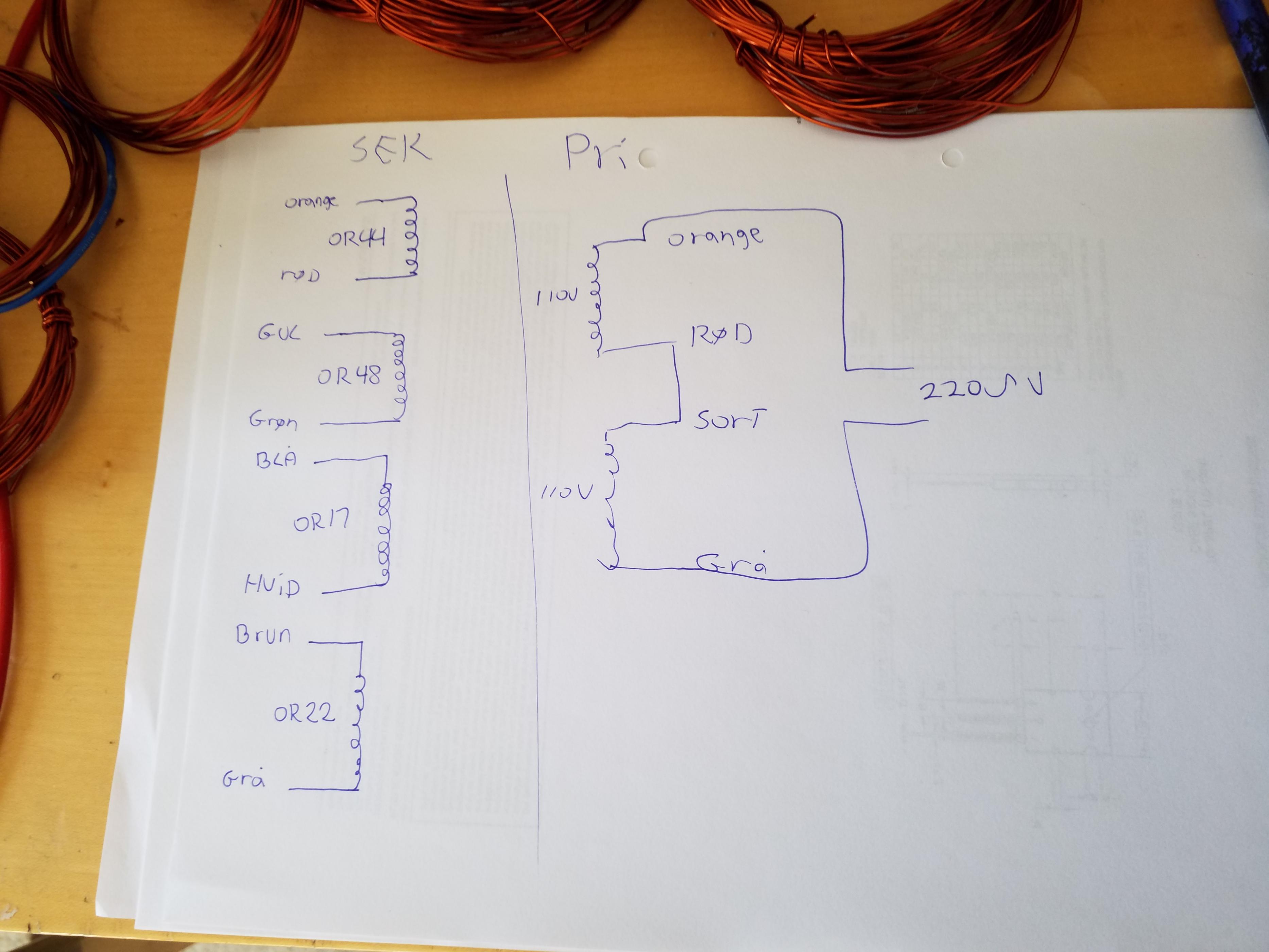

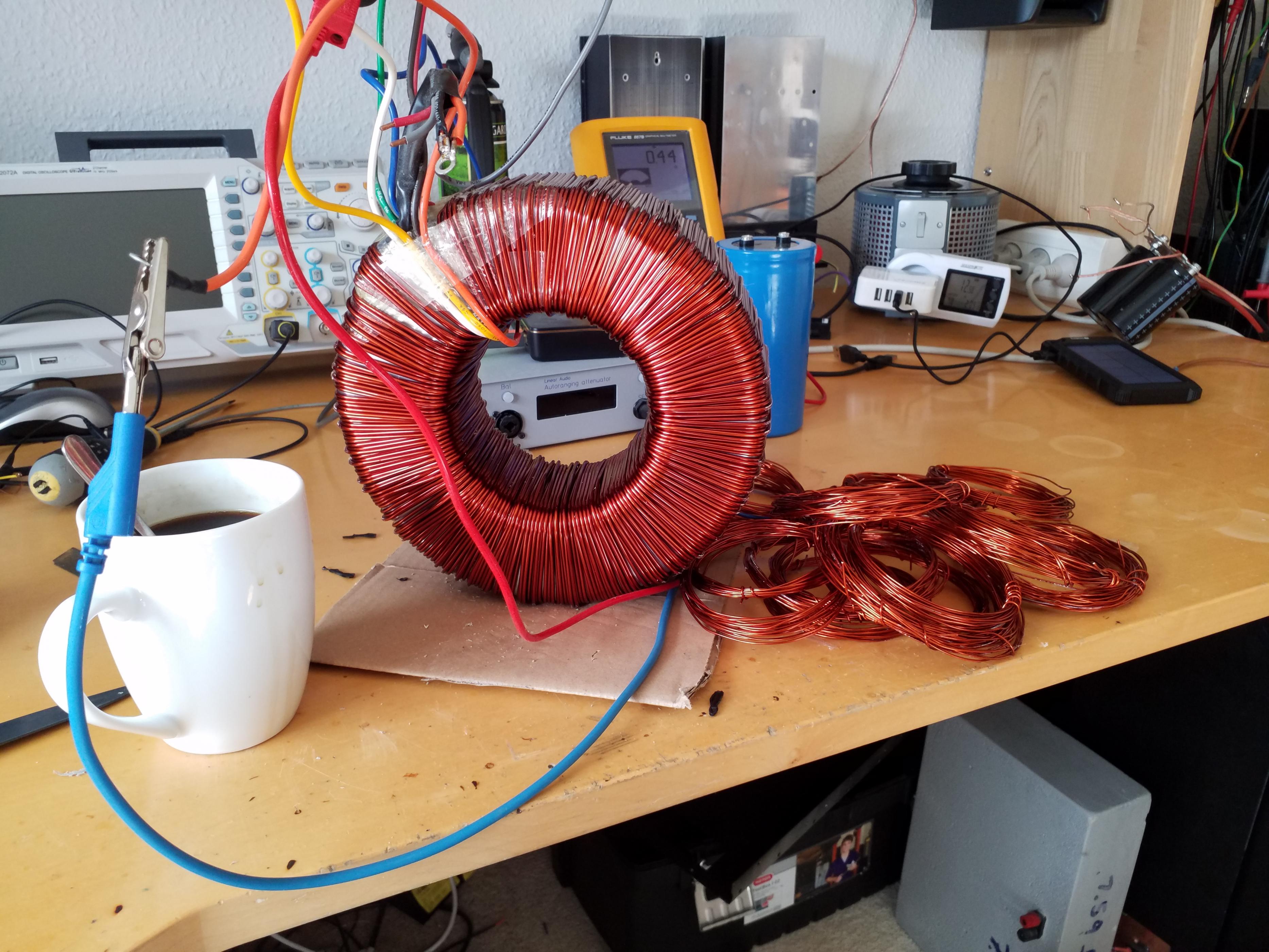

Today I started to lower voltage on the big toroid shown, I removed some dual 77 volt turns I did not have use for, they were also low current approximately 1 amp, as shown in pic that are the rest, 65 volts I would like to lower to 45 volt, my problem is the primary, there are two, and because I have 230 volt I put them in series, I connected them to my vario in order to measure the actual volts in secondary, but it draws alot of current as if it is shorted, is the reason the size of that thing?. Am I not able to saturate the core or is there indeed a short ?
Primarys are 0.4 ohm dc.

That might be it, I just tried powering up with a softstart circuit and a 3 amp slow blow fuse, it evaporated literally , I will try reverse them, thanks alot,

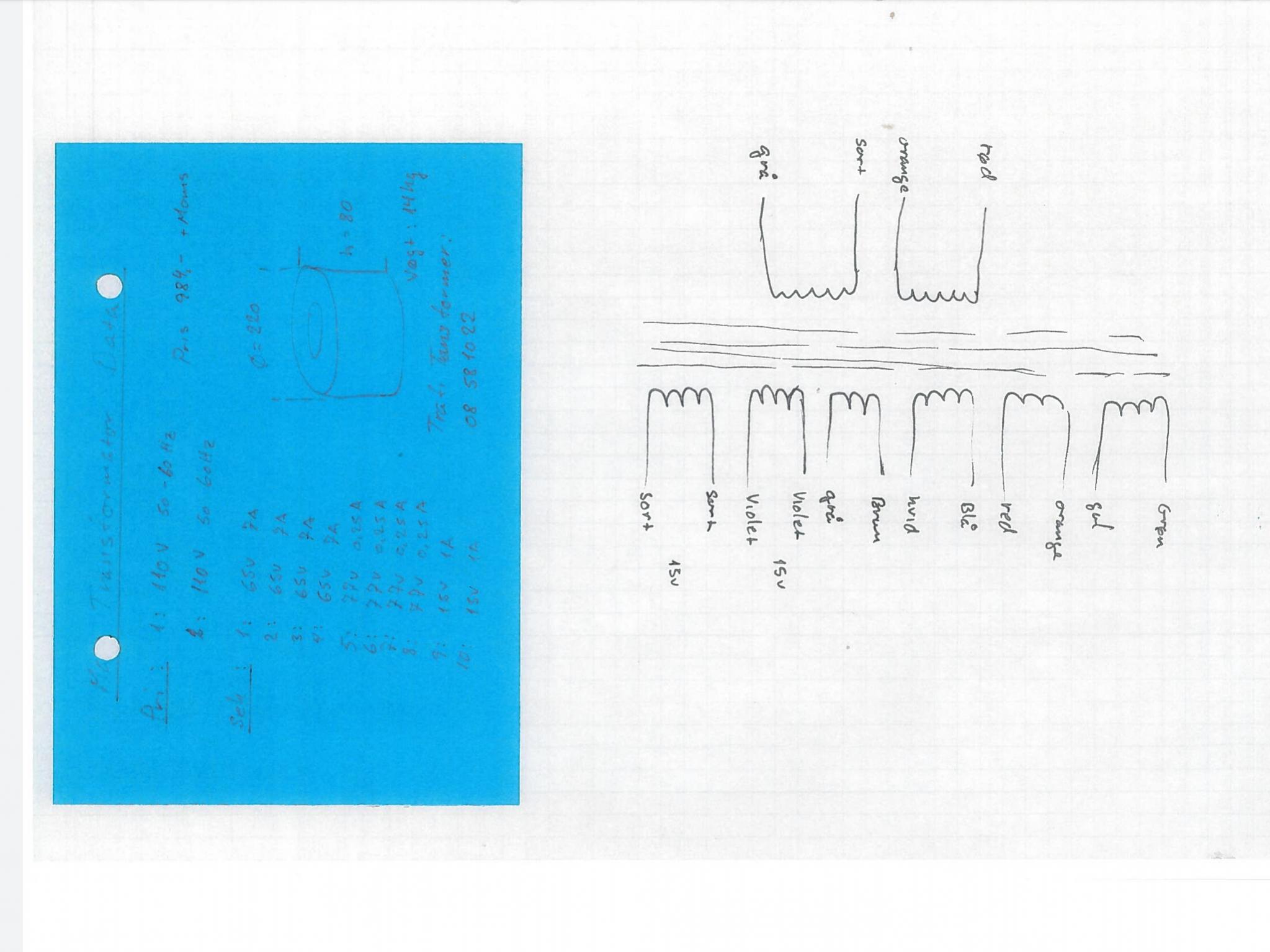

Added the original paper on the toroid.
I connected black and orange to do the series
