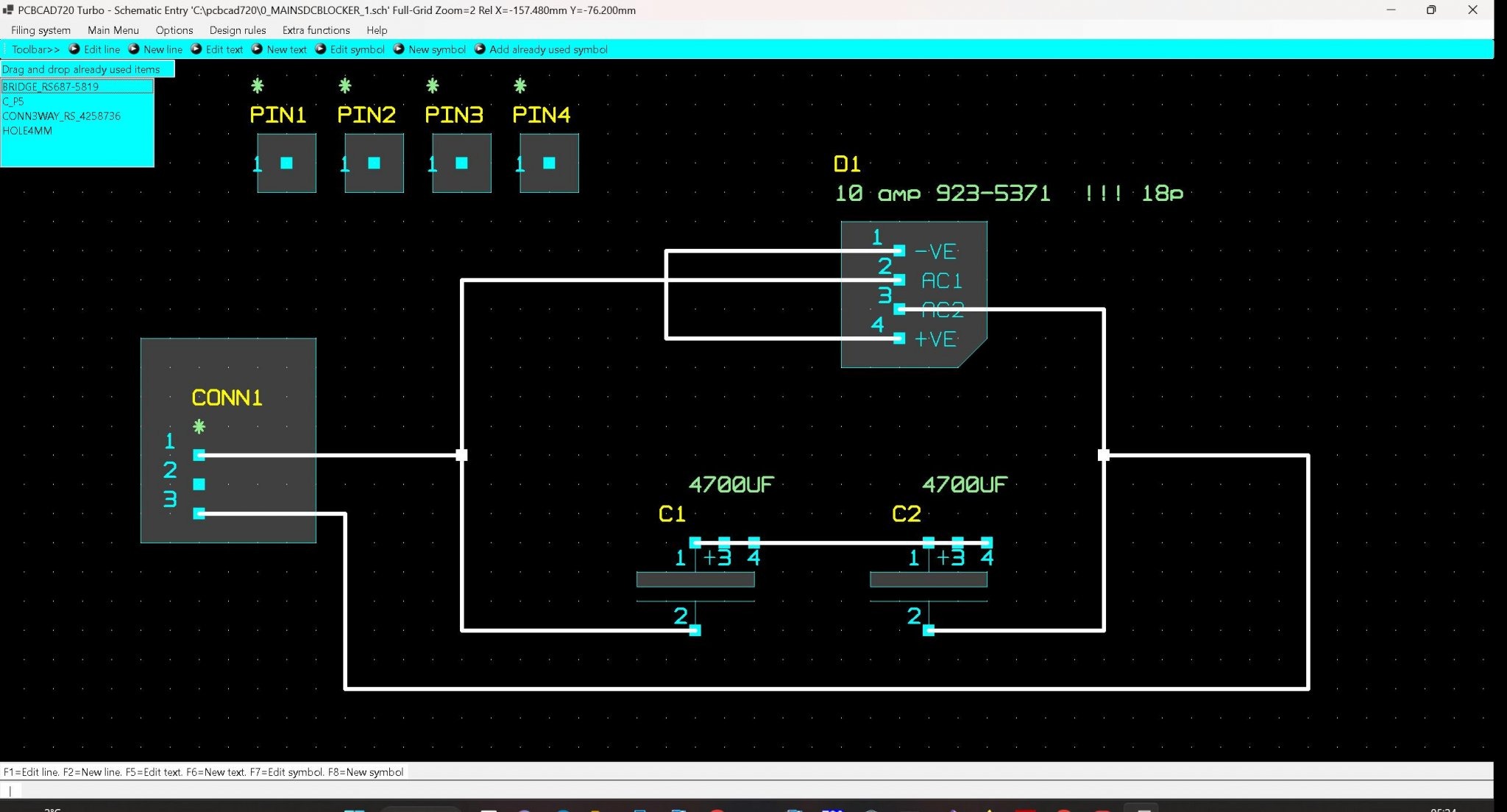

Also a symptom of DC on your AC incoming from the wall. DC offset will make them buzz. You can easily make a dc blocker for a few dollars. It’s not a bad idea no matter what is going on.

A noisy transformer can be DC on the mains.
Requires a mains DC blocker. 4 diodes and a cap.

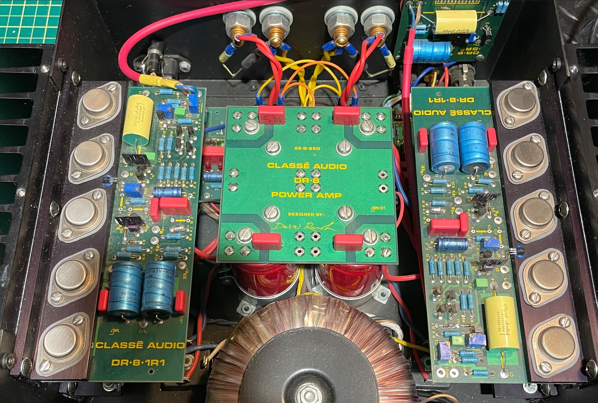

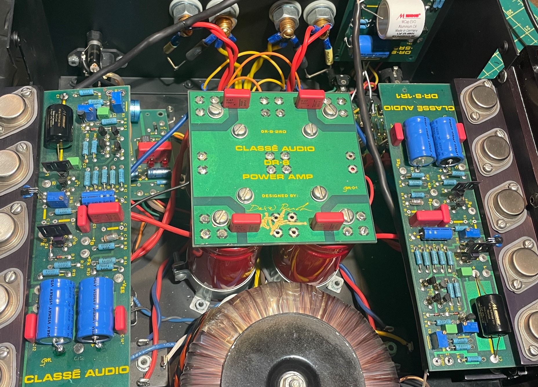

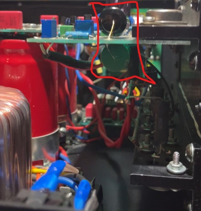

Guys, I appreciate all of your responses. The work I did was really on the amp boards and signal - caps and wire. No change to anything power. I've attached some pics, if they show anything. I'm generally obsessed with cap polarity, so ensured that was of course in check. I did a little maneuver bypassing the signal film cap with a .1uF mundorf, great results.
I didn't touch the main filter caps, since they are $80+ each. The power board I was going to replace the electrolytics, but on the underside had all sorts of surprises I didn't feel like dealing with - resistors, transistors tacked to the main cap, so I just left it. Still have the replacement caps, maybe I'll get to it. Not thrilled about ripping it apart again, but will. Since yesterday all fine again - I can't say I've ever had an amp do that, only to just reset with a power cycle.

That is not an DR-6 AFAIK and yes of all caps the main filter caps need replacement most, certainly in power amplifiers 😉
Please measure the rectifiers and replace them just in case (to exclude them). They did a good job for decades and better retire in time. Low cost so no drama and imagine the damage when one diode becomes a short circuit which is the usual error mode. The symptoms would be similar to what happened but normally the faulty diode does not recover. Same would apply to a faulty filter capacitor but those can recover. Transformer failure is more rare but still a possibility. Last possibility would be one of the circuits having an error that causes large currents.
