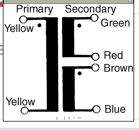

Toroid Primary 2 Yellow Wire Wich one is + , -
Hi
I have two toroids wich i would like to use as step up transformers.
The 7V windings are on the amp side and should be wired in parallel and the 230v output windings should be in series and center tapped to the bias power supply.
so the 230v output windings have both the same color and i don't know wich one i have to connect
thanks
attachment.php
50 VA
primary 230 VAC, 48...60 Hz
secondary 7 VAC (2x)
Prüfspannung
4 kV
  • Schematic Toroid 230:7 VAC x 2.png
Hi
If both wires for the 230 volt winding are the same color and don't exit the transformer in physically different locations, there really isn't any way to know other than try both possibilities and measure the results.
1) Apply 1Vrms to all 4 of the primaries. You should measure about 30Vrms on each of the secondaries.
2) Now connect together one yellow wire from transformer #1 with one yellow wire from transformer #2.
3) Measure the voltage between the two remaining free yellow wires. If you get 60Vrms, you guessed correctly and the wires you connected together should be used as the center tap.
Don't forget to mark them so you don't have to repeat this test again later 😉
4) If you get close to 0Vrms, you guessed wrong. Switch the wire from transformer #2 that you have hooked up with transformer #1. You should now measure 60Vrms between the remaining free yellow wires.
Good luck!

Hi
Thank you bolserst
I found out which two yellow wires are connected to the center tab.
the bias power supply I want to use has negative output.
I have now two remaining free yellow wires which go to the stators does it matter which one is connected to the front and back stator ( like + /- with normal magnet speaker) ?
thank you
hi hironimo,
Yes, switching which wires go to which stator changes the phase just like swapping +/- with a magnetic speaker. You can also switch the phase by swapping the connections to the transformer primaries.

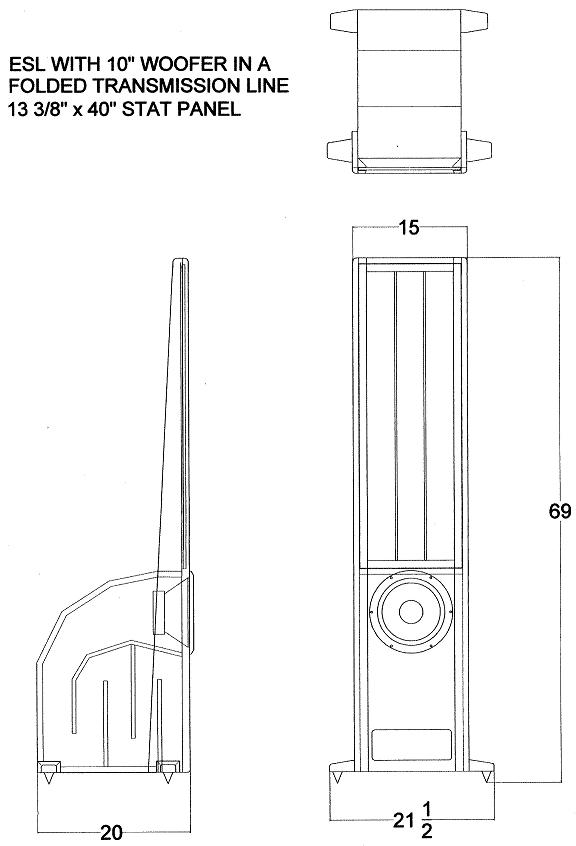

Hello again Hironimo,
Correction: I earlier stated that my panels were 12x40 but they are 12x48. Still, I think 12x40 would be adequate for a hybrid. If you do opt for less width panels, you might want to check out Roger Sanders' Eros speakers shown on the Innersound website here: Electrostatic Speakers & Electronics - Sanders Sound Systems
If I had seen Sanders' Eros speakers before I built mine, I might have copied his design rather than go with my beam-splitter design. Sanders' speakers use a compact transmission line with servo-controlled 10" woofers. I think the length and volume of the line is somewhat less than optimum and you'd need to compensate with higher density stuffing, which would cost you a bit of output-- still, for me the greater sonic advantage of a TL is the lack of compression, resonance and the resulting lack of coloration-- not necessarily the extra depth and power that you'd get from a more optimal line.
Attached is a scan of sketch I made-- basically a copy of Roger Sanders' Eros speaker, with 13 3/8" x 40" electrostat panels . I also have a drawing file in DFX format but it wouldn't upload here so anyone that wants it can PM me and I can email it.
Again, good luck with your project!
Charlie

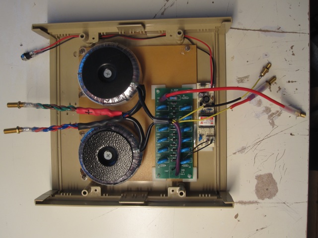

hi
today the perforated metal sheets arrived, they are 16 x 40 not like i ordered it but as
charlieM and bolserst recommended it is better than 20 x 40 so i'm lucky with the wrong delivery.I almost finished the electronics so my plan is to finish the panels and then take care of the TL
and thank you mavric for your info about the crossover
attachment.php
so long
hironimo
