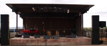

you have a picture of this set up?

Twenty 8" speakers were not quite enough to keep up with the pair of 18" TH subs at 100 Hz, needed another eight 8" to get enough clean output around 100 Hz.you have a picture of this set up?
The outdoor picture shows the tops on top of dual Lab 2x12", the third cabinet up is a 4x8" without the HF drivers. The Keystone TH is the same size as the pair of dual Lab 2x12".
The top cabinets on a stick on the right side are covering a dance area to the side of the main coverage.
The top cabinets are 11.25 tall, 15" deep, 26.5" wide.
The straps have been painted black since the picture 😉.

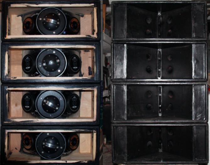

Art, i have messed around with a drawing similar to your cabinets, only with 12s.

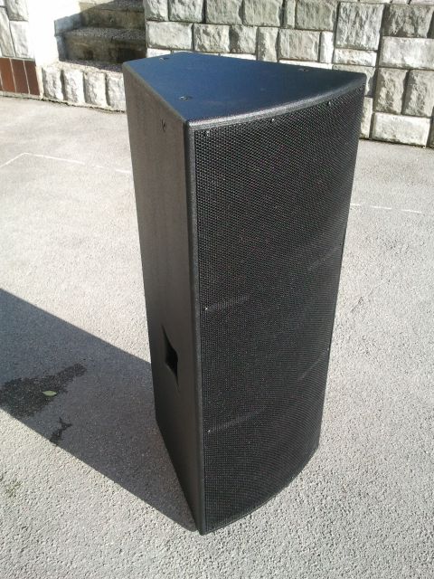

I would suggest a normal BR design. I had the same problem finding the right tops for my LAB subs. I really like horn designs but it's hard to make them go low enough to meet with modern subs. So we decided to try a BR approach. From all the horn building we done I almost forgot how nice a god BR design can play 🙂

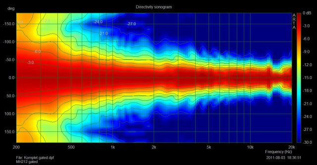

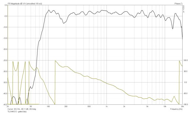

We decided on a 2x12" + 1,4" combo. Mid drivers are B&C 12NDL76 and high is 18sound ND1460A on a XT1464 horn.
The dip around 190Hz is from the height difference from the ground to the mic. Ground plane measurements show a flat response.

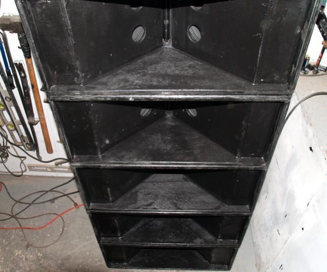

aren't your "unity" ports a bit big?
Most of the designs you have seen are probably using 4-6" drivers, which have a smaller enclosed volume behind the ports.
The ports are fairly close to the ones used on the VTC line array (Danley licenses the Paraline and Synergy concepts to Yorkville, VTC is a subsidary of Yorkville) which my design is similar to.
I determined the port size through testing several different sizes, too small or too big both have problems, getting it "just right" took a while.
Modeling in Hornresp would have narrowed the port size selection process down quite a bit, but I (re) built those cabinets in 2008, and only got in to Hornresp last year.
At any rate, I have never been happier with a system than this one, the dispersion is completely uniform (-6 dB at 45 off axis) over 90 degrees down to Fc, and the line array/Paraline effect makes the front to back coverage very consistent.

If going front loaded, the "rule" would be a vertical alignment, HF horns on top, possibly with a mid rolloff on the lower 12" cones.if i went with the 4 -12" and 2 compression configuration, what are the rules for locating the 12" so they don't suffer from cancellation.
If using a Paraline/Synergy horn approach, the port exits should simply be placed as close to the horn apex as possible.
A 12" will acoustically fall off around 600 Hz with the Synergy style port loading, which is a (huge) stretch for most 1" exit drivers, you would probably need a 1 12" to 1 1" ratio to keep the HF driver excursion low enough to keep up.
The VTC EL210 uses 2 x10" and 2 x 1", the 10" only make 650 Hz before a rapid fall off, my 8" design only goes a bit higher.
The 3" diaphragm EV DH1AMT HF drivers I use load down to around 300 Hz, over an octave below the cutoff the VTC 1" has.
