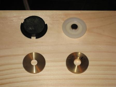

Hi Khundude,
Regarding clamps for a top loader you can always make one. I used some brass rod and had a friend cut some slices and machine them into discs. Most small engineering companies or anyone you know with a lathe would be able to do it for a small cost.
In the pic attached there are 2 brass pucks of slightly different mass. On the top left is the puck from a Marantz CD94 II. On the top right I have added a small neodymium magnet to the white plastic puck from a Philips Cd104.
I found that the mass of the puck can effect the sound, the light one with the magnet gives a very open sound. I originally started with washers and Blutac and varied the mass, about 50g for Philips based swing arm drives is ok.
Rich
