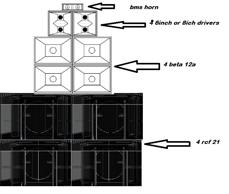

i moddeled this
im gona make this model this week ,and test it.
so the plan is the 21"to ~90 hz,then the eminence 12 to ~800-1000hz,from there the bms with the wave guide above.

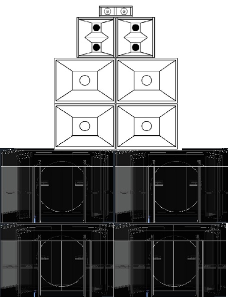

its gona be something like thisPics?! 😀 😎
i moddeled this
How I understand .

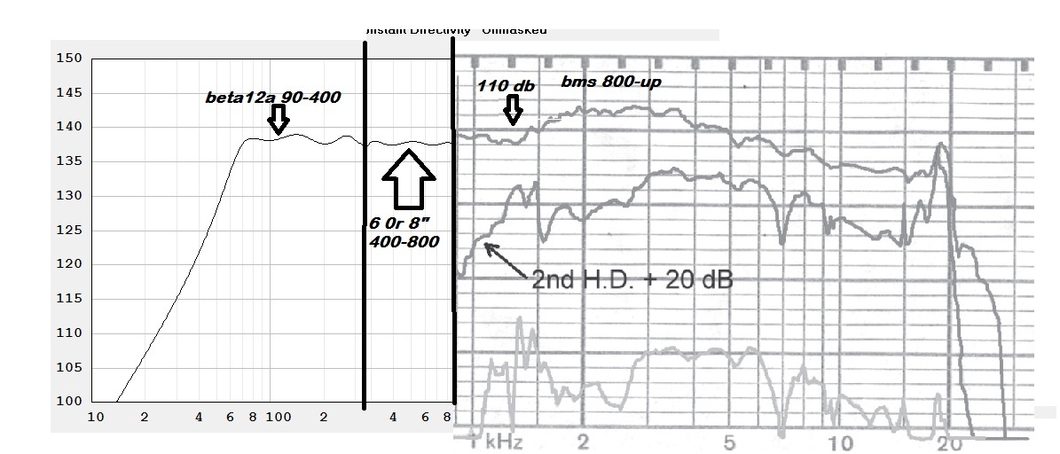

Erik what do think of the delta pro 12 compare to the beta 12a

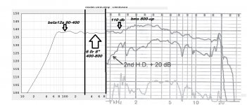

the beta 12-A-2 models better.
from 550 to 1000 hz freq responce rizes 4 db,this fits exactly in the horn fall off.
Now i understand what you're do.
The beta 12a will cover the low bass and little of the midrange, the horn will pick up where the beta 12 roll off.
exactlyNow i understand what you're do.
this way you need less amp channels,=less x-over ,less phase/delay probs, less speakers.
The beta 12a should produce enough kung fu kick as the sim model show.
In jamaica we love when our kick and midrange stands out,feeling that kick in your chest and the highs ringing out,makes you feel good.
When this system is completed , i can play it and lift my headup with joy, my old system is way out dated and sound like sht.

this way you dont waste energie in the wrong place.
excelent horizontal coveridge,litle "lobbing"
could be done with 3 amp channels.
(why put an 6 or 8 inch in play when its not nececerry?)
Your drawing look better than mine.
I was reading the void system paper and I check there website , they use the same setup that you are talking about. So I am going to stick with your setup, no more changing my mind.
