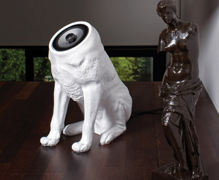

Here are a couple of ideas.
Note: I do not imply that with respect to SWMBO that they are good ideas!😀
Woofer Speaker System by Sander Mulder for Cultivate - Free Shipping

c2cthomas, that dog is awesome. Not quite our style, but nevertheless a cool idea. What is SWMBO?
SWMBO = She Who Must Be Obeyed 😉😀
Does not need to be dog! Could be a cat! Maybe a dragon? Beer Keg??? 😀😀😀
The concept is to "make pretty" the device that holds the speaker. I had thoughts about exactly where you could place a speaker port in the bulldog - but I'll leave that up to your imagination. 🙄
