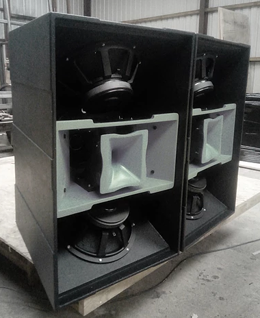

It seems like a bass horn, but the two speakers with its motor free to outside looks ugly. And dangerous in children presence.
The exposed drivers are tapped horns. In the center there it looks like you have a midrange horn with a treble horn nested inside it. Interesting design. Check out weltersys's syntripP. Thats nested, but no tapped horn sub.
is there an optimal angle for the 2 woofers in the design ?
Designing the exact dimensions and angles of the box requires you to simulate it in hornresp. many hours of study and work to settle on a design. Fun for us, but not easy or quick.
