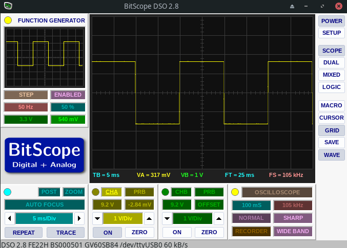

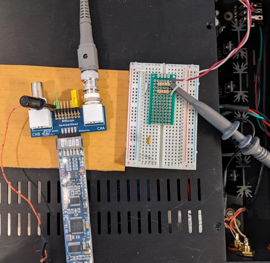

Test Setup:-- Whammy with BitScope.

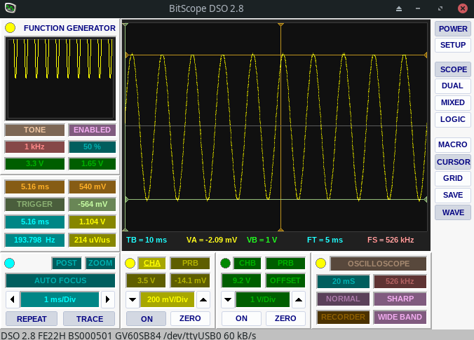

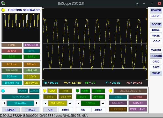

The BitScope output is applied to the right channel input. The resistor load is a connected to the phone jack to monitor the channel. The BitScope outputs a 1khz sine wave. I set the scope cursors to track the output amplitude.

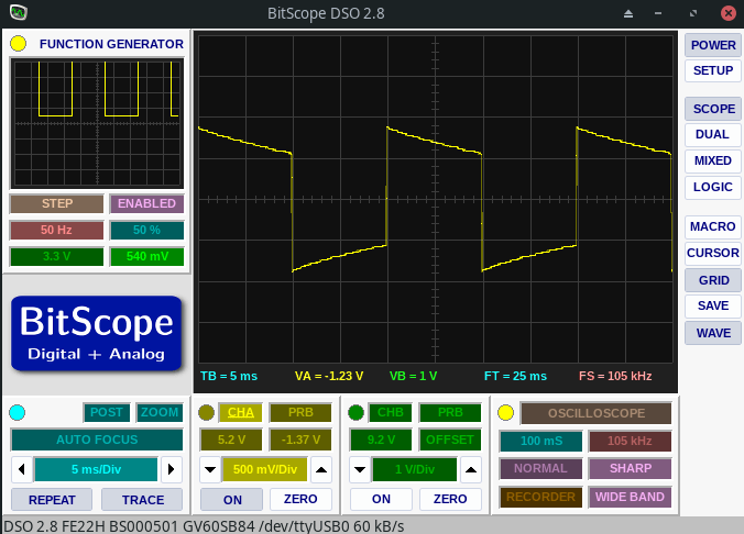

Next I applied a 50hz sine wave to the right channel input. It's perfect on the input side of C1.
But the square wave is sloped on U1-1 and the output jack.

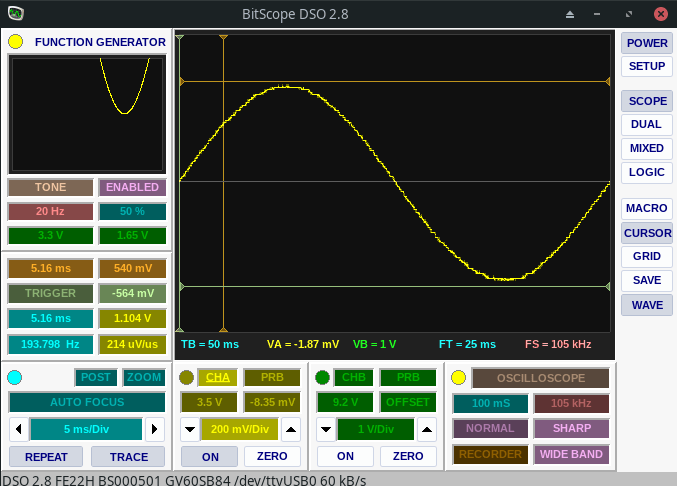

The 20hz sine output is reduced slightly.
The 10hz even more.

- Whammy complete kit
- JRC4080DD (came with), JRC2604AP, JRC4562D, OPA2604AP, JRC2068D
- BitScope Micro BS05U
- Two 15 ohms in series to load the right channel.
The 10hz even more.

Well I was not mistaken about the freq response which was flat from 50hz to 20khz and beyond when I tested again. There are some measurements done at the end of the build guide which I overlooked when the build was finished.
https://guides.diyaudio.com/Guide/WHAMMY+headphone+amplifier/3?lang=en
Step 30 shows the frequency response.
So the freq response alone gives no evidence of variance in my small stockpile of opamps. However, it suggests that the bass could be more existing by replacement of the input caps which are beside the ALPS volume pot.

Not sure but it seems to me that edges of the squares shown in the OP are not clean. It would be interesting to see it with 10x shorter time base.
I think you see the limited bit depth of the scope.
You see it also on the function generator output.
jan
jan

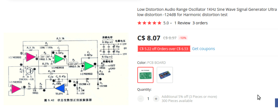

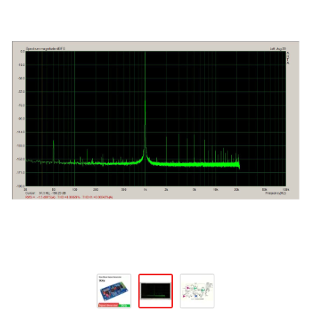

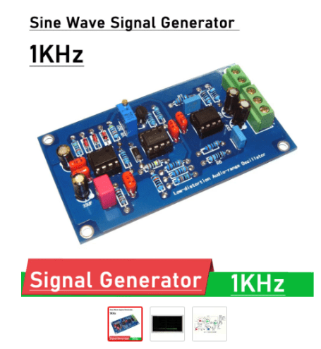

I been reading about precision 1khz oscillators that are hard to diy. For example,
https://sound-au.com/articles/sinewave.htm#s2 .. there are other papers on this topic
Here is a cheap no-name, no-blame, that declares to be good for THD.
