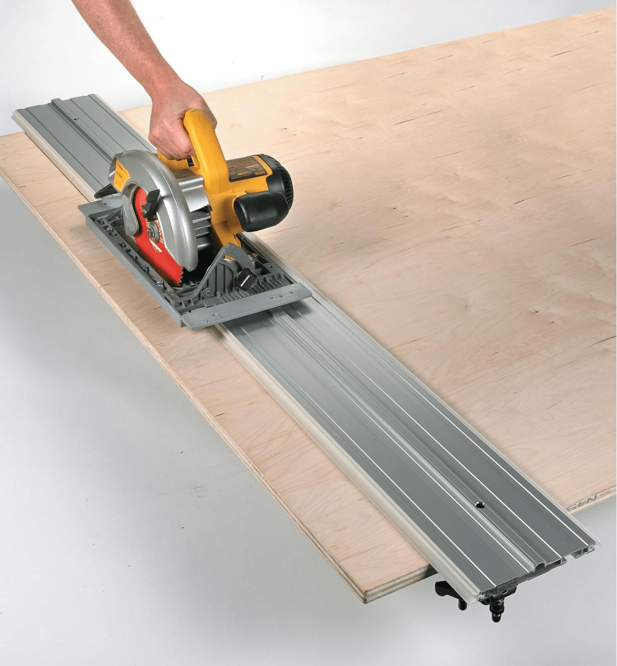

Sorry to ask all these questions, but have you got an idea of the speakers that you wish to build? You may find using an electric circular saw (such as this) https://www.makitauk.com/product/hs6601.html and a straight edge or tracks/rails a better option. A couple of cheap workmates https://www.screwfix.com/p/black-decker-workmate-workbench-610mm/63272 will also mean that you're not working on the floor all the time. I say these things because manipulating a sheet of MDF or Plywood on a small sawbench is not the easiest of things, and requires a lot of room to swing around. A small note (others may disagree) I find that the expanding foam type adhesive next to useless, so use a good quality PVA based glue.

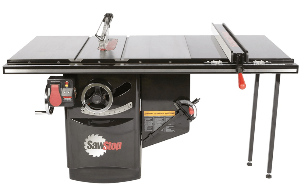

If I were buying tools for making speakers, and I was not interested in other types of furniture or cabinet construction, I would skip the table saw. It is true that a full size table saw makes the job easier
But this kind of saw is quite expensive. $2000 - $5000 USD for a new saw. It is only worth it if you plan to make wordworking a lifelong hobby.
A small portable table saw is not really the right tool to cut large panels of plywood or mdf. It is difficult to accurately cut a 44" x 18" panel from a full size sheet with a small table saw, with the sheet overhanging the saw table by large amounts.
Better than a small table saw, I would invest in a panel saw and a good flat work table. A panel saw is slower than a full size table saw, but it is just as accurate. It will cut a very straight line, and it will cut as accurately as you can pencil the line... the downside is that each cut must be set up, whereas with a large full size table saw, once the saw is set up, multiple cuts can be made. If you are only making one pair of speakers every 6 months or so, the slowness of setting up each cut is not very important. Only if you are making many cabinets a year would this be important.

When I said "panel saw" I should have said "track saw"... panel saw is the old name for this.
A track saw has a long extruded aluminum track which is clamped to the sheet material. The saw runs along the track. It is a very specialized kind of hand held circular saw.

Space limits in mind, one can absolutely and relatively efficiently make airtight and visually presentable boxes with a track/plunge saw as has been suggested, and a hand-full of clamps. After the festool patent ran out a few years ago, prices of these have dropped. Routers are affordable too and are fun to use for small tasks.

I haven't made a cabinet in years but long ago I used a radial arm saw and it was really unsuited to the task. I sold it and bought a Powermatic contractors saw. That had a nice fence and work very well. IMHO, the fence is all-important. The panel saw above also looks like an excellent choice. +1 on butt joints. Not sure if people do biscuit joints, but that might be worth investigating. I always bought the latest and greatest Titebond glue, but there's a reason they still sell three types. If you don't need all-weather performance, the earlier versions might be better.
