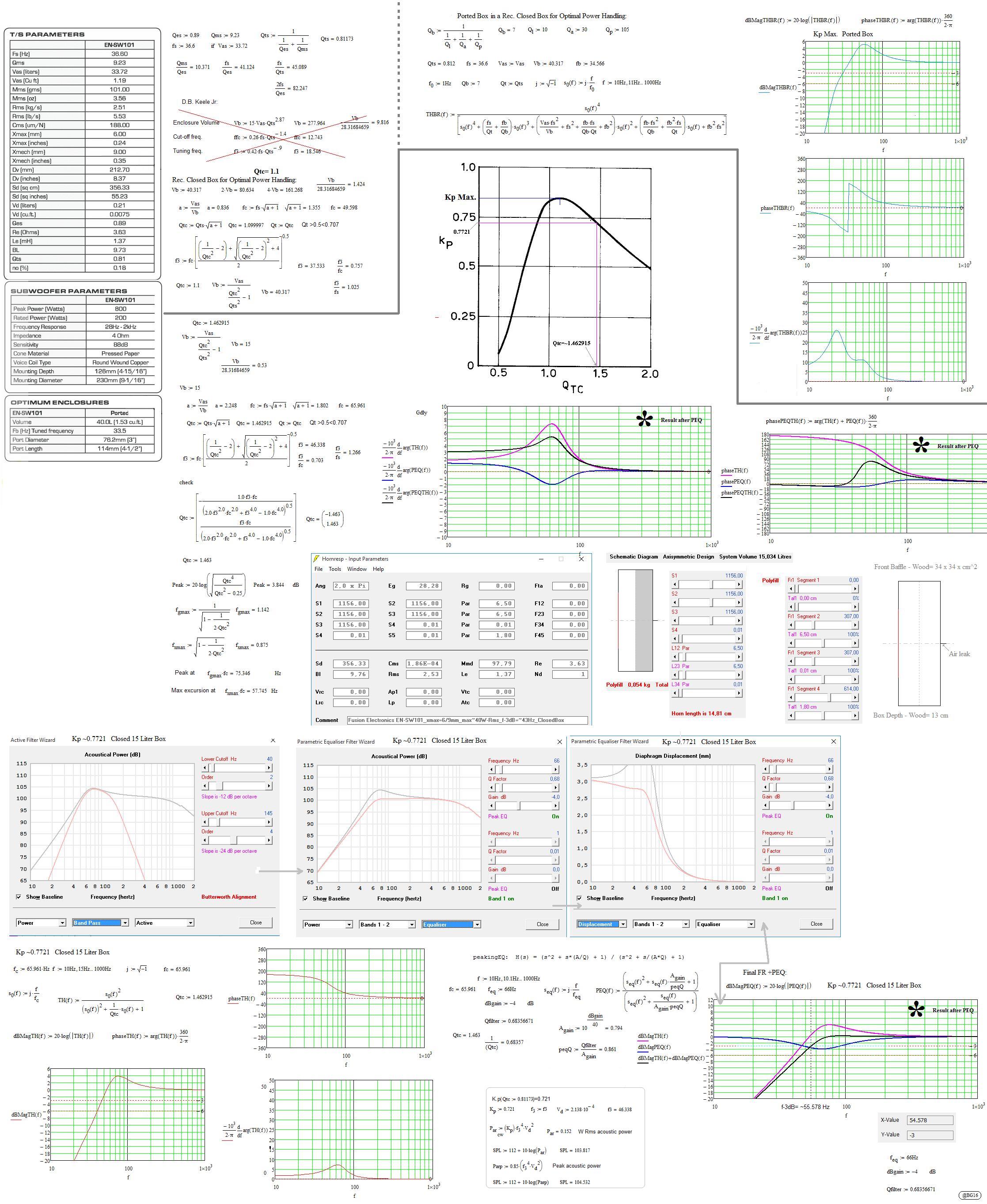

Hi oculi,
Have a look at my :2c: of Sims and Calculations:
b🙂
PS: The 15 Liter Sealed Box needs an Amp. with a built in PEQ.

wow thanks! I only understand about half of that but I appreciate the effort.
it will have a conventional car amp (bridged for the sub and has an LP and HP filter) until the cheaper smaller stuff i order from ebay arrives. unless a parametric equaliser is very cheap i won't be employing one, but my standards and expectations are pretty low and I don't plan to measure the T/S parameters for this thing let alone correct anything.
using this calculator
I did some experimenting to see the effect of box volume on Qtc and was surprised at the large changes in volume required to change Qtc much, and determined that the 15 litre box with this driver will have a Qtc of 1.45 (very similar to your numbers) so if anything I need to make the box as bigger as I can, originally I thought I could get away with making it smaller, because I foolishly assumed the recommended volume would have a Qtc of 0.707 - 1.1 or so.
Forgive my noobness but the PEQ is to get rid of the 4dB hump at ~70 hz instead of using a bigger (just a bit bigger at 15000 litres or so) box? I was briefly considering an infinite baffle setup but didn't want to cut a hole in the cabin 🙂
This is basically a cheap learning exercise that gets to live in a cheap vehicle, I want to make a pair of sealed subs for my home stereo some day plus some other bits and this is a good stepping stone. A friend did all of the calculations for the last sub box I built, didn't realise the calculators were so simple to use.
Thanks again!

Don't forget to include the effects of the car's cabin gain. HornResp does provide the option to include a "room gain profile", and for a car this can be a few dB @ 80 Hz, reaching to over 24 dB @ 20 Hz. So, for car audio subwoofer design, the import part is what's happening between 80 Hz and below, and its power handling through that frequency range.
