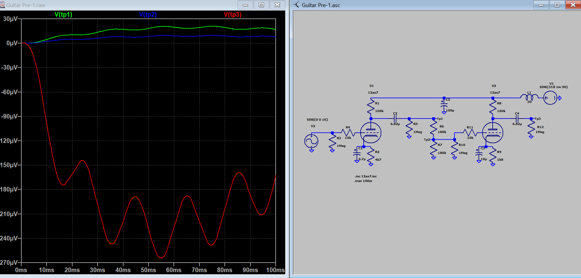

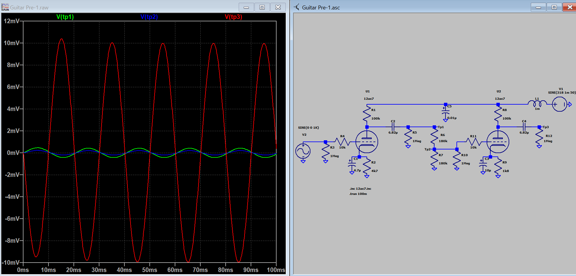

I simulated the hum level in each stage the snapshot attached each one with and without filter. Although the total gain of 2 stages is about 1000, the hum (from PSU) is mostly amplified by 2nd stage. If the hum come from heater supply you can connect and disconnect heater ground to see any difference, or use hum balance pot.

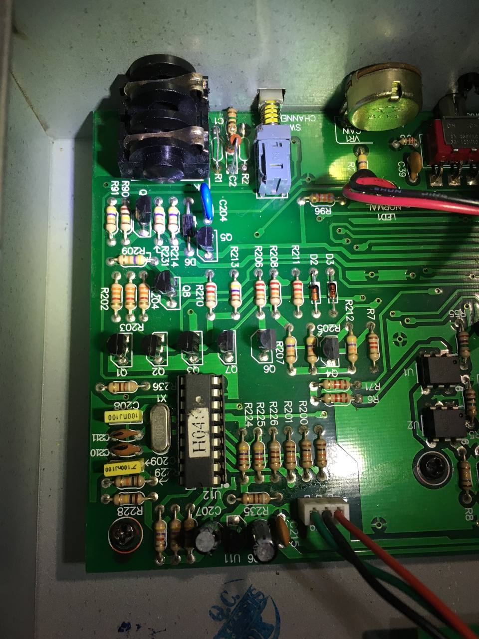

I disconnected one pole from PSU to heaters, no difference. But I think the problem is in topology, it was all the time in front of my eyes 🙂
Right after the guitar input comes controller with diodes & crystal oscilator.
Person who made this descision was so wrong... Yesterday I placed 10k grid stopper (C2 on pcb- after my modifications, and 1 megohm resistor marked as C1. Distance from tube is around 5 centimeters), and noticed that part of pcb became microphonic (due to bad EMI filtering), I will bring back previous value 67kOhm, and solder directly on tube socket.
It should help I hope. If not, then I should find the way how to make shield around input jack and grid resistors.
Also I updated asc file with proper capacitor values - they specified 682uF/630V in schematic, but in fact here amp has 0.22uf, anyway that values doesn't matter anymore...
