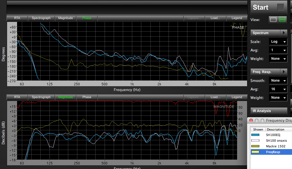

As you can see in the examples below, the flatter equalized response also results in a flatter phase response.
The Mackie HD1502 uses built in equalization, note how flat both the frequency and phase are.
The DSL SH-100 has a dip in FR around 125 Hz, and a bit much HF above 8K, notice how both areas smooth out in phase response when corrective EQ is applied.

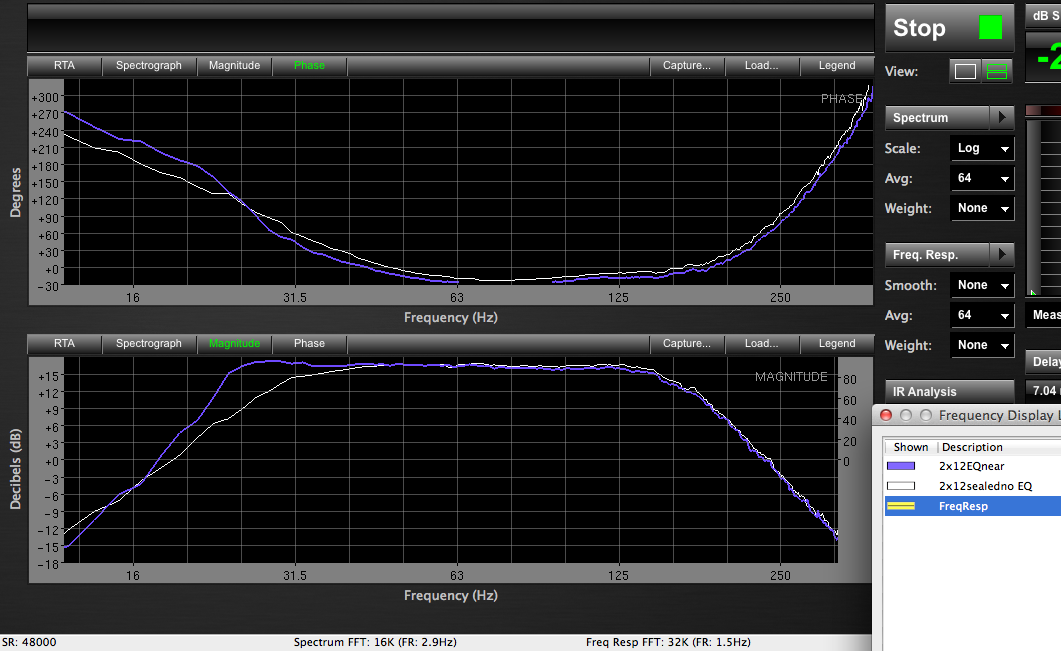

That is not true, at least not with the Alesis DEQ830 I use for monitor EQ for live sound and on my stereo, inserted in the tape loop.OK....but boosting the low end on a sealed sub with either a low shelf, linkwitz transform, or PEQ will produce phase shift and group delay, similar to a ported box.
The screen shot shows my stereo sub out driving a sealed 2x12" sub measured in room, near field (on the floor next to the plenum output), with no EQ, and with EQ flat to 25 Hz, the lowest band on the DEQ830.
No group delay has been added by the EQ as evidenced by the phase in the upper portion of the band pass being unchanged.
As you can see, the phase response in the area of EQ has actually flattened compared to the EQ'd response.
The DEQ830 is a non-combining filter type, the EQ's response below 25 Hz goes back to flat response, resulting in the relative phase change below 25 Hz.
At any rate, not all EQ is created equal, but the DEQ830 does not produce any undesirable phase shift or group delay.

That graph clearly shows an increased rate of phase change with the EQ, which would translate into increased ramp up of group delay. There is no way that can be considered an improvement in phase response.
Smaart 6’s automatic delay locator finds the time offset (delay) between two input signals by measuring the impulse response of the SUT. This measurement was performed automatically for the frequency and phase response measurements posted, without doing it phase traces would not be valid.That graph clearly shows an increased rate of phase change with the EQ, which would translate into increased ramp up of group delay.
The delay measurement requires both reference and measurement signals.
If there was a "ramp up of group delay", it would show as a change in the upper pass band's phase response, and it would have changed the delay noted in Smaart 6’s automatic delay locator, neither of which occurred.
If there is something I'm missing in the interpretation of the Smaart phase response graphs, please point it out.
The GD does indeed increase at the EQd area. But not due to EQ per say, it is just following miniphase behavior where a change in frequency response (here a steeper change in rollof) produces a related change in phase. Phase improves above EQ point due to flat frequency response, and it worsens below due to steeper rollof.
As Art pointed out the same happens when flattening the frequency response the phase flattens as well.
No matter what you do you will have increasing GD at lower frequencies due to LF rollof, making it less steep will produce less GD, by design or by EQ does not matter.
The only way to make it completely flat is to have a sealed sub in a sealed room and EQ the response flat to 0Hz.
EQing a sealed to the same response as a ported cab will produce the same GD. Unless the ported is not miniphase, but all I have measured have been miniphase.
Having a flat phase/amplitude down to where the rollof starts is IMHO better than having a change starting way above that point. Even if the steep rollof due to EQ will produce lots of GD in a big spike, when transforming the frequency response back to time domain (or just feeding the speaker with music) you will have a less altered attack and decay of transients as more of the passband can pile ontop of each other to create a pressure impulse without spreading it out in time. If that makes any sense.
Big bass horns have a very bad GD spike at the rollof point due to the high dB/oct the small back chamber + acoustical loading produces, yet the attack and decay seems to be unparalleled. And the slower rollof of a BR with it's lower GD can't seem to keep up.
