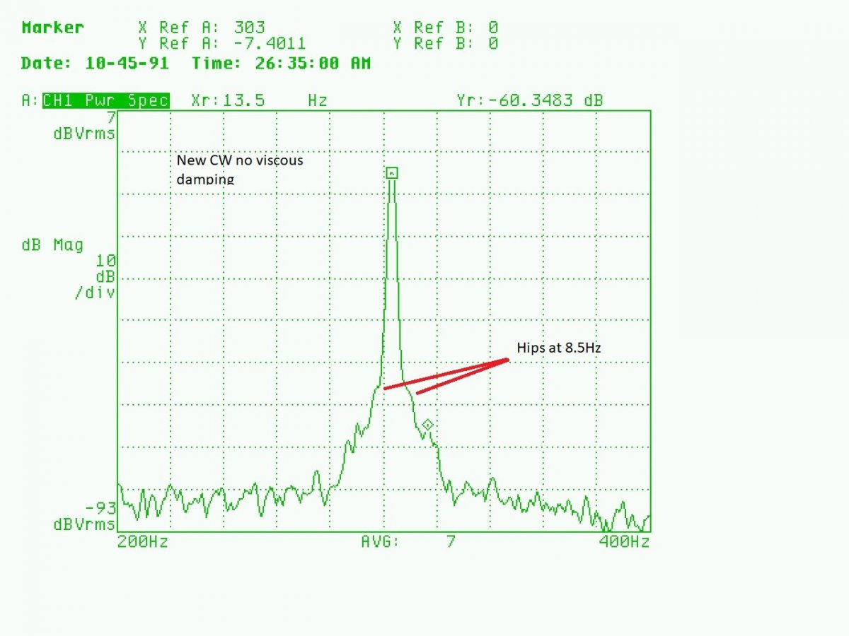

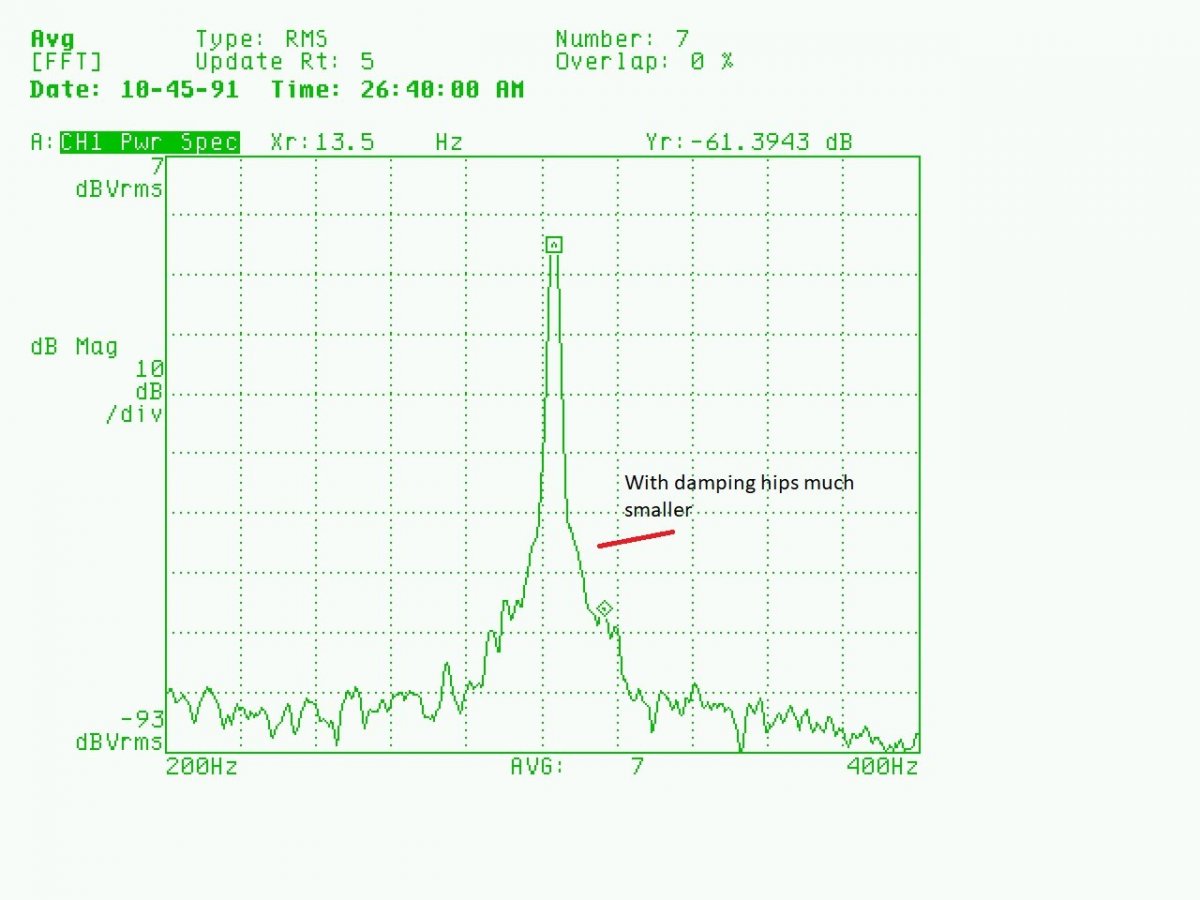

In an arm that is not totally inert viscous damping improves the situation.
Here are plots of 300Hz tone with and without damping on my EPA-100. Even though the visual improvement is small the sonic improvement was clearly audible.
I also found adding too much damping made the sidebands worse than no damping. My viscous damping is adjustable, an M3 bolt into the trough can be adjusted for more or less damping.
